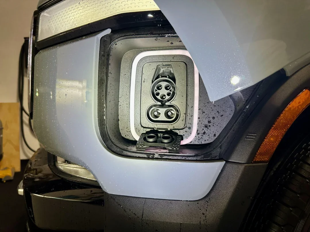

Just to verify - you have a 2025 Rivian R1S, correct? WIth a charge port that look like this:
Rivian R1T R1S NACS to J1772 Adapter Recommendations 1768113072105-3h

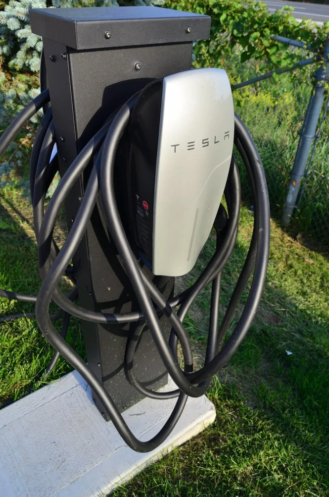

And you parked at a Tesla Destination Charger that looks like this:
Rivian R1T R1S NACS to J1772 Adapter Recommendations 1768113137684-k4

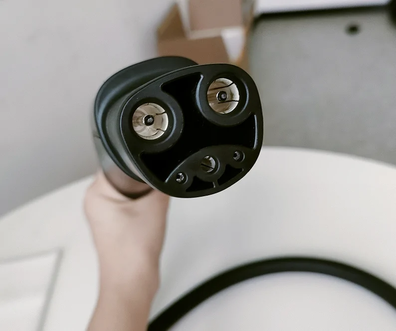

What did the end of the Destination Charger look like? 99% of all Destination Chargers have a "Tesla/NACS" plug:
Rivian R1T R1S NACS to J1772 Adapter Recommendations 1768113209572-1s

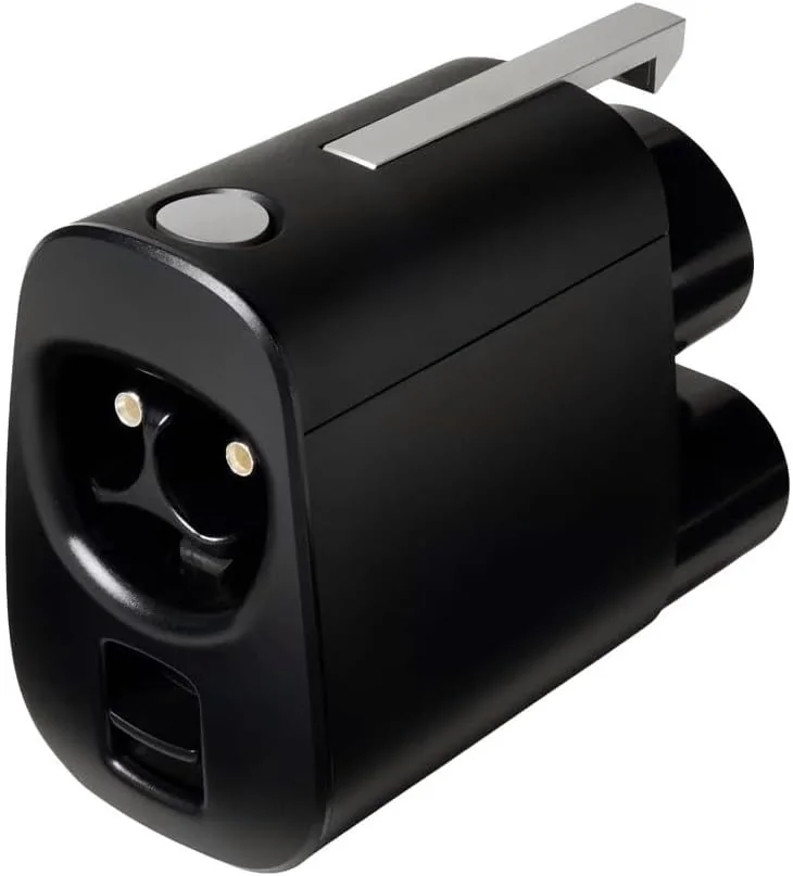

That plug won't plug into a 2025 R1S. Were you plugging in your CCS->NACS adapter?
Rivian R1T R1S NACS to J1772 Adapter Recommendations 1768113268509-z4
Because that adapter only works on (some) Superchargers. See the notes from other people about adapters that work for Destination charging.

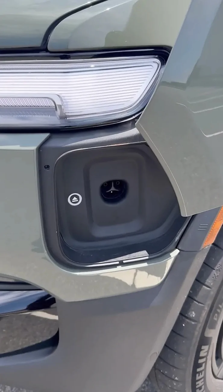

If, on the other hand, your Rivian's charge port looks like this:
Rivian R1T R1S NACS to J1772 Adapter Recommendations 1768113350568-zv
Then you have a 2026 Rivian, and the Destination Charger should work without an adapter.
