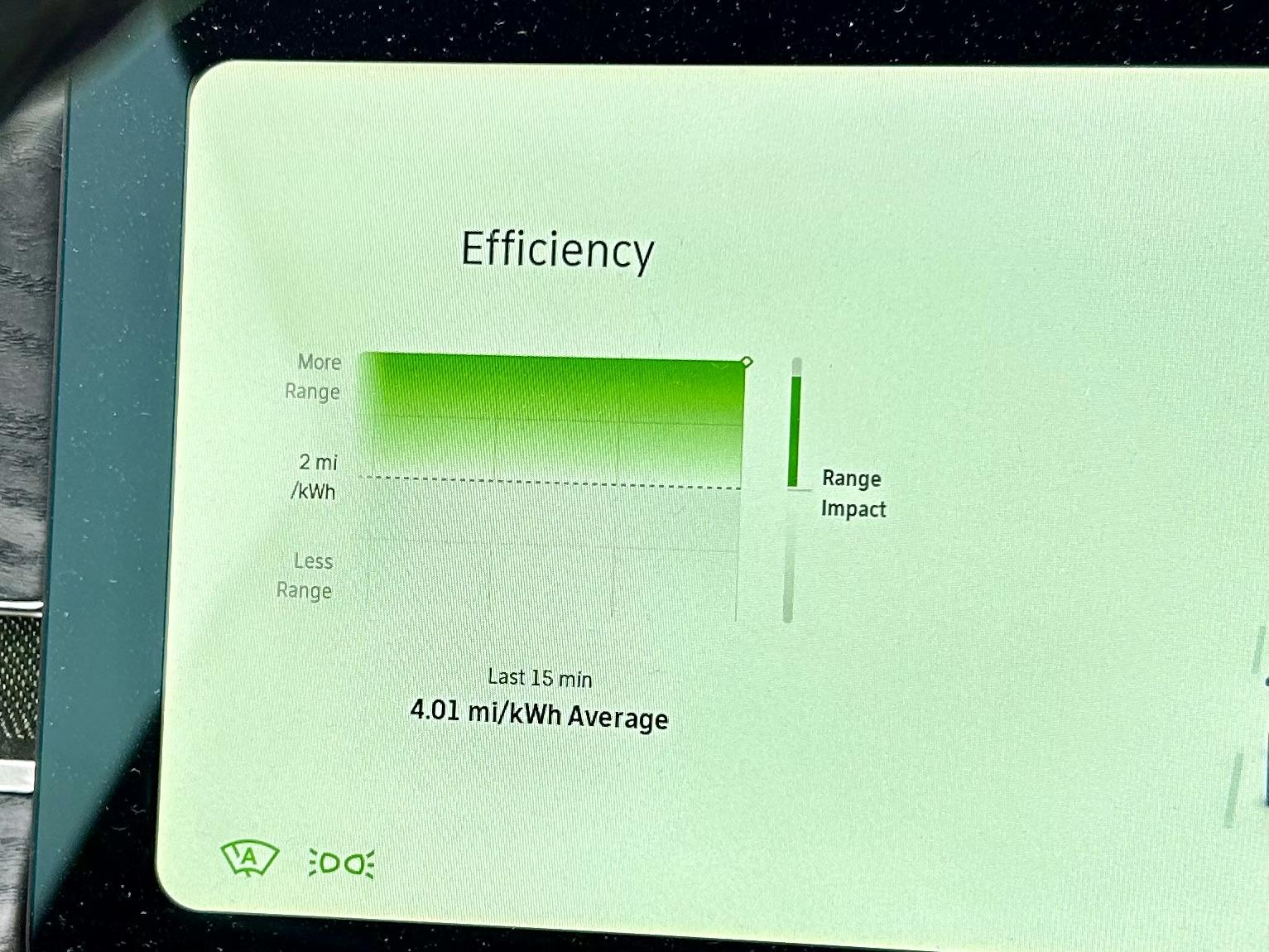

Just did my first Meadows run. Finally. I live near Ida B/Wilson HS. Took 84 to Wood Village. Then 26. Had a fatcat evo 6 rack with skis. Left home at 95%. Arrived with 148 miles all purpose range left. Got home with just under 30% left. No charging. 65 mph on the way out. A little quicker home.
Lots of room for activities in the back.
Love that downhill efficiency. ?
