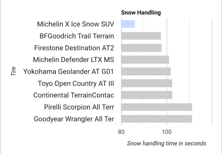

I discovered just how bad the factory ATs are today- I had my first winter storm drive up the mountain to ski on my new Nokian Hakka LT3 20” snow tires and they are night and day better than the ATs! I highly recommend adding a pair of winter tires if you’ll be spending a lot of time on snow.
You should add new tires to your list of things you can do without hindering your ability to ski.
Road tires(or snow tires) will get you better snow traction than the factory 20" tires in addition to having better range.
Pirelli's all-terrain tires are really bad in the snow.
https://www.tire-reviews.com/Article/2023-Best-All-Terrain-Tires-In-Snow.htm

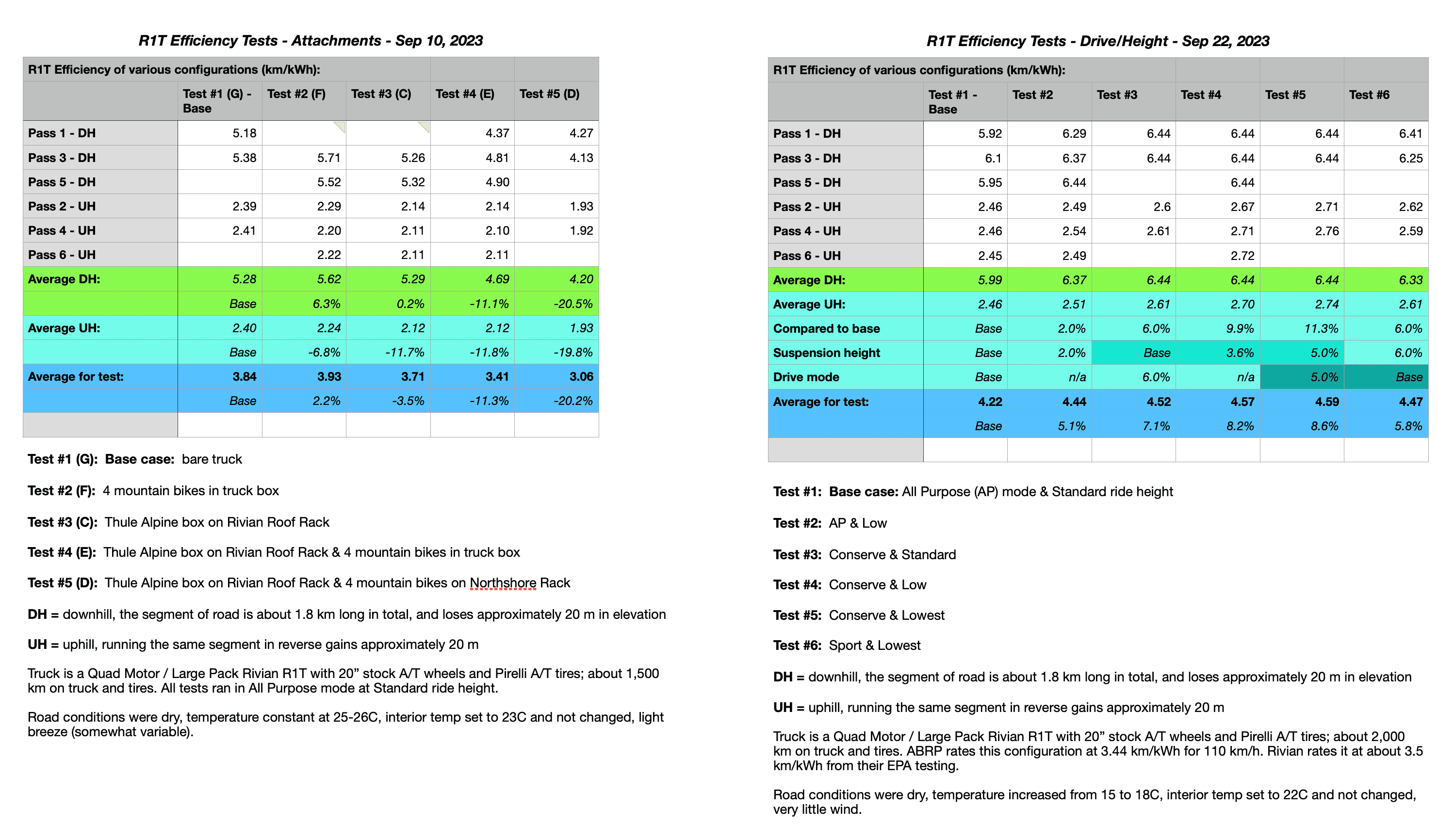

I run a Thule Motion Alpine on my R1T and did some controlled testing - it was about a 10% hit in the early fall when it was warm out at ~70mph (110 Canadian mph), I'm guessing it is closer to 12 or even 15% now in colder/denser air. If you go slower, it will be less of an impact by %, and if faster, worse.
As an aside, like another poster, I swapped to Nokian LT3 studded tires. Again in a controlled test, found that they have no measurable hit to efficiency as compared to the 20" Pirelli's.
My general advice would be to:
  • slow down by 5 mph next time and see how much difference that makes
  • charge to 100%; in the winter it isn't a big deal; you just don't want to leave it for a few days in summer heat like that
  • I agree you should try the box in different positions and do a controlled test (see my post here for method; I've done the same thing in my R1T now but haven't posted results yet on my blog; see screenshot below though for the table without a lot of context). I suspect a fairing won't really be noticeable, but I've never tested one directly. (I really wanted to mount my ski pod over my truck box, but it wouldn't fit)
  • Draft a bit on the freeway if the headwind through the Gorge is particularly bad
  • Run Conserve on the bare pavement (look at screenshot below, makes the singled biggest difference). I've been getting up to speed, then switching to Conserve (ie I avoid heavy acceleration/deceleration in Conserve to save wear on the front tires).
  • I'm still undecided on running suspension in Low; I don't want to adversely wear my tires so I leave it in Standard for the most part; however, when I really want to stretch range I run Conserve Low - it probably won't affect the tire wear that much.
Rivian R1T R1S Need more range for skiing R1T efficiency tests
Note: the right hand table has some problems in that the DH section caused me to 'pin' the efficiency meter, skewing the averages in blue. Look at the values in cyan. The shaded ones match up for comparisons (e.g. for Drive Mode, Test 5 and 6 were run in Lowest and compared Sport to Conserve; ie Conserve is 5% more efficient than Sport in Lowest; and 6% more than All Purpose in Standard Height).
