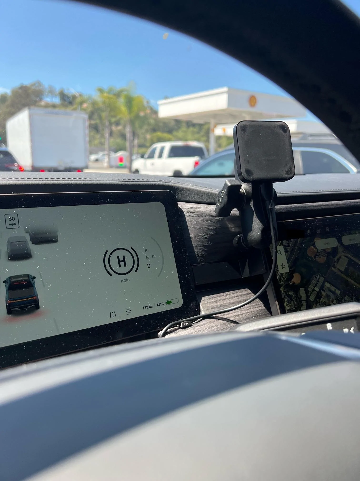

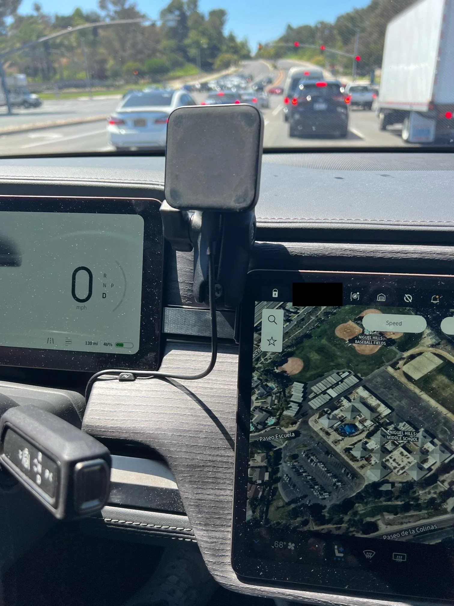

Where are you running that pwr cord to? Also what is that cable clip?
The under dash 12v and it’s the included clips from the peak design 1in ball charger
Yea thats what I figured. I don't have that. Gonna have to run it via OBD II adapter
