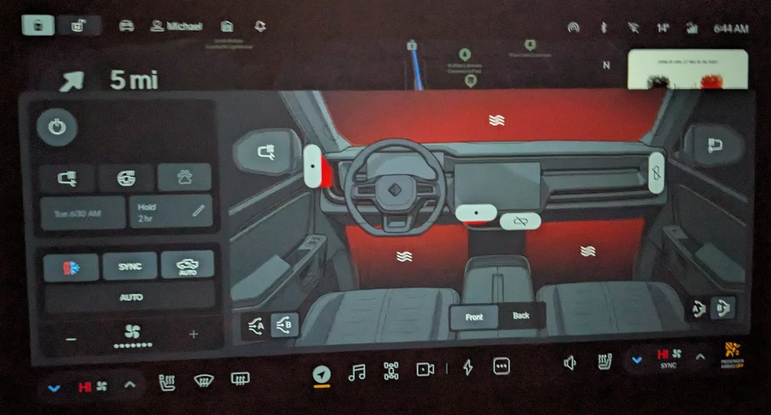

Well, it did it again yesterday.
Pretty convinced it's a software bug when driving at speed and below 20degF. Was headed to go snowboarding yesterday afternoon. Have a relatively short stint on an expressway. About 3-5min after setting the cruise to 70, the truck starts blowing cold air. I watched the app this time, and the cabin got down to 59degF according to the app while continuing to actively blow cold air.
Here are the dash settings (rear was set to both console and floor vents on, no picture though).
