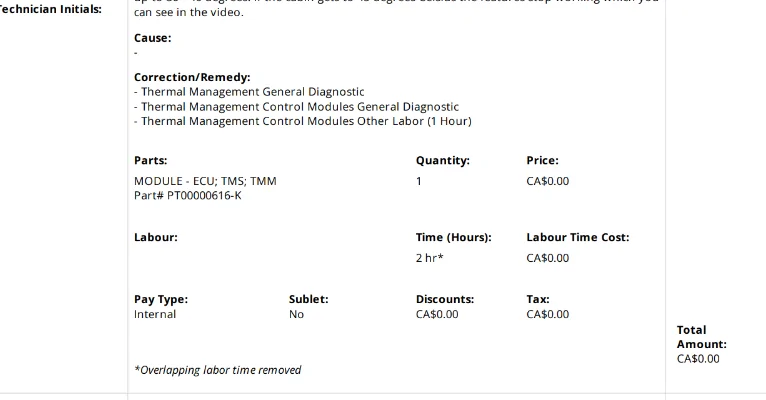

I thought mine would be related to the sensors as well, although the service center quickly ruled that out as they said that faulty sensors are usually very easy to diagnose. I think I got the "TCM" acronym wrong on my previous post. This is what was done:

I can say that I've never experienced that issue since having that module replaced. Hopefully you get a permanent fix without too much trouble.

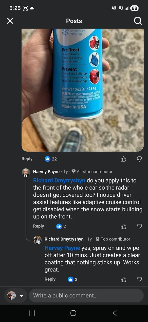

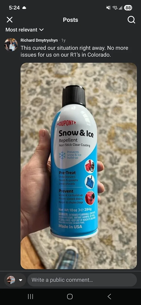

Looked around and this is from a Facebook post a year ago. Did some digging, and it is a solid solution that will break down in the environment over time unlike pfas etc. If it worked in Colorado, fingers crossed it works in the PNW and it's wet heavy snow.
Rivian R1T R1S No heat while driving, heat while sitting - G1 R1T Screenshot_20251210_052449_Facebook
Rivian R1T R1S No heat while driving, heat while sitting - G1 R1T Screenshot_20251210_052509_Facebook

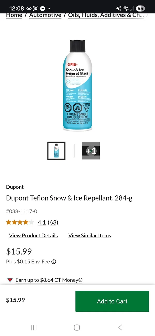

I'm picking some up today from the local Canadian Tire eh! But I won't see snow until I head out of Vancouver and up into the mountains this weekend.
