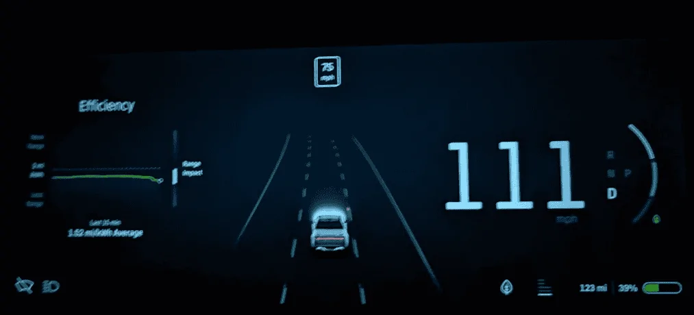

You must have a serious lead foot. I drive (most of the time) like I'm constantly stealing it, and even I have been getting more than that prior to my range ticking upwards this last week of more reasonable driving :D
I found out on my last excursion that there's actually a nice option for regular cruise control. It involves just keeping the pedal all the way down. Worked fine in conserve mode for the couple minutes I tested it.
