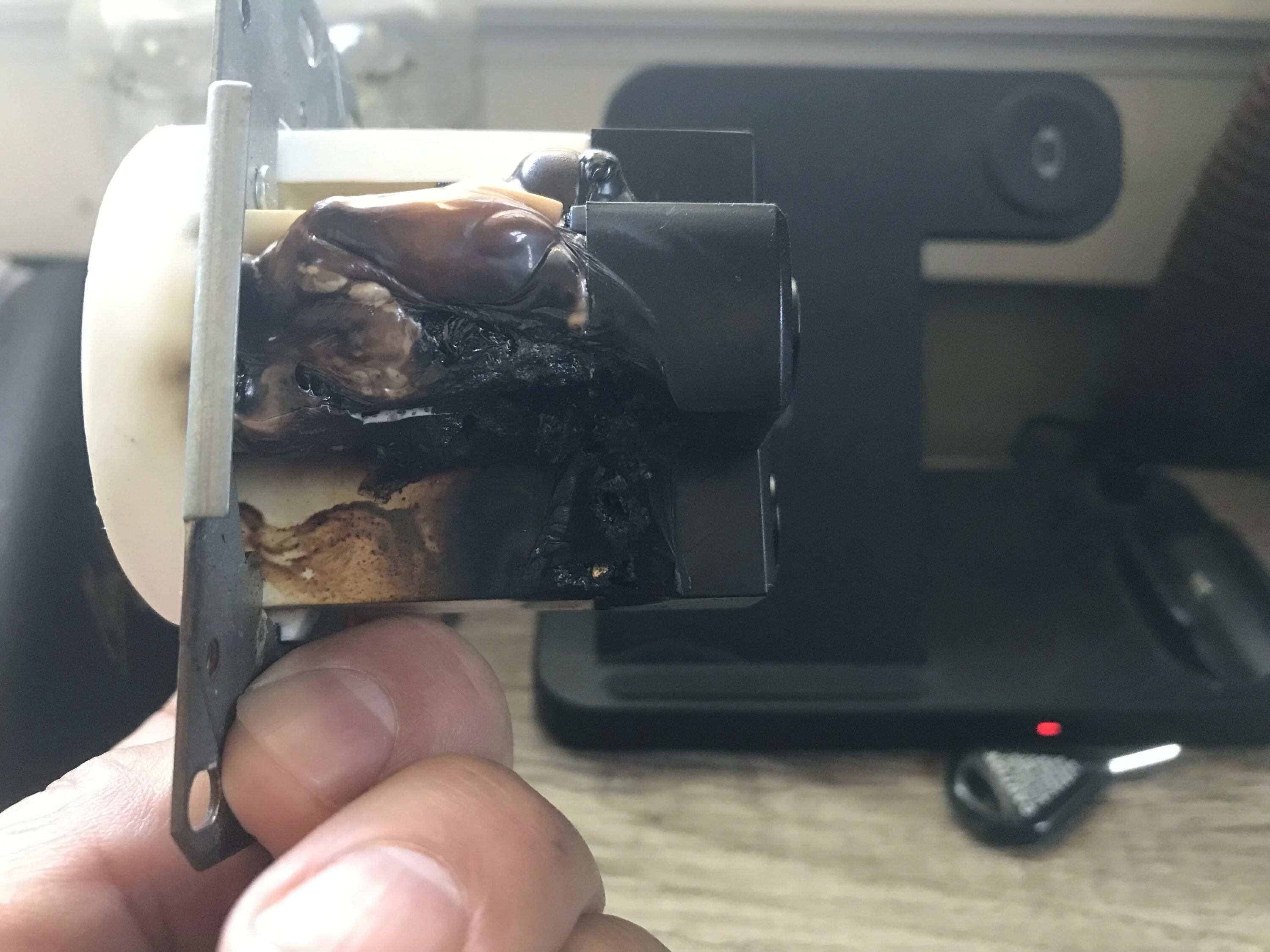

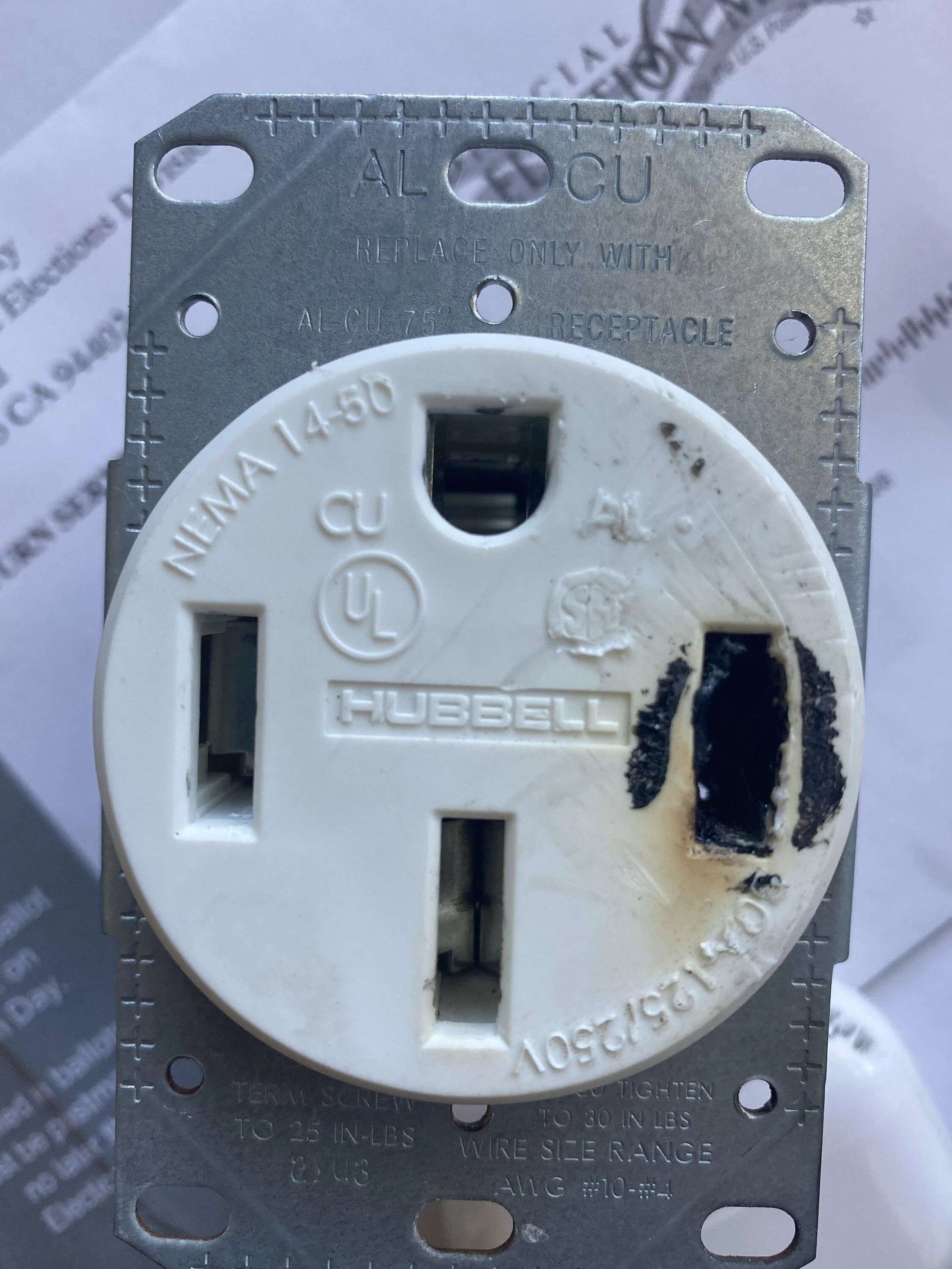

The only advice I can give is if you go with a NEMA 14-50, get a commercial / industrial version which is rated for constant use. Not a Home Depot special for $20. It’ll melt.
Check your local codes. 48A continuous use, distance, etc will modify how you wire it. I’d go with 4gauge personally. It’s overkill in the safest possible way.
