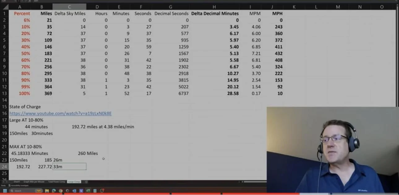

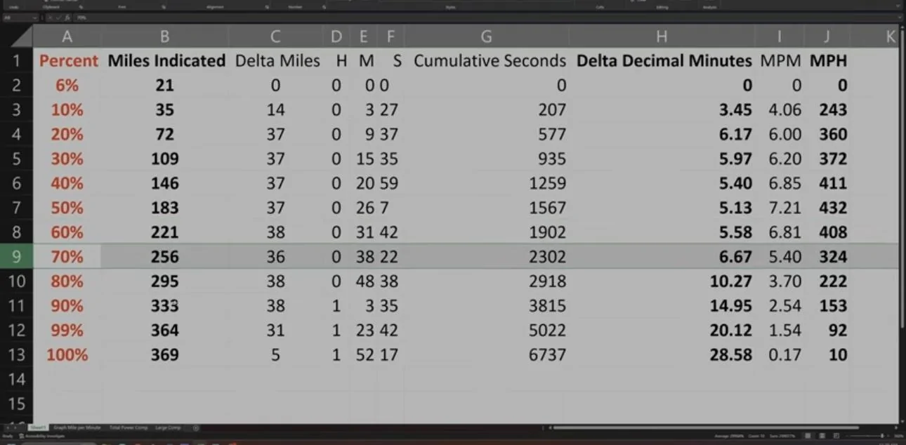

This is a much better video on charging curve of max pack:
According to this video: from 10% state of charge, max pack accumulates 192 miles of more range 11 minutes faster than a large pack.
(As said earlier, 15 min of charging time is insufficient to determine anything)
The problem (other than not having his truck set to show kw...) Is he's going off rated miles. The max pack is rated to be more efficient, but both Rivian and the OOS video both say it's the same efficiency at highway speeds.
The 10% challenge isn't OOS's charge curve video, which I suspect we will see soon. It does highlight that the R1S vehicles would benefit from a higher charging rate (e.g. 300kw+) to be more competitive with range gained over ~15 minutes of charging. The max pack doesn't seem to solve that in any way.

My bigger point is that this specific OOS video was pretty much useless for uncovering unknown info. We knew from the EPA docs that the highway efficiency of the two batteries on same motors were about the same.
