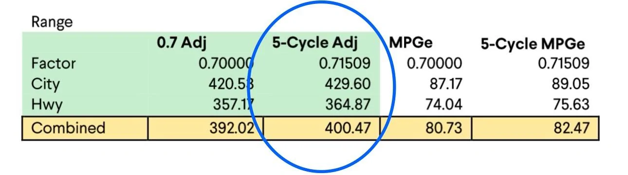

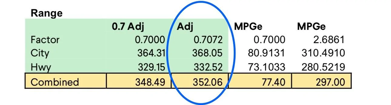

As mentioned before in a different thread. Max pack gets a lot more miles at city speeds. Highway range is somewhat improved, simply from more kWh in the battery.
