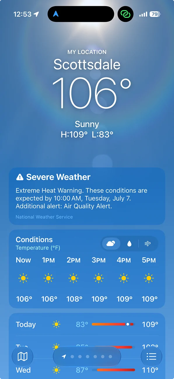

Sooo...did you do a full reset/reboot and the vent calibration...?
Here's my situation today, it's on auto at 73 and doing fine...

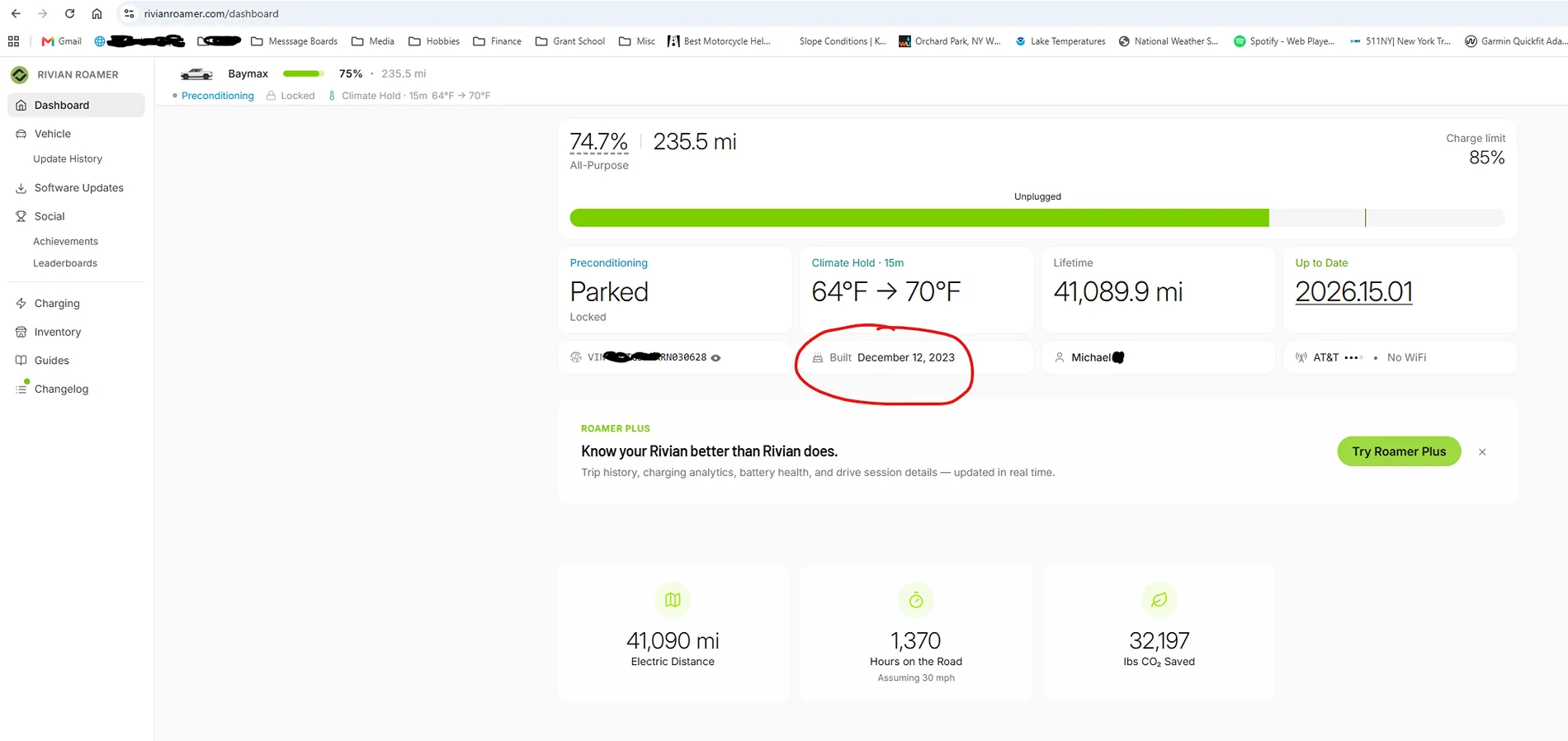

Mine is fairly early made, VIN is just over 10k. Don't know how to tell the made/delivered times.
Rivian Roamer has my build date. I think it's in the door jamb as well. Mine is VIN 30628, so not too far "behind" yours
Like this:

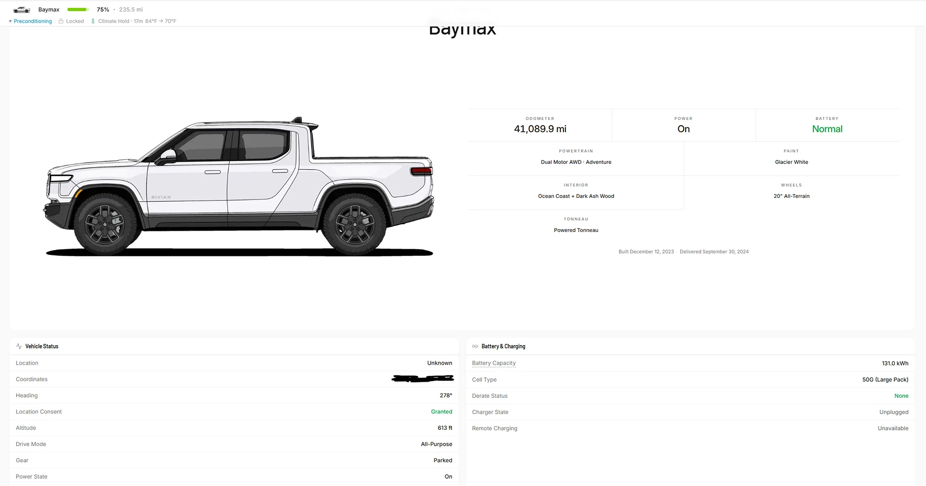

*EDIT*
This is fun. It thinks it's preconditioning. Wonder if that has something to do with it.
Also this screen shows build and delivery dates.
