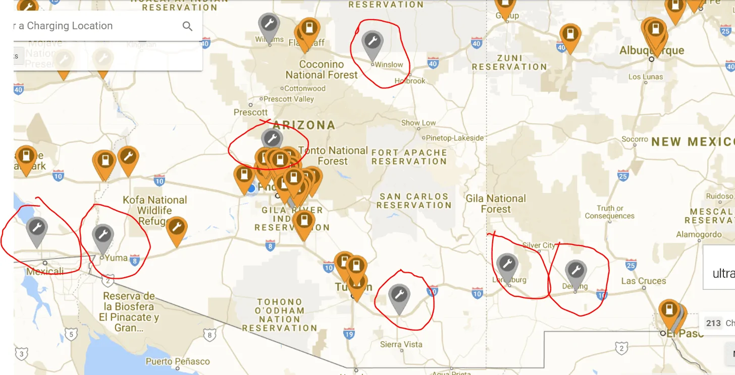

EA has done it again, they have put several sites Under Repair, all at once. Phoenix to San Diego is out and Phoenix to El Paso is out. All of these circled sites are listed as Under Repair on Plugshare, the other ones are sites under construction.
