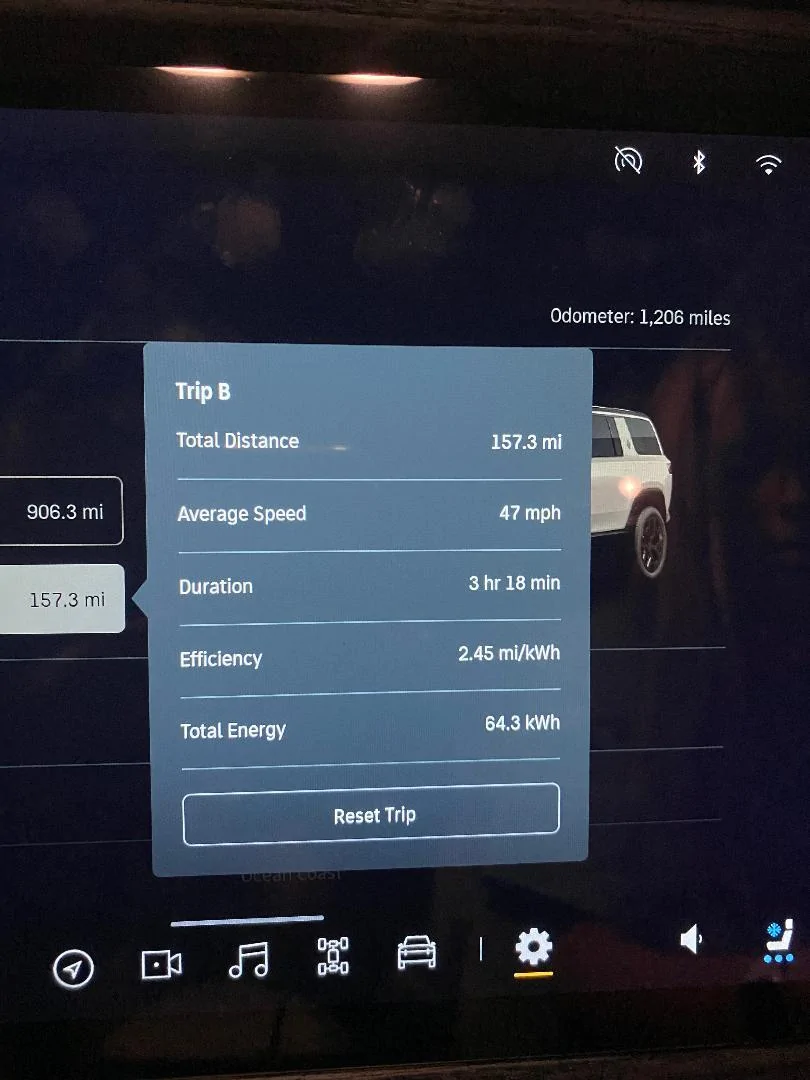

As another data point, I took my first somewhat lengthy trip tonight. I did ATX-Houston (The Woodlands), about 160 miles, and managed 2.45 mi/kwh, on 22" wheels and AC going the whole way. This was in the evening, so only about 90F with no strong sunlight. I did the whole thing in conserve mode, and spent about 25 minutes sitting unmoving in a drive-through line at Whataburger, which likely messed with the speed average. Anyway, I ordinarily drive only fairly short trips around the city, 10-20 miles max, in AP mode and 100-105+ degree heat, where my average efficiency is usually about 1.8 total, so I was pretty excited to get it to exceed 2.4. Arrived with 160 miles left in the battery on conserve mode, so that rounds out to just about 320 total for the 22" wheels.

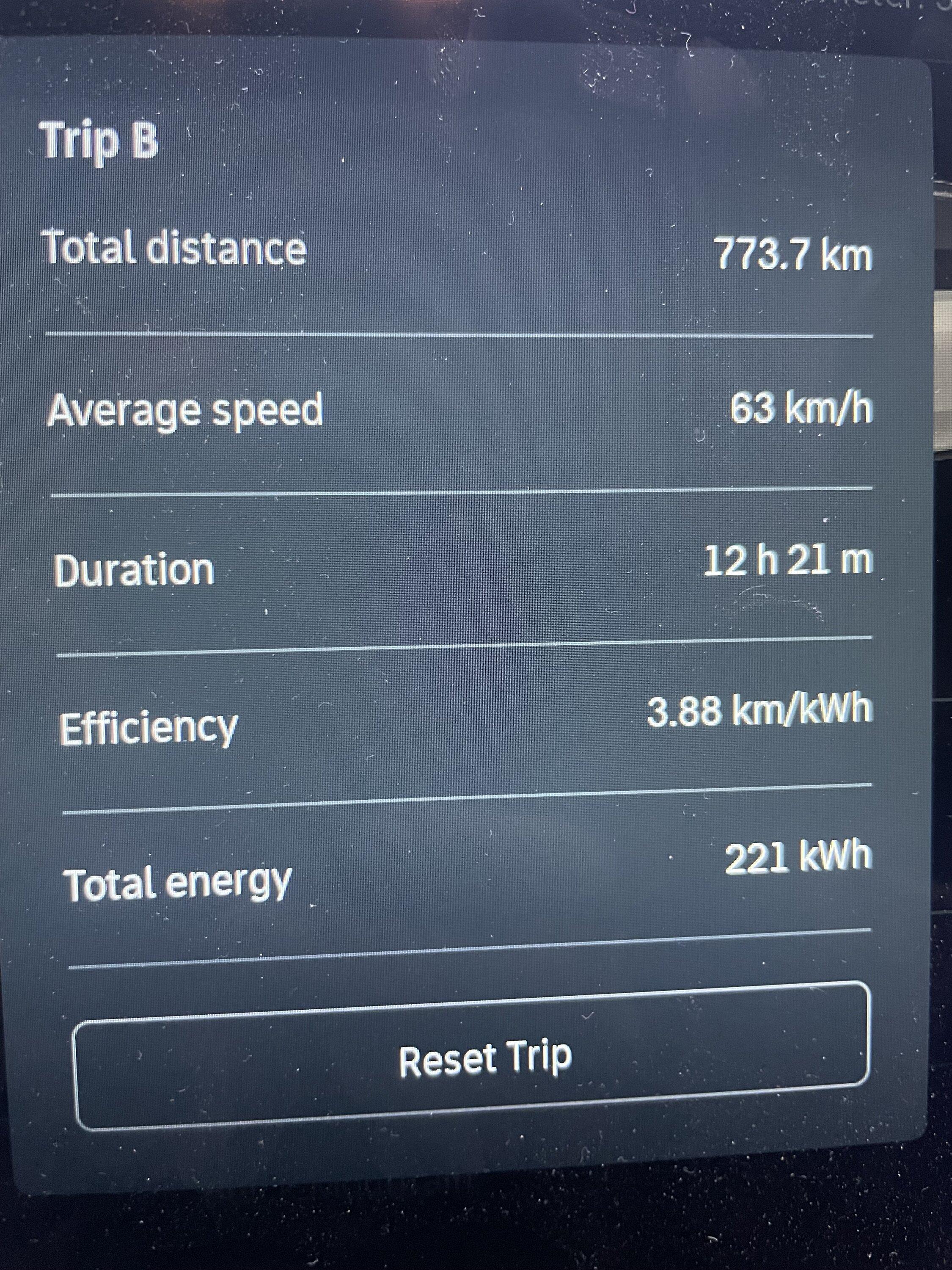

Currently on my trip meter I achieved 3.88km/kw (2.41m/kw) This is with R1S quad on 20" AT with a 500km (310mile) return trip in conserve over a mtn pass (10,000 ft total gain/loss) and some local driving that involves a 850' climb/descent every time I leave home, 10% of the time was towing a very small cargo trailer.This was generally not going more than 5% over speed limit.
That puts me at 310-325miles (129 /135kwh) which is way over EPA so pretty satisfied with that.

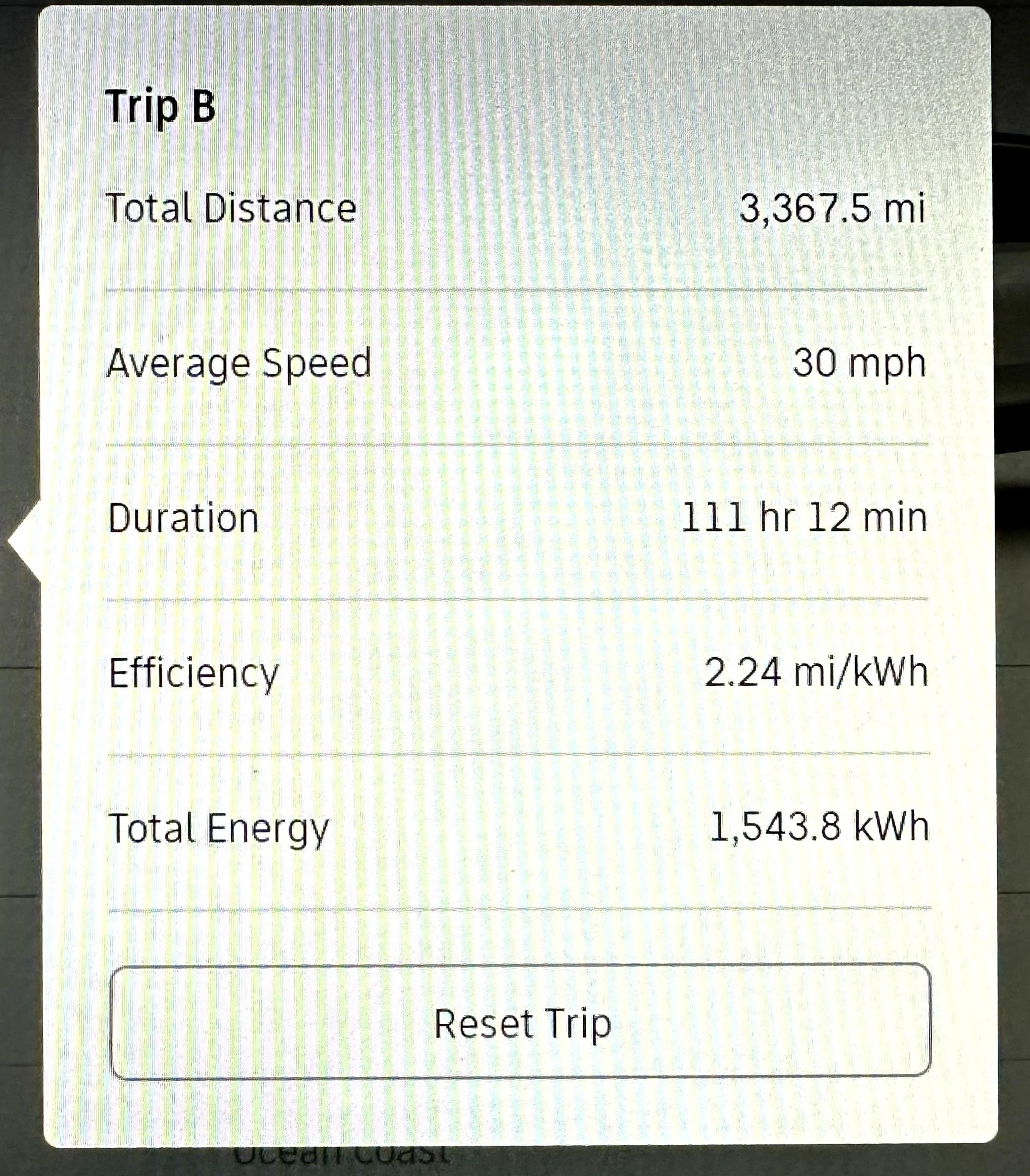

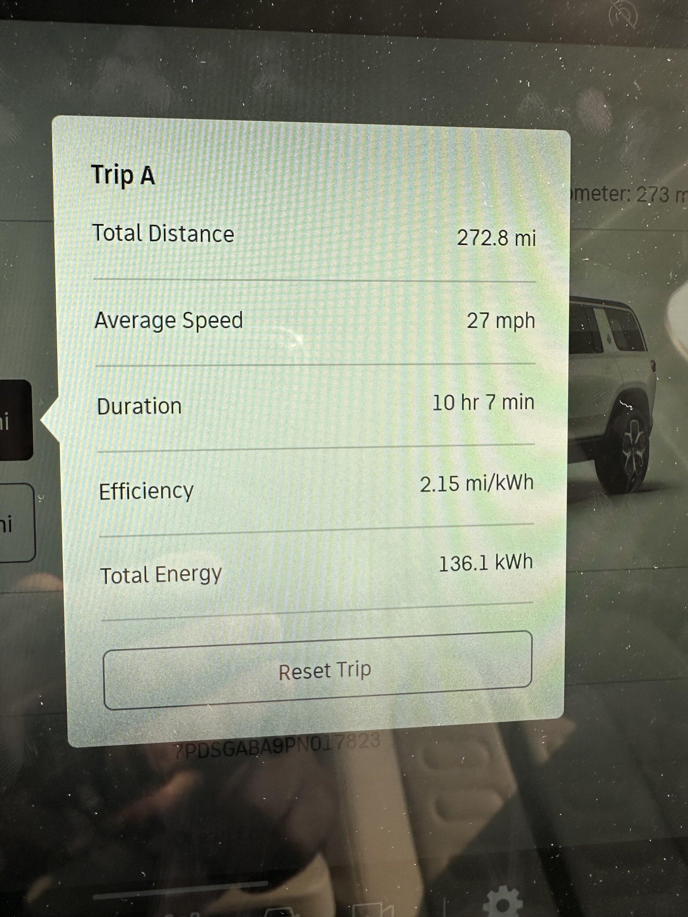

I'm in inland No Cal (Sacromento area) blasting the AC and never have cycled AC on/off (but now sure will, Thanks for this gem). I hardly ever apply the brakes on the back roads here as a costing stop usually works. Using $.40 KW as an average price (peak here is $.50!) this makes the cost of power around 5.7 cents per mile. Comparing to a 50 MPG Hybrid the cost for fifty miles would be $2.85 vs about $5.00 for gas here. Yes my KW cost cited here is high and likely is lower making for better MPG yield. The Rivian software rounds down so actual SR1 cost per mile is a bit less.
For powering the 3.5 ton beast to me this is more than Aok. My quad SR1 is in All-Purpose mode all the time w/21" road tires. The aero covers are off but for those of you caring about this stuff that matters and I wonder of these reports how many are using the aero covers? My 3367 miles would be around 3485 using a multiple of 1.035. I turn off cooling/heating system when parked and lock at home to avoid waking up every time I pass by many times a day that saves on some battery drain.
