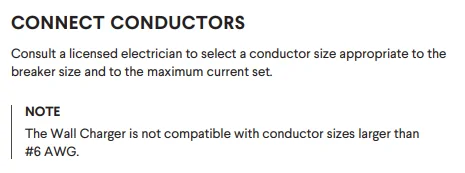

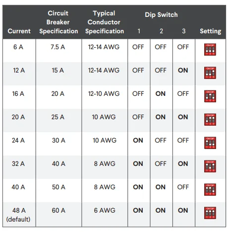

I can't argue with the manual, but no way I'm using #6 for continuous current draw @ 48A. The heat buildup over 4+ hours is a hazard.
A #6 AWG wire can typically handle a maximum continuous current of 55 amps. However, this can vary based on the type of insulation, length of the wire, and the environment in which it is installed. For example, a #6 AWG THHN wire can handle 105 amps. A #6 wire with a 75-degree C insulation can be protected by a 60-amp breaker. When considering long-term usage, an 80% load factor should be applied, meaning a #6 AWG wire can safely carry 44 amps over a long period.
Properly installed, it's not a hazard at all. That's what NEC is all about - specifications that include a safety factor. Don't be a fearmonger.

6AWG in conduit properly installed Is ok for 48A on a 60 breaker. 6 AWG Romex is not and is derated due to heat considerations. I had wanted to run 4AWG and put this all to bed and future proof, but the connector block in the Rivian charger is specked for 6 AWG although I am told the 4 will fit.
My supplier had 6-3 AWG XHHW 2 already in flexible metal conduit. It meets code and I found this much easier to run than assembling/pulling wires in hard metal conduit.
While I can peak charge at 48 Amps and I enjoyed planning the (hardwired) setup 99.9% of the time I charge at 20 A. Either way the S is charged in the morning.

I did that when we ordered our R1T - had an electrician wire an outlet into our garage's service panel. I printed down the Rivian charger specs and gave that to him.
50amp breaker to the proper NEMA receptacle.
This is a small nuance, but it's relevant since the guide doesn't specify the conditions where #6 doesn't actually pass muster for a 60A circuit. When I was first learning about EVSE installation, I found this pretty confusing since I thought wire is wire. What's worse is that the code says that #6 THHN is good for 60A, and that's actually what's inside the NM (Romex) outer jacket!
Yes, it was somewhat unclear, but conduit apparently allows more heat dissipation than Romex, when installed in the correct size conduit.
That's because the outer jacket of Romex tightly and thermally couples the individual conductors and also traps heat in the overall bundle. Individual THHN conductors in a properly size conduit (per NEC max cross sectional area fill of 40% with three or more conductors) have room to dissipate heat inside the conduit and through the conduit wall. NEC specifies all of this to provide a time tested safety margin against bad things happening. Just because you could force 6 wires in a conduit doesn't mean you can and meet code. Conduit fll calcs are mandatory to meet code.
