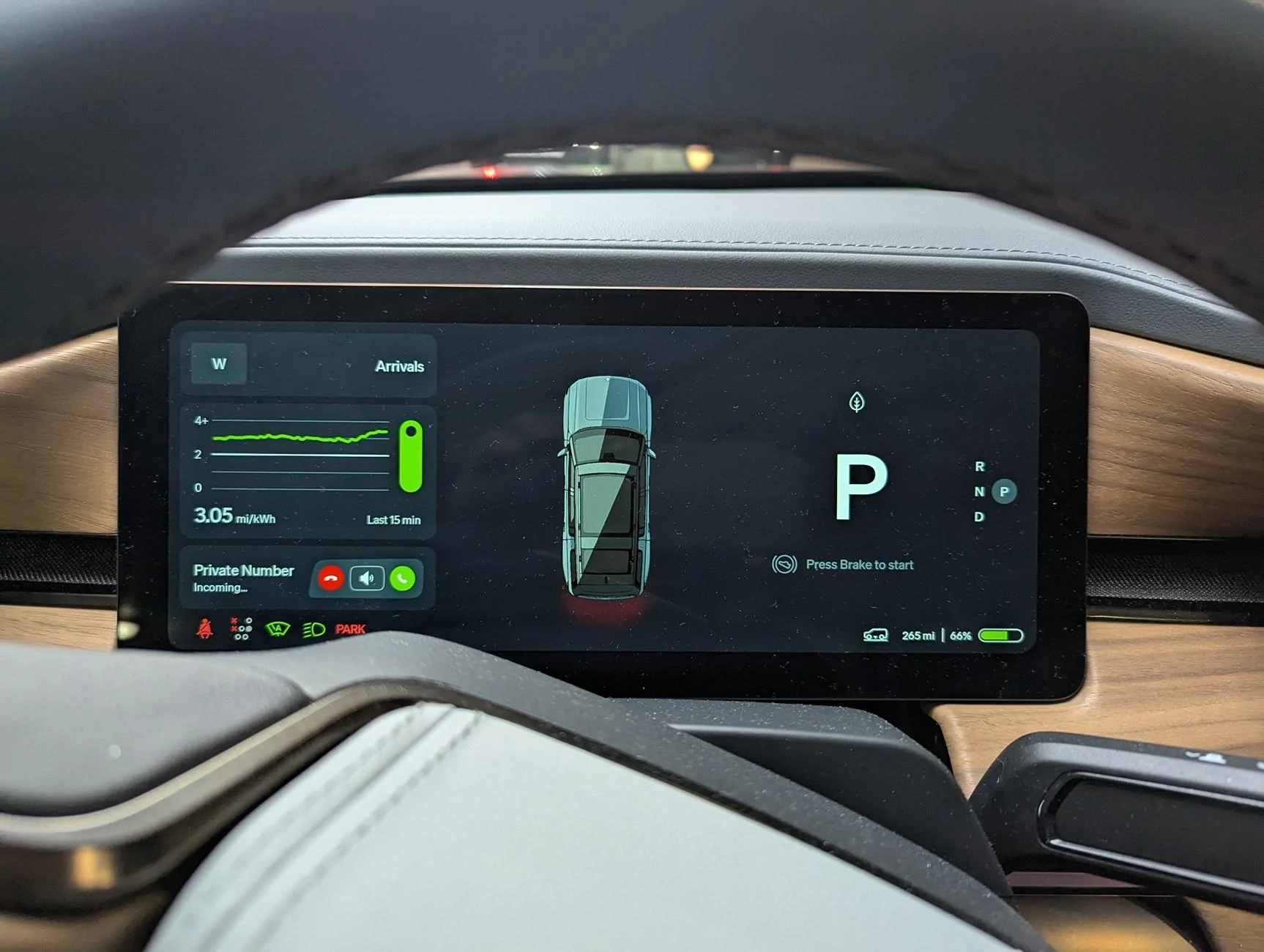

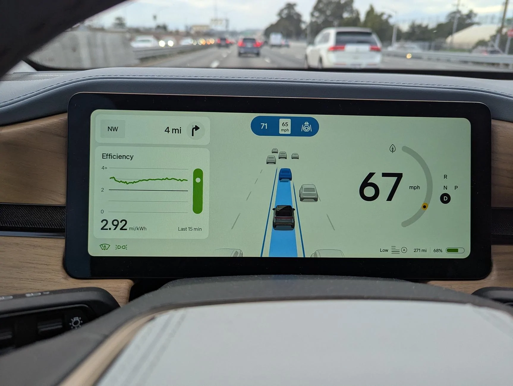

I'm curious where you're seeing that the 371 number is a blended drive mode number? Your other post has a transcript that never says they used a blended drive mode.
I find that I can get pretty close to 400 in conserve mode on my R1S Tri when I'm using highway assist on at modest speeds. Here's a couple different pictures of actual efficiency from driving on 101 (pretty flat) in the Bay Area during rush hour.
I do agree the 371 number is misleading as the vehicle predicted range is 346-350 in AP in my experience with normal driving. That being said, I think it's plausible to hit the 371 EPA range in AP mode under very controlled driving conditions.

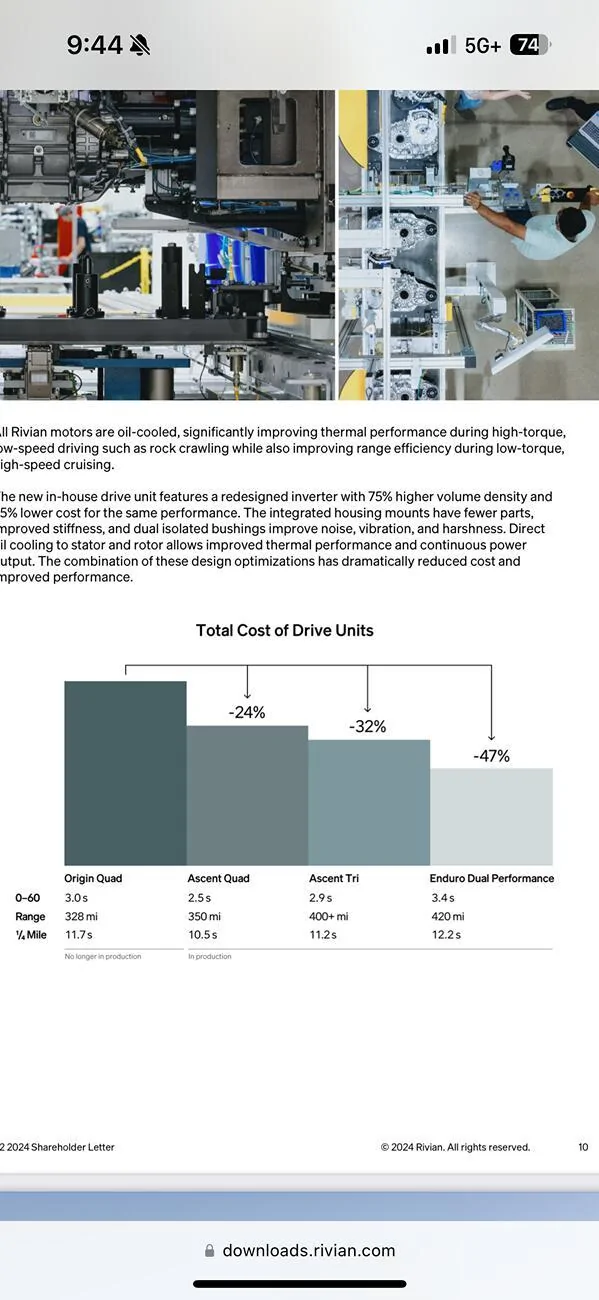

Did no one read the shareholder letter? It’s been out since summer 2024. Gen 2 quad is estimated 350miles of range.
I did :) - And the reality will be less than this. They never got to 400+ for the tri motor (needing to create their own test cycle to say they did) and that's *in* conserve mode, where the Ascent motors are only used for acceleration.

Odd that the pictures you post show conserve mode in use whist talking about AP?
Perhaps I should actually start a blog or something for this :) So rivian just cannot get their story straight on this - there is 0 evidence anywhere to back up the implication that RJ made in that interview with Sandy, but plenty that contradicts it. Note that 371 miles is the midpoint of what rivian submitted to the EPA, and if you read the fuel-economy label that @Electrified Outdoors posted above - the MPGe figures for highway and city correspond to the EPA test cycle MPGe figures for AP and Conserve mode. Note that Rivian's math is all over the place - I honestly think driven by feeling the need to hit numbers that match what they published in documents like the investor report, before they had real world data.

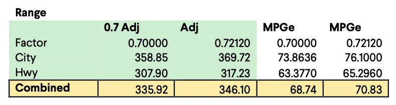

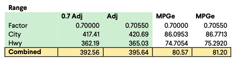

The original Rivian submission to the EPA indicates:
  • AP: 346.10 miles
  • Conserve: 395.64 miles
  • AP: 346.10 miles
I specifically called out conserve in reference to the pictures.
I find it odd that I show evidence of the 400 mile range being achievable in real world conditions and then you just make this claim with no evidence.
