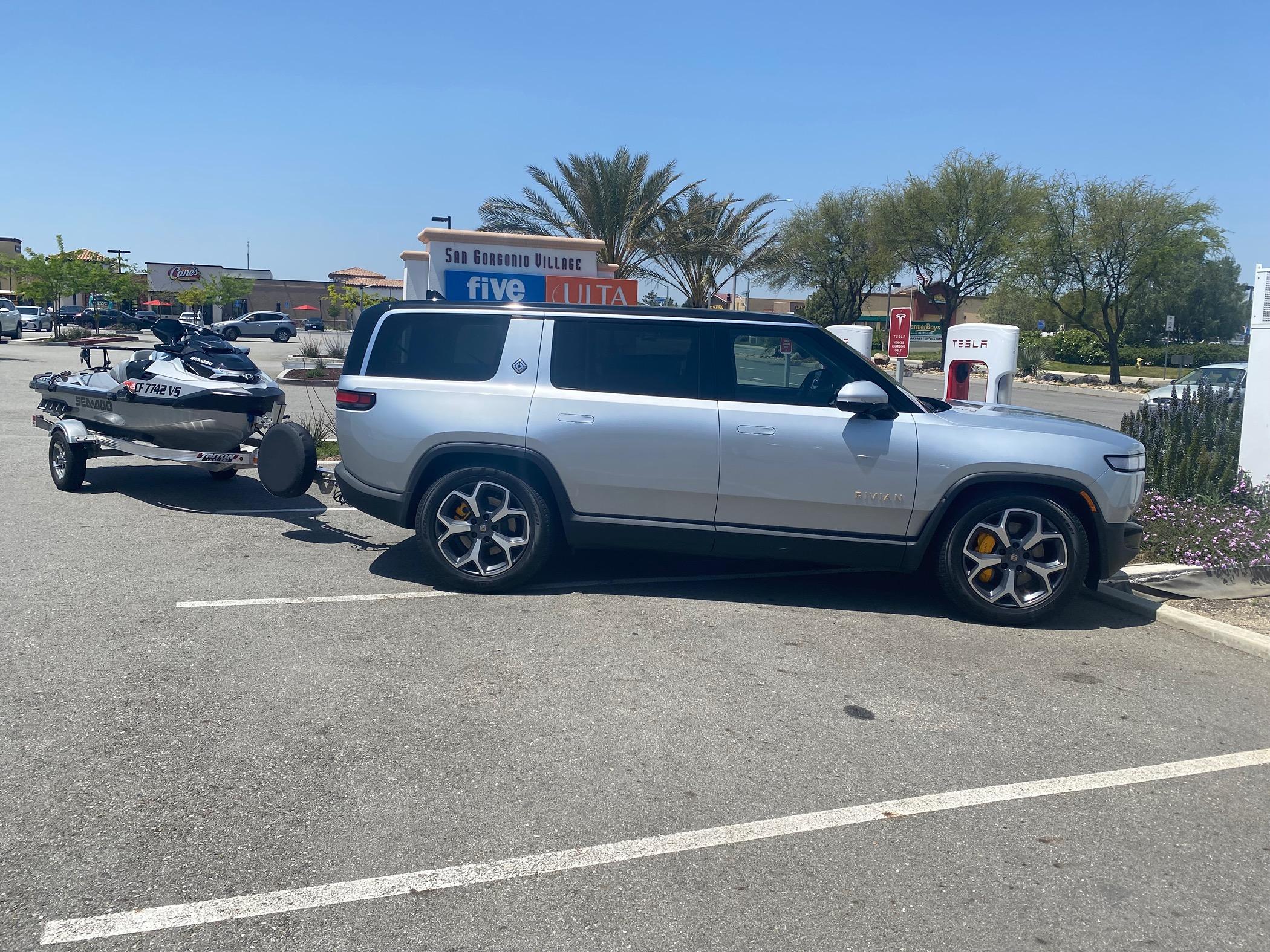

I tow my Sea-Doo all over California, Nevada, and Arizona. Without the ski I get about 2.3 - 2.5 miles per kilowatt hour on my ‘23 quad large, with the Sea-Doo I get about 1.8 to 2.1, depending how fast I drive. Long sections of freeway and even put it in conserve mode which also really helps. To use conserve mode, assuming you have a quad motor with conserve mode option, when you plug in your trailer, if you quickly go back inside the car, on the screen, it asks if you want to switch to trailer mode, or you can hit “Not a trailer”. If you choose the letter, conserve mode is still available however, none of the other ADA functions are. As usual, the car will guide you to chargers as needed.
Thx. Love the photo and this exact set up I have. So it looks like an average of 20% drop in range. Not too bad. Thx you!!
