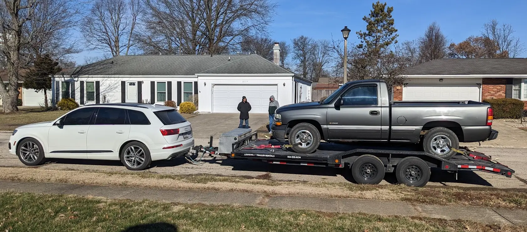

Here's my Q7 pulling a rented trailer with a project truck on it:
Rivian R1T R1S Seeking advice for towing a car 1775070746385-o
That trailer had 3,500lb axles with electric brakes on both axles. The tie downs allowed me to properly position the truck on the trailer to get tongue weight balanced properly. I think it cost $500 to rent it for the weekend.
Your Rivian will handle this type of load just fine without a WDH. Electric brakes are significantly safer than surge brakes, and the higher quality trailer will make towing a significantly more pleasant experience than that UHaul POS.

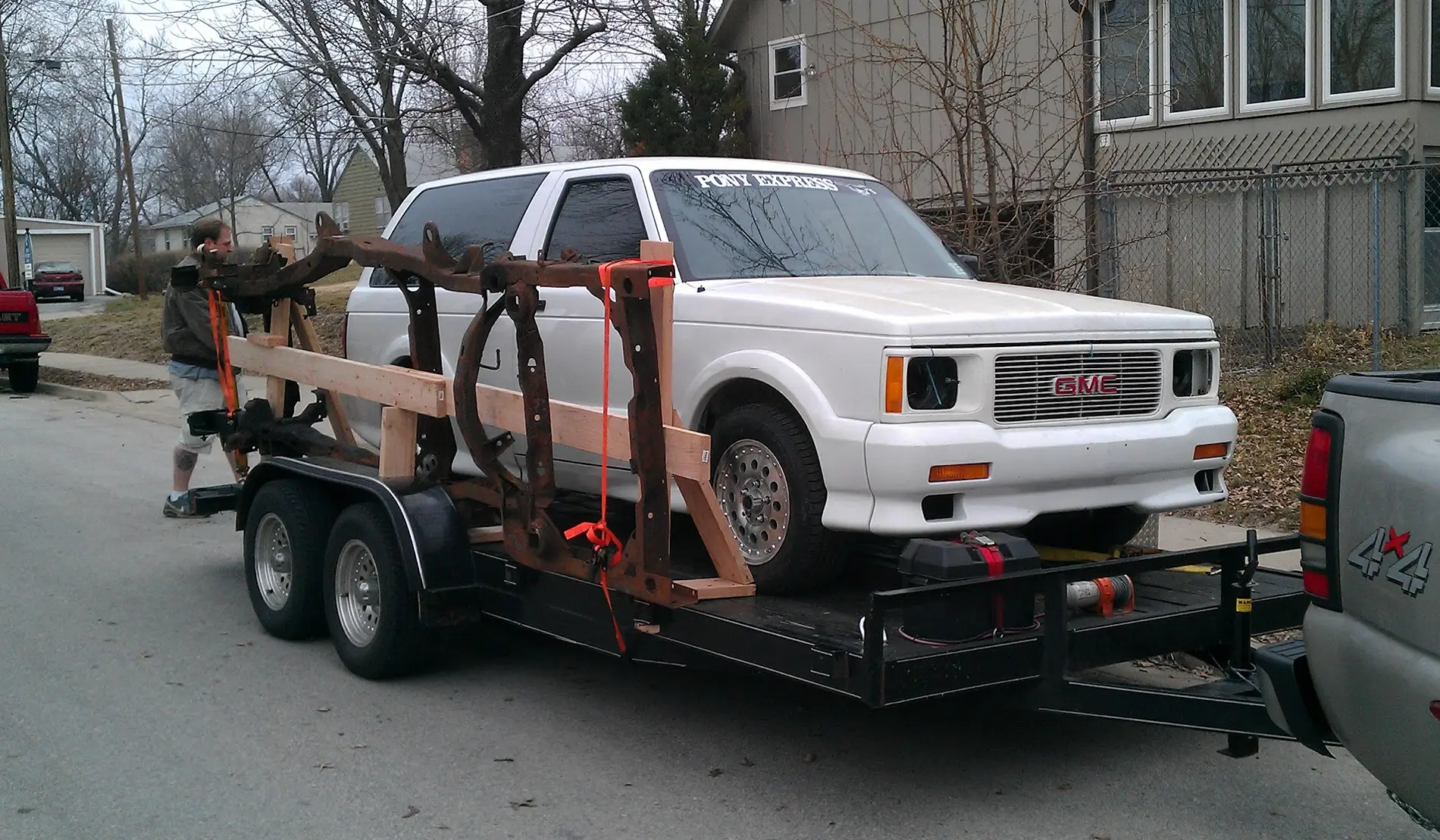

Just for funsies, this is how we brought a Typhoon home with a spare frame for another project. Got a lot of interesting looks on that trip.
