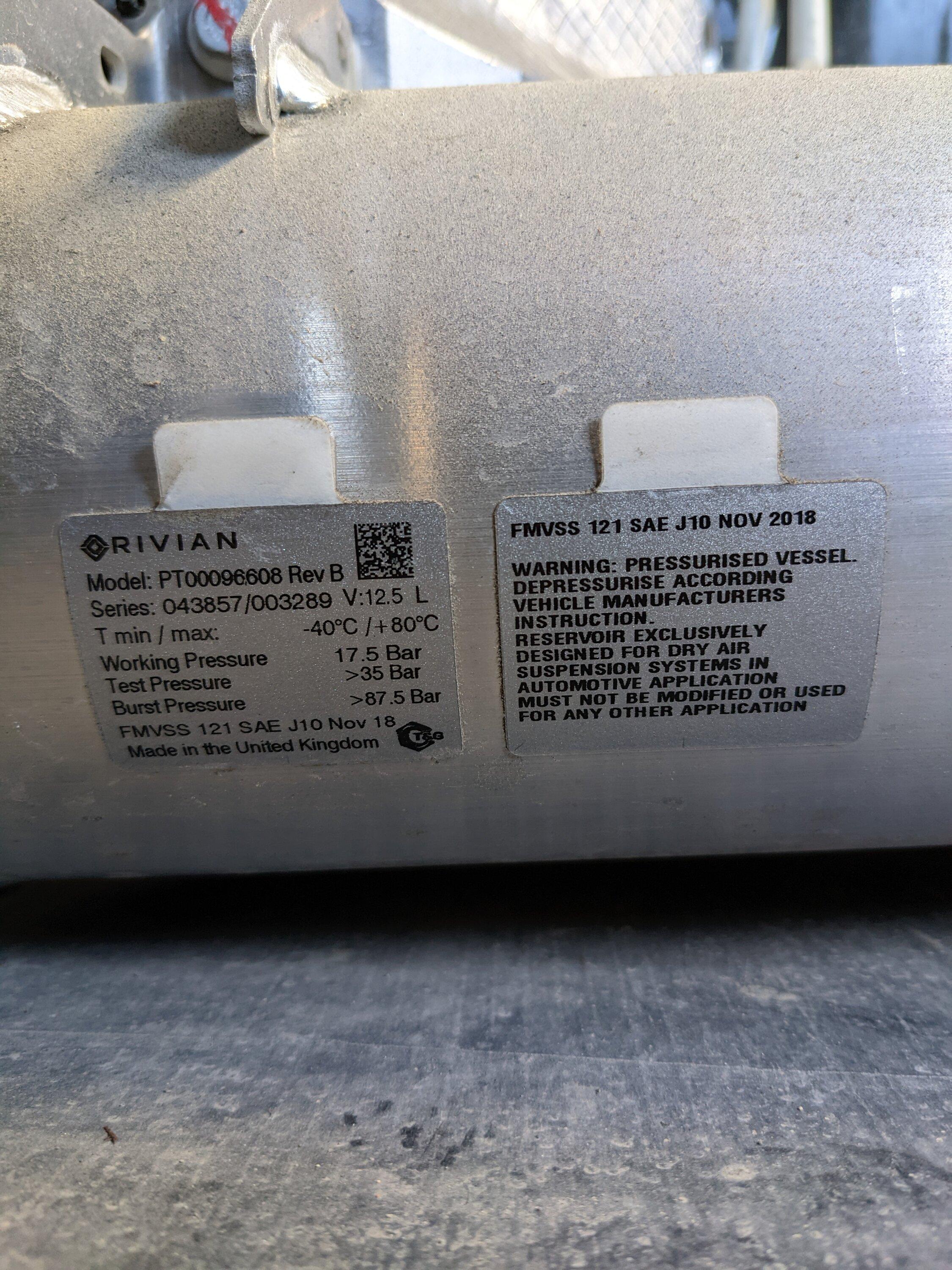

Air tank stickers.

That's some wonderful engineering detail on pressures. Wish we could have that much info about all the systems.
pressure vessels require this information on their data plates.
wouldn’t be there if it didn’t have to be

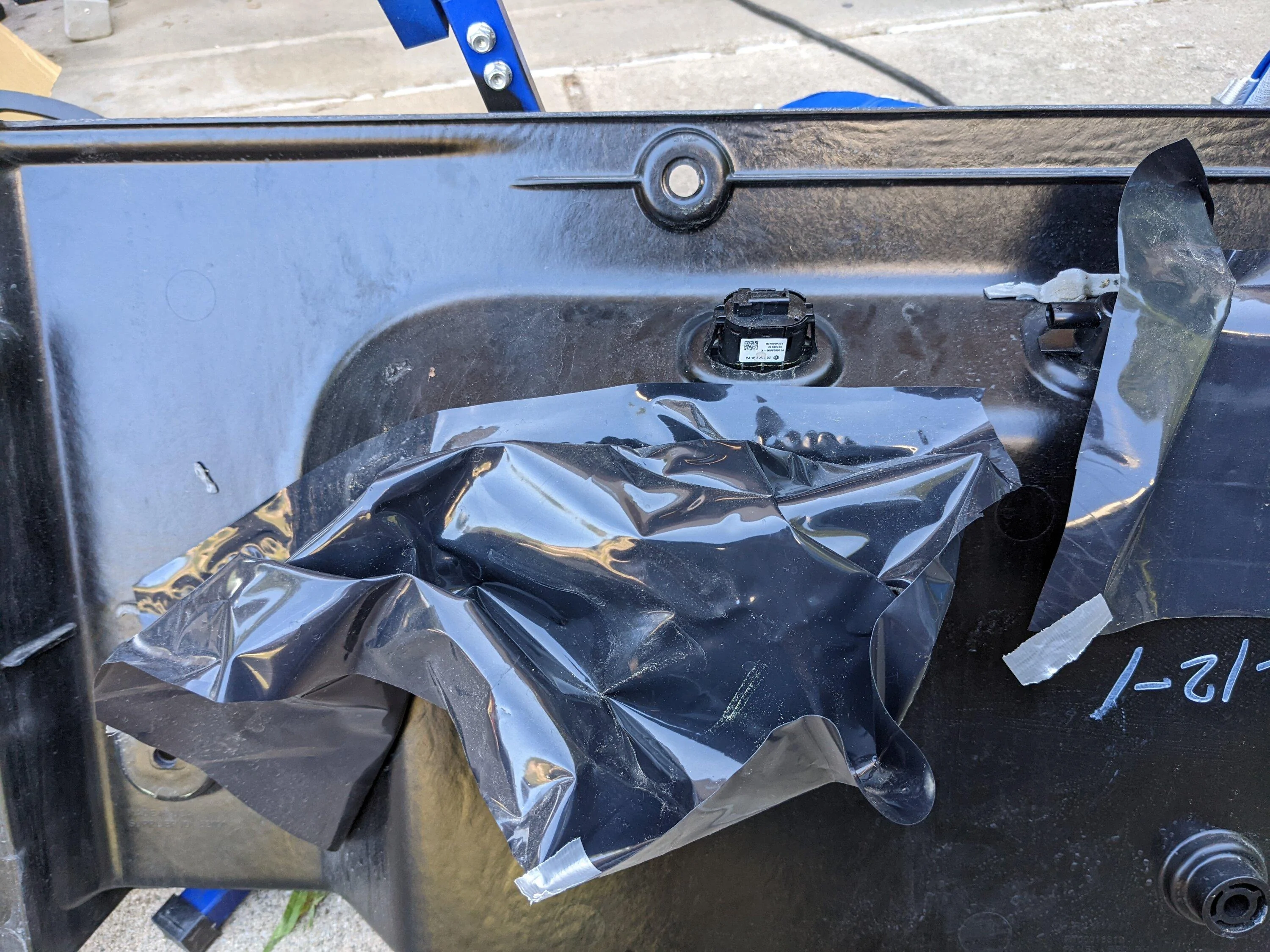

One thing I noticed after pulling the side panels off is that there are plastic sheets that use a weak adhesive to stick to the panel and stop water from dripping into the electronics on the side of the bed. If you are getting water leaking through the outlets in the bed, its likely that the sheets don't have good adhesion or are folded out of place.
Looks like the same sort of thing you find in doors to protect window mechanisms
