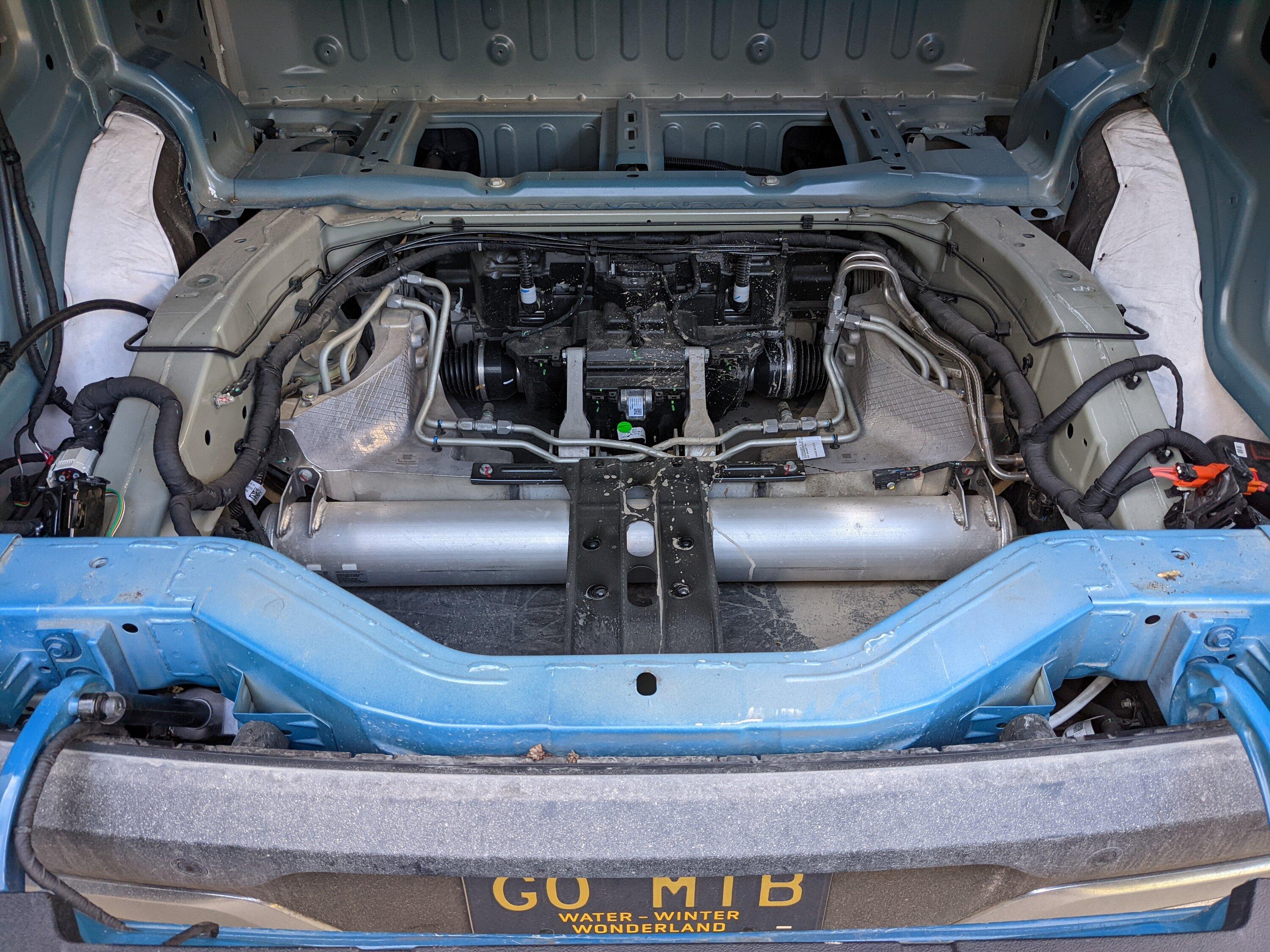

Pulled the bed out to run some wiring... What a pain in the ass.
‘Can you see if dirt get in behind the bumper, is there a way out for it from underneath? I assume they have drain for water.

It would just run out, it's all sloped.

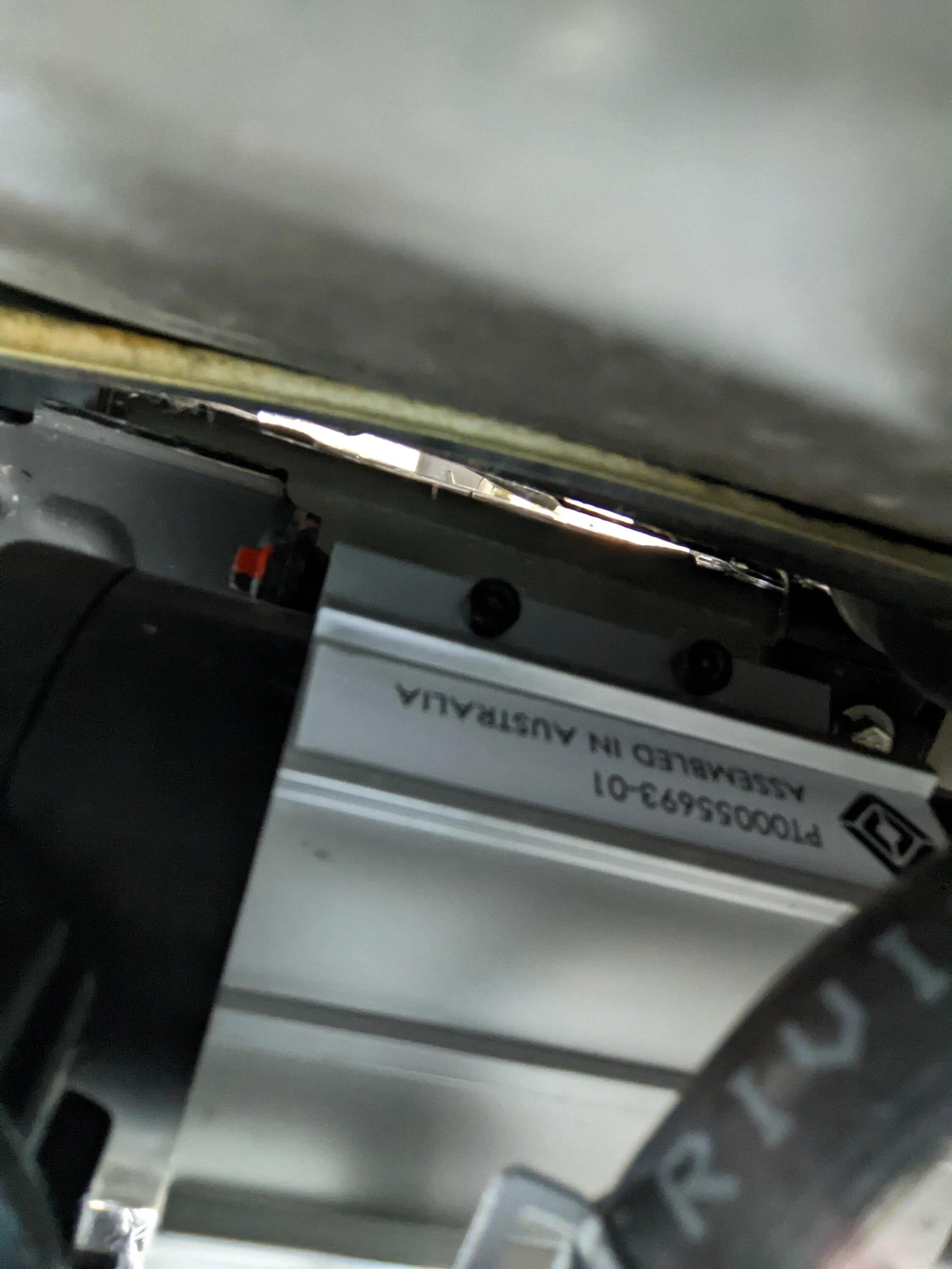

Doesn't seem to say ARB anywhere I can see without unbolting it, but it does say assembled in Australia.
That makes sense. ARB is an Australian company.

Does the convenience compressor (in-bed hose connection) have temperature monitoring? We know the suspension compressor does but I didn’t know the other one does, too.
Good point. Are there 2 separate compressors or valving to do switch outlets?

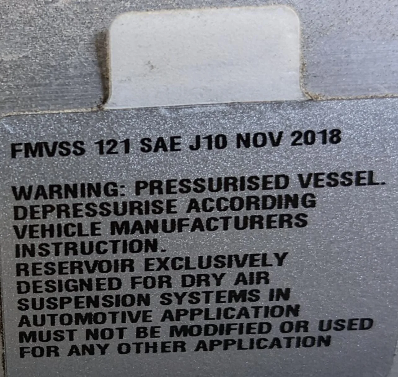

I’m pretty sure there are two compressors. First, Land Rover does it this way. Of course as a new manufacturer there is no guarantee that Rivian will follow conventional wisdom. Beyond that there are two other pieces of info we’ve learned that make me think there are two independent systems.
First, people are complaining about the volume of air when they try to use air tools even though the air suspension system has a pressure tank which should reduce this issue if the systems were connected.
Second, the tank on the air suspension system has this sticker:
Rivian R1T R1S R1 Teardown 9CF81504-6EF4-4566-AC71-6B25F750AA80
Aside from the fact that beach balls, tires, and rafts would fall under, “any other application,” the dry air part makes me think this is similar to the Land Rover system. In their system the suspension compressor draws in air through a desiccant, like silica gel. This is done to reduce the moisture in the entire system since there is no way to drain the pressure vessel like there is on many shop compressors. If you used the suspension system compressor to fill external items like tires, air mattresses, etc. then I think you’d saturate the desiccant and start introducing moisture into the air suspension system. Assuming Rivian handles this like Land Rover, dry air vented from the suspension system, like when lowering the vehicle, blows back across/through the desiccant to dry it back out for the next time the system has to draw air in.
I think I saw confirmation that there are fuse blocks in the Rivian but I haven’t seen a list of fuses. If we had a list that would probably settle this with some certainty of it shows two different compressors or even a fuse for the convenience compressor (or whatever the proper name is) in the bed with a relay, disable link, or fuse for the higher-power suspension compressor.
I could do more research if I had a Rivian of my own but that’s probably 12 months away so I’m relying on current owners to fill in some blanks.

Remember the bed compressor was to be an add-on option. And you can hear the little thing run when you use it. It has absolutely nothing to do with the suspension compression. And from the label you can see the suspension system is also 10x the pressure.
