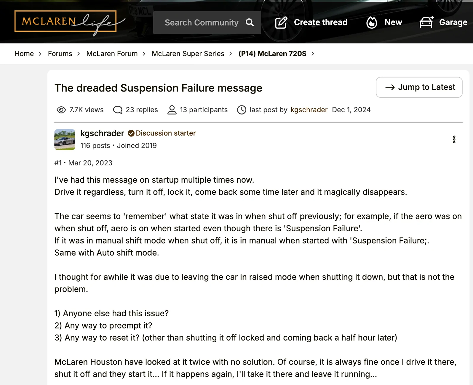

Google will disagree with you. Google any of the following:
G Wagon air suspension failure
Range Rover air suspension failure
Hummer air suspension failure
and the design basis for our R1 Rivians - McLaren - you think someone put 120k miles on a McLaren?
Tenneco/Monroe is the McLaren and Rivian OEM
