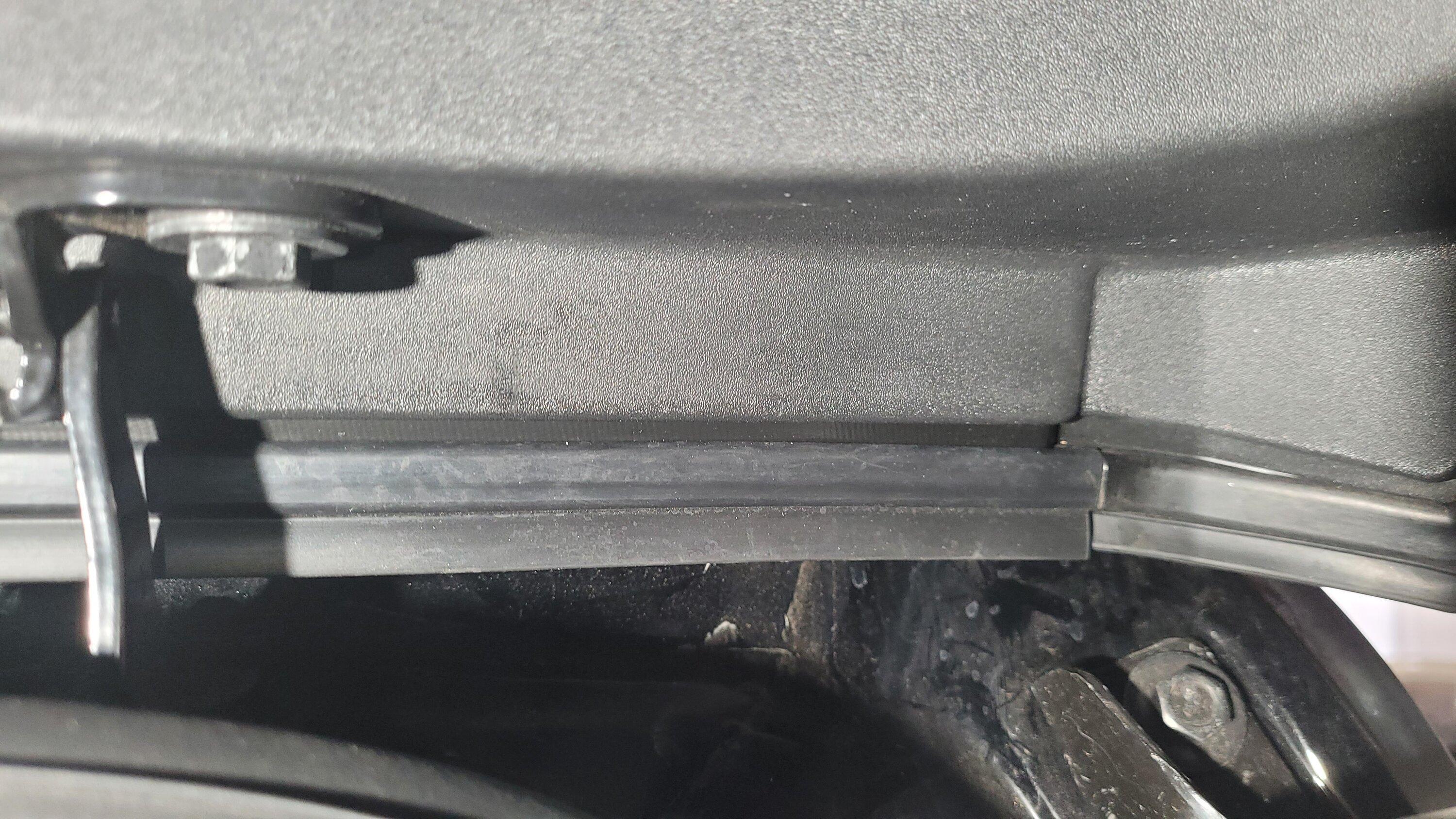

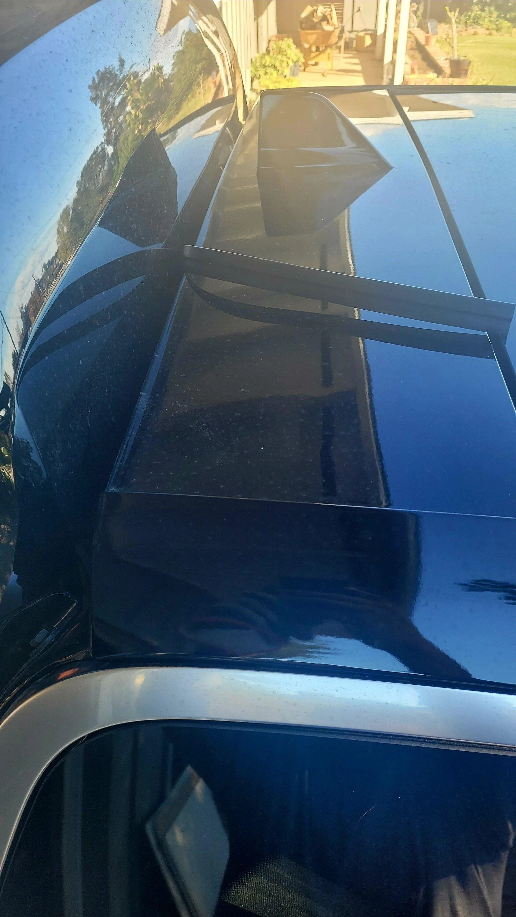

Update. I just got my Rivian back yesterday with the liftgate issue and I am posting their invoice response.
They also replaced the liftgate trim from the original soft rubber to a harder plastic version that fits into the hinge channels.
"Concern:- Customer states that they are still having issues with opening/ closing liftgate/ tailgate after previous service. Cause: - Strut bracket out of position"
Now liftgate works on a decline angle!
Hope this helps others.
I'm including a picture of the old trim and new
