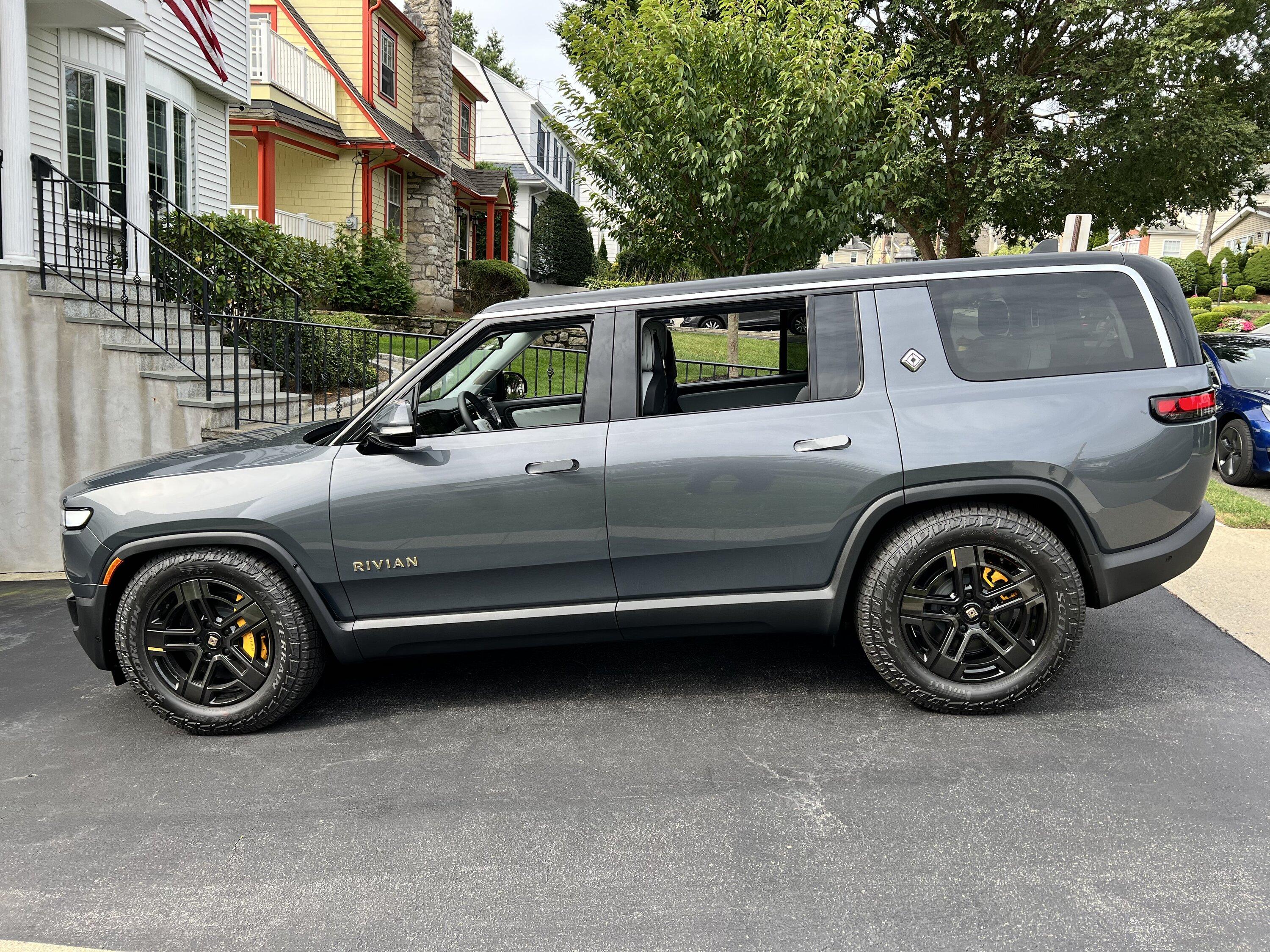

I also have to that issue on my sloped driveway. Tried the button at the liftgate, via the app, and via the entertainment screen. Got my R1S in September, took it to the Brooklyn service center October for that issue and they said that they raised the back and could not replicate the issue. I took the car back without the issue being resolved. It still occurs. I get a message on my phone indicating obstruction detected, but tgere is no obstruction.
Perhaps this is another similar issue. I have the car set to go i to Kneel mode when i park. Kneel mode doesn’t work at the same incline. It works fine on level ground.

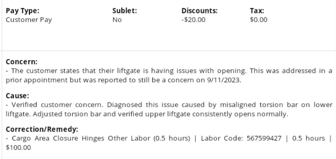

Keep us posted if they can fix this. Don't forget to try s decline angle before you leave the service center ?
They fixed it quick! See attached reference to "torsion bar" adjustment.

Just to clarify, you tested it on a decline before leaving the service center? That's great news if they fixed it! I have an appointment next week and I will show them this reference. Thanks for keeping us updated ?
