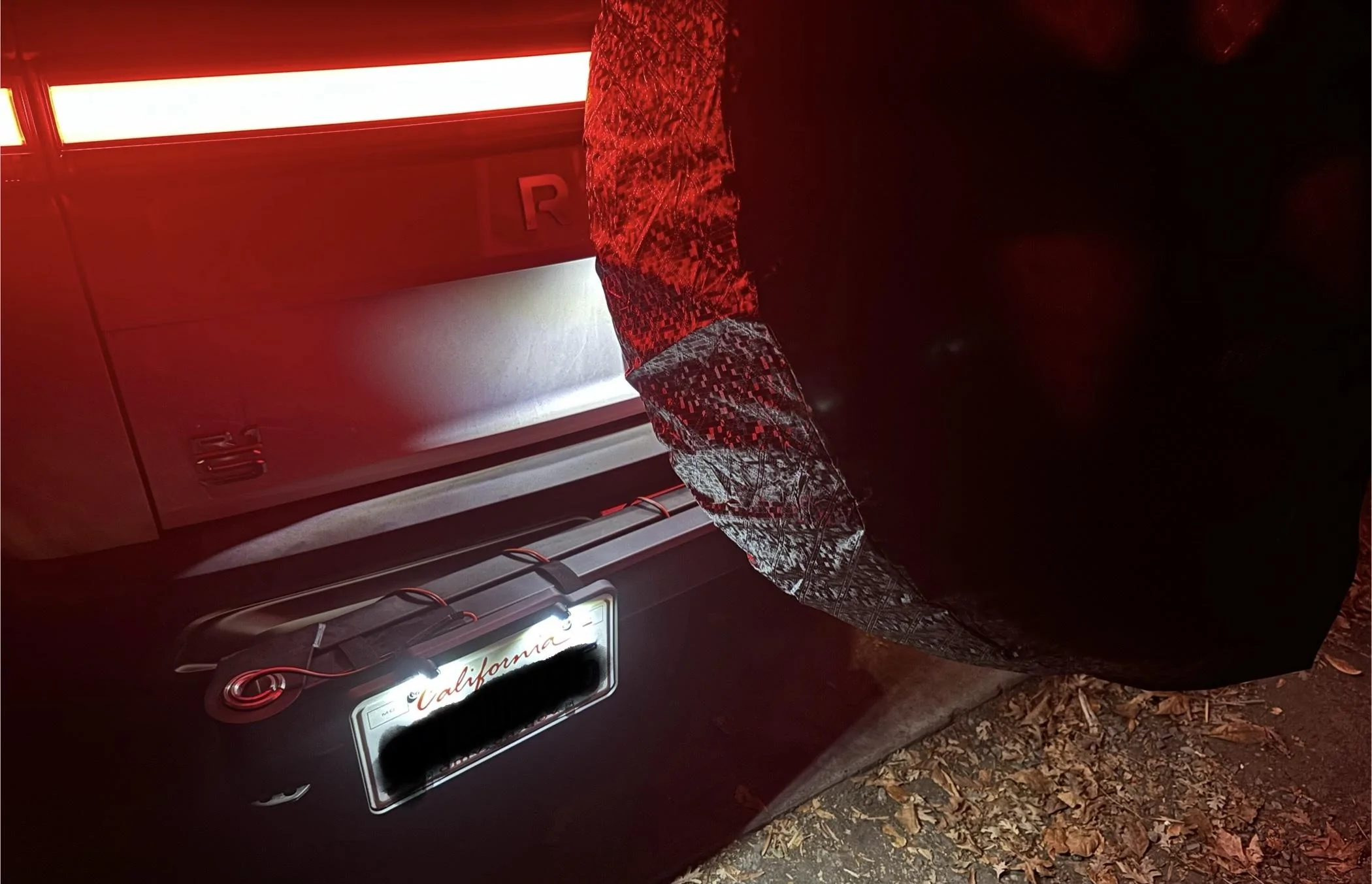

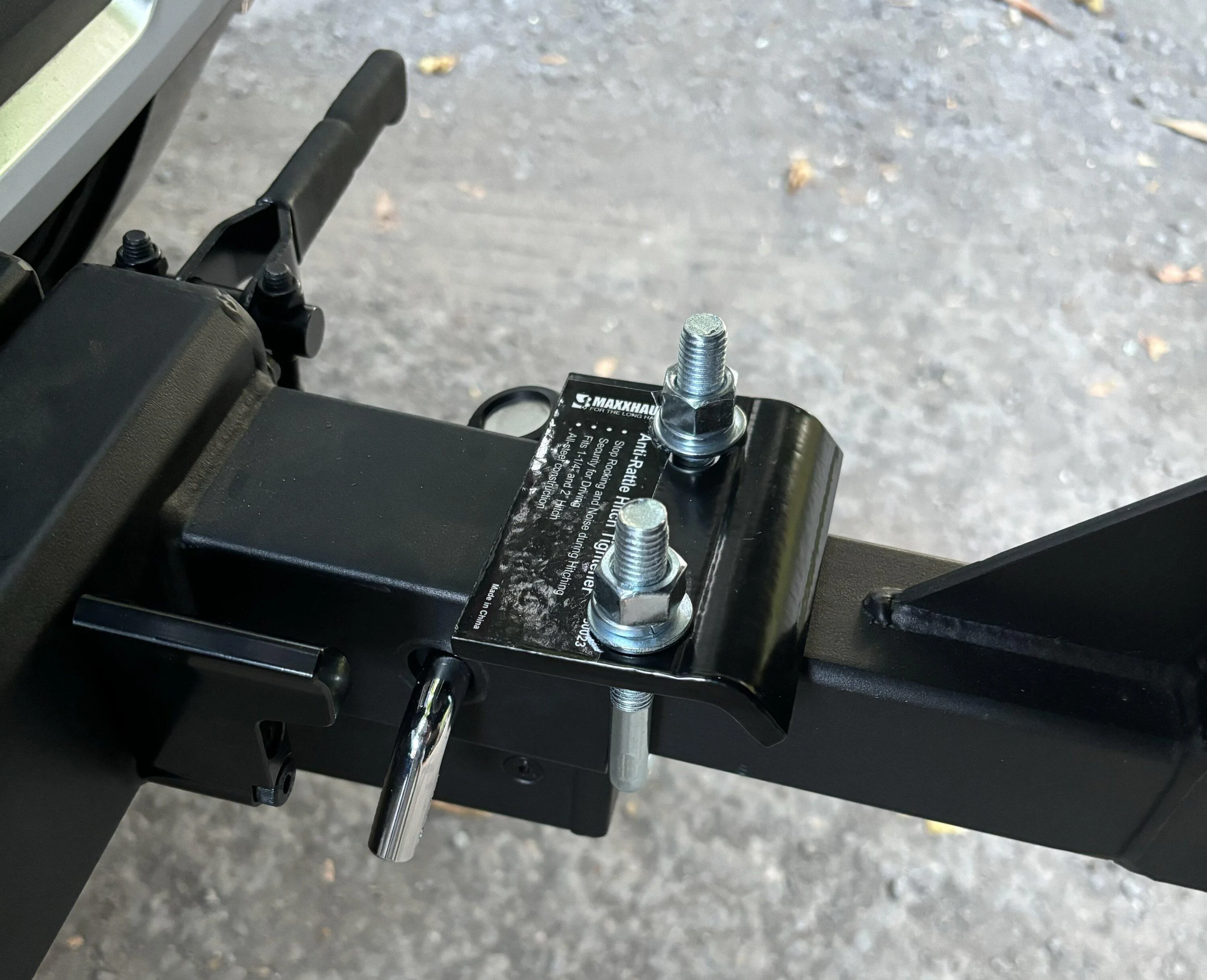

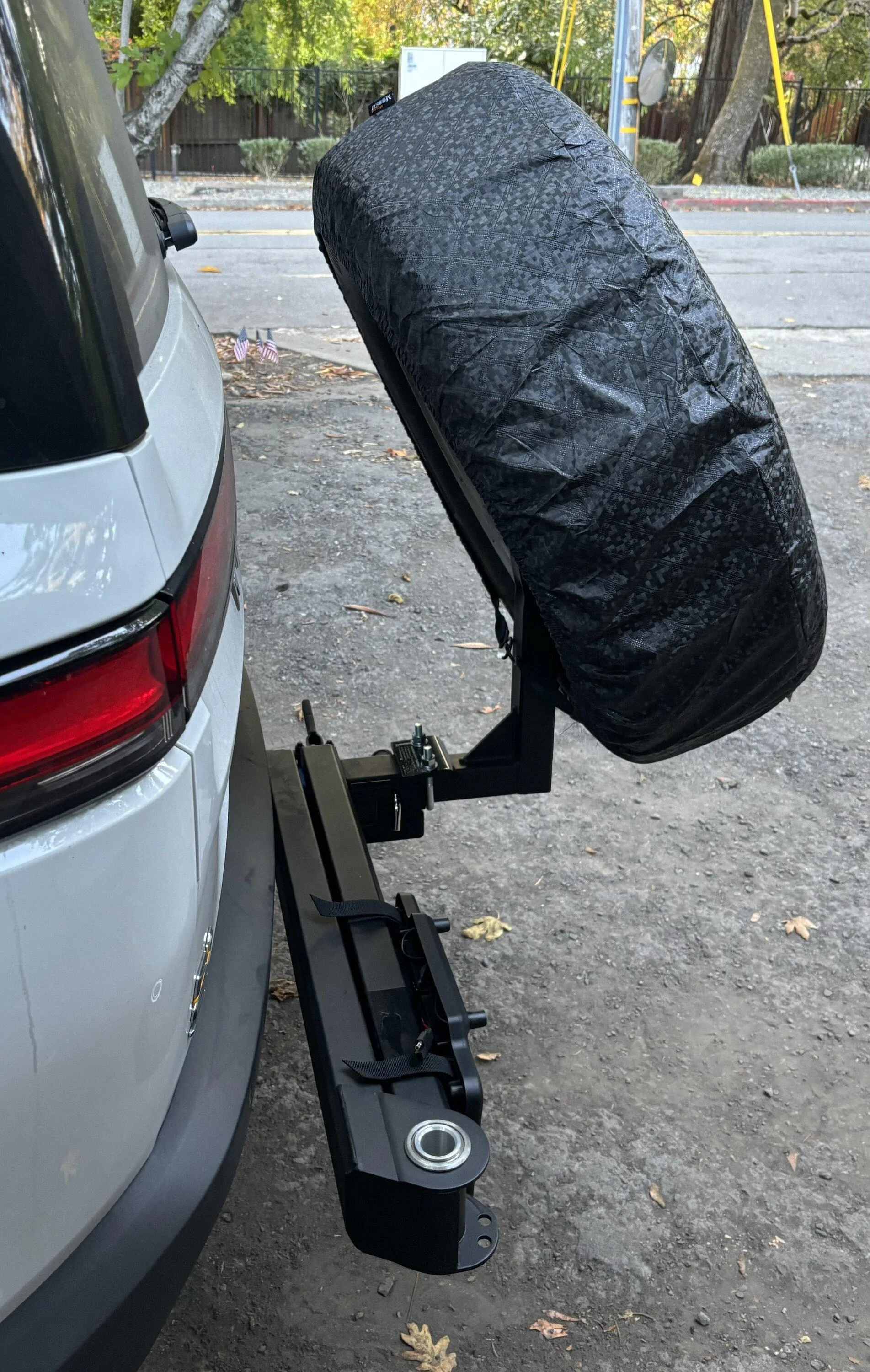

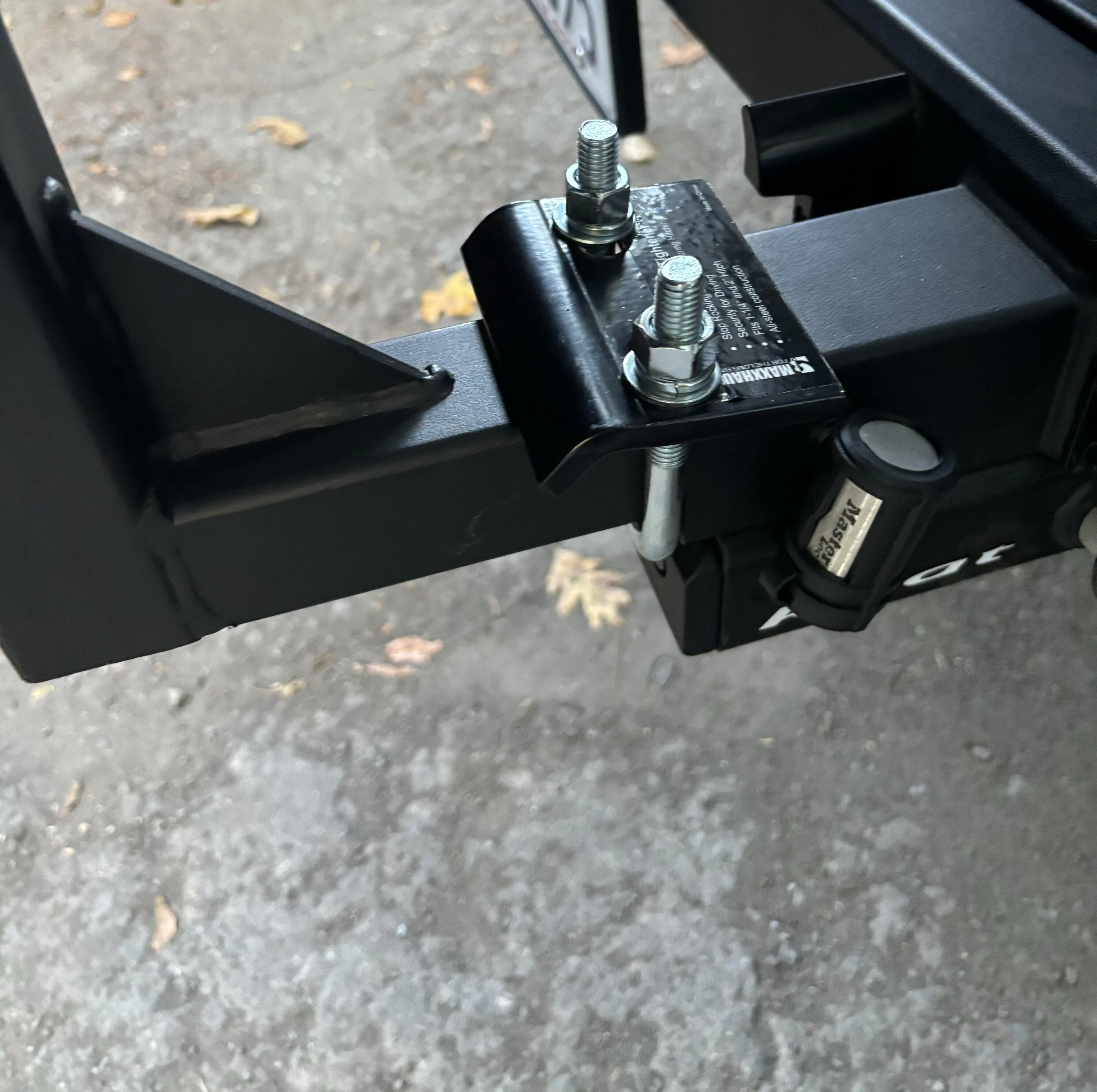

Ok. Didn’t find a working anti-rattle pin. BUT do have an anti-rattle locking solution that is working well now after a few failed attempts. What I landed on as my setup:
The result is rock solid and after a test drive today I’m very happy with it.
Also, to relocate the license plate I added the Thule license plate holder and used this trailer plug adapter to get the light working (thanks for that info @Si.LE.R1S in your thread on the DIY solution! Would have DIYed if I had more time before departing on an upcoming trip).
Edit: pics
Did you also use the master lock to lock the swing arm to the hitch or just the spare tire holder to the swing arm? I ordered the master lock but it doesn’t seem long enough to use on the truck hitch.
GreenOptimist
Aug 7, 2022
159
116
Mostly Cali
I used the master lock to lock the spare tire holder to the swing arm. The Kuat has a lock that is long enough and comes with it, so used that to lock the swing arm to the hitch.
