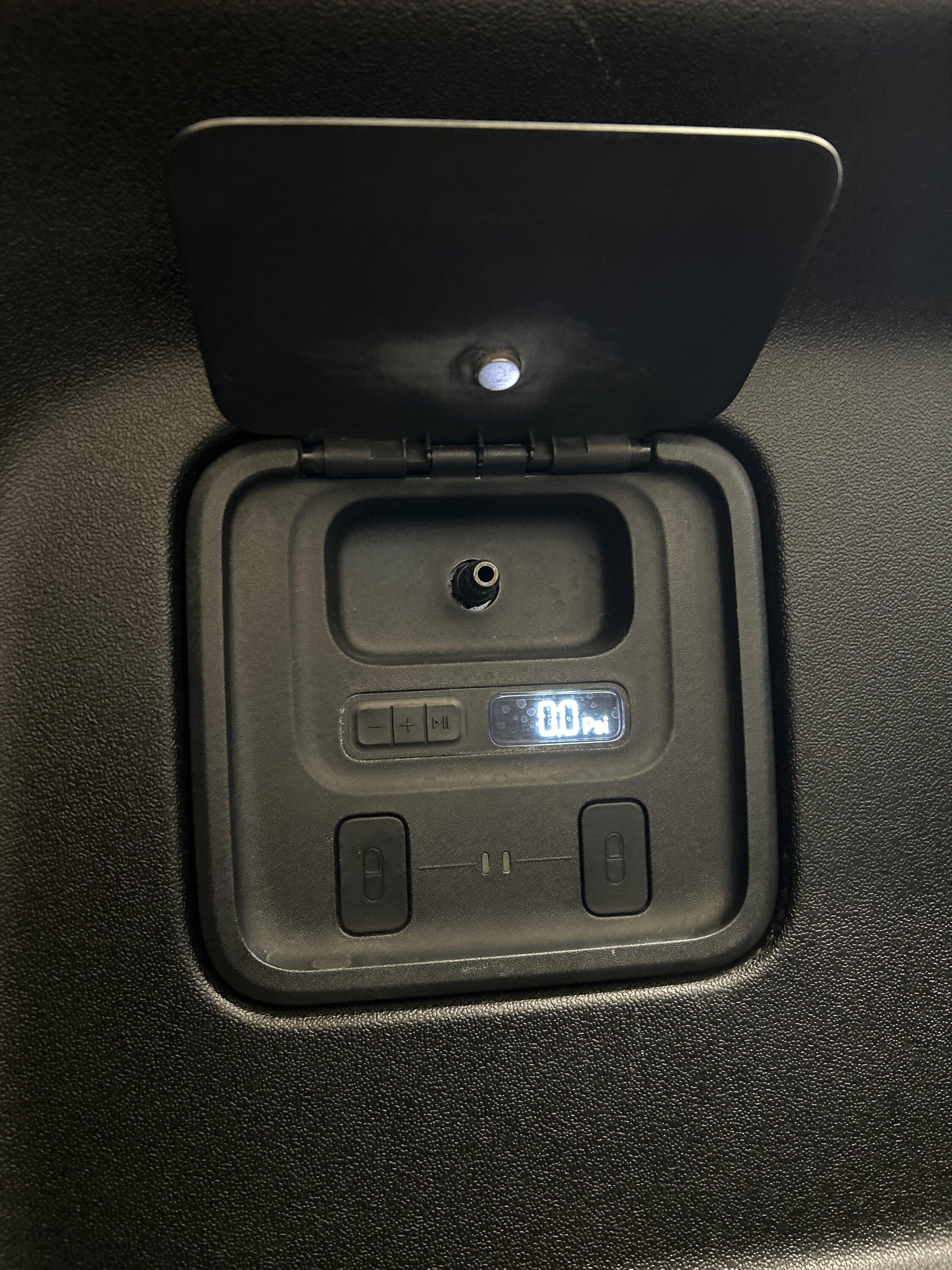

I also used magnets. Bought these magnets on Amazon...
"Magnetpro Neodymium Magnet 8x1 mm with Self-Adhesive Dots Magnetized in Pairs Pack of 50 (8x1)"

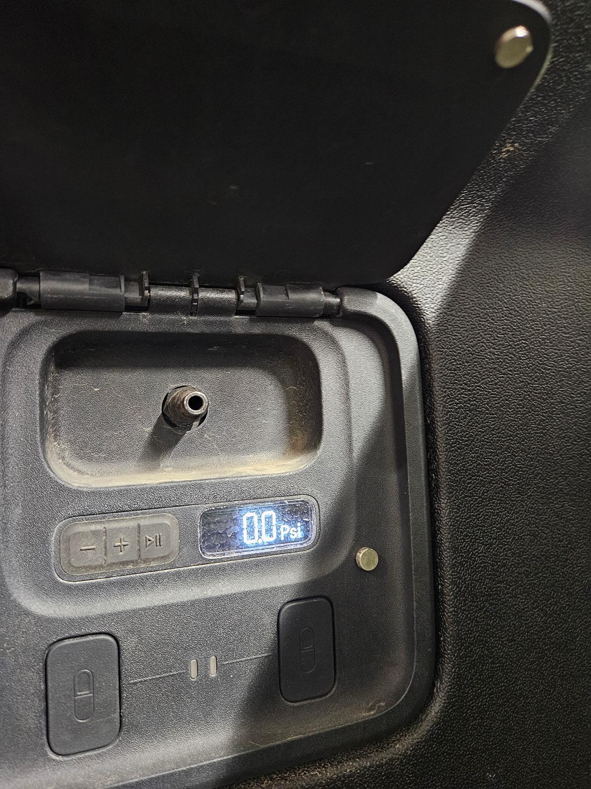

This was my simple solution. Single magnet is the exact thickness needed to hold the door in place against the steel air spigot.
Get these magnets at Home Depot along with a bottle of super glue.
Rough up one side of a magnet and its mating surface on the back of the cover. Stick the slick side of the magnet onto the air spigot and put a drop of super glue on the rough side. Immediately close the lid and apply pressure in the center over the magnet for about a minute. Problem solved.

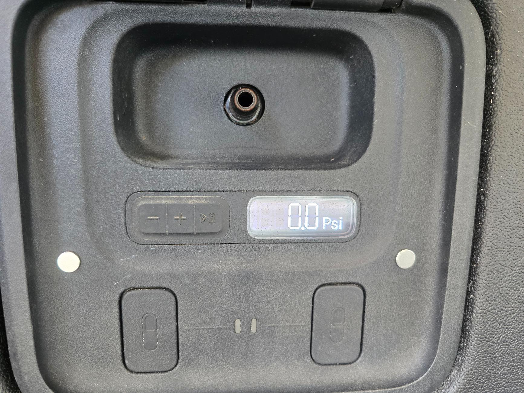

I copied CO-Ed. Works great. I adhered the 2-magnet stack to the door first, then closed it to adhere to the right spot on the panel.
2mm thick magnets might be even better to get the door more flush. Super happy though to keep the dang door shut.
