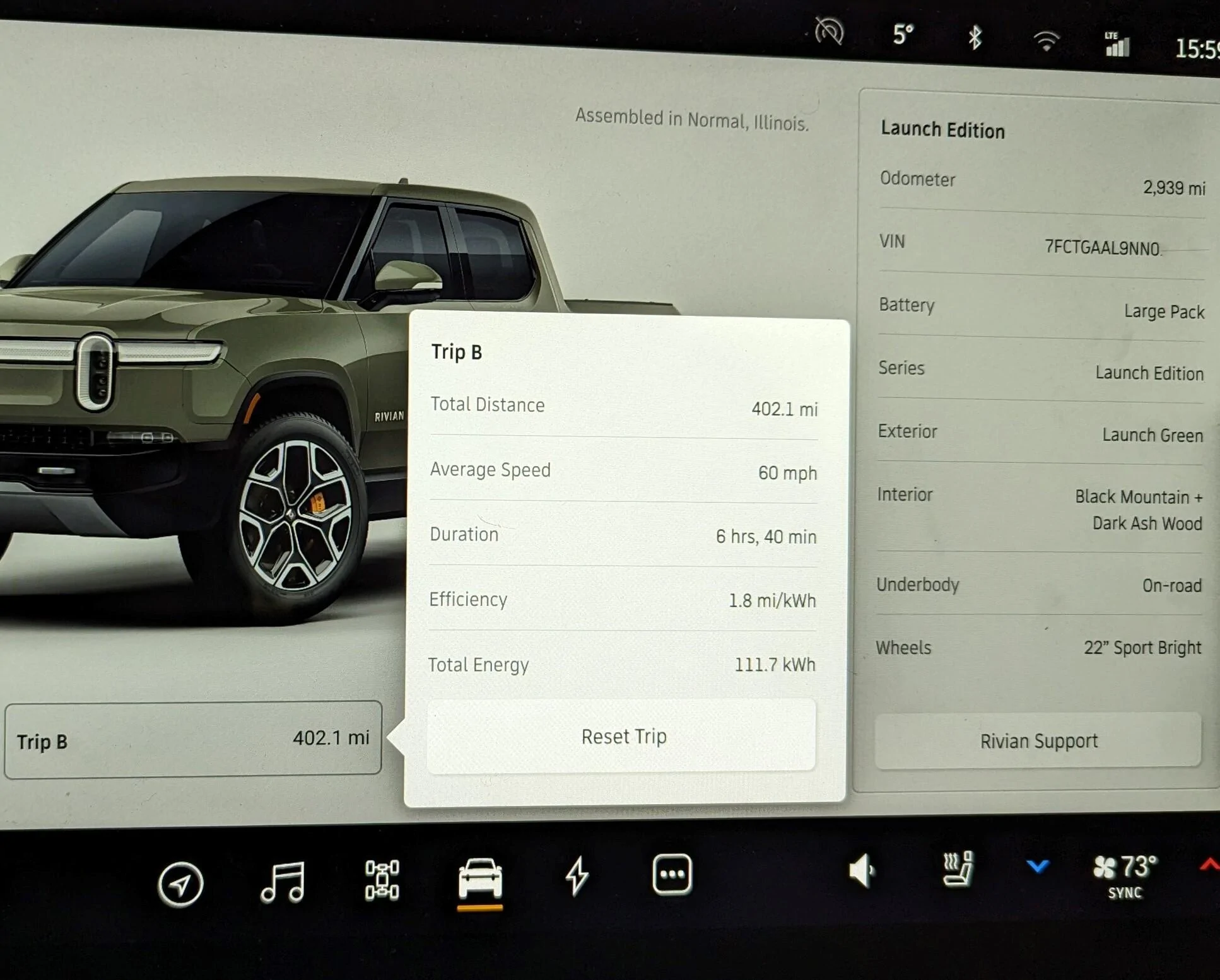

TLDR; I took the truck up from Baltimore to VT (Mt Snow) for skiing. Packed with 2 adults, 3 kids, and all our skiing gear. I continue to be impressed by how easy it is to fit anything and everything in here and how easy the truck is to drive. Charging was effective though not perfect. Truck performed well in the elements.
Sat Dec 24 trip north: Temps ranged from 5 to 12 degrees and a 15-20mph west to east crosswind the entire day. Also about 1700ft of net elevation gain. Overall efficiency was good for the conditions at 1.80mi/kwh. The first 30 minutes efficiency was less than 1mi/kwh as battery was warming. Our first charging stop was great at EA. Peak of 181kw on a 150kw terminal. The preconditioning flag came up about an hour before the charging stop. More on charging below. Second stop was at a Shell Recharge in Shadock NY. Peak of 212kw on a 350kw terminal. We encountered a lot of snow/slush/frozen goods on rt 9 across southern VT. Truck handled perfectly with no issues. I used snow mode here and it was great with slightly less regen than usual.

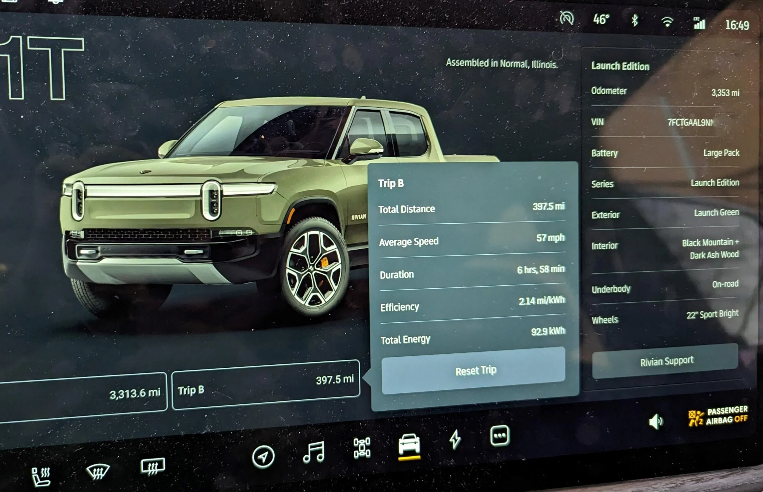

Wed Dec 28 trip south: Temps ranged from 18 to 50 and light winds with same elevation lost as gained earlier. We did encounter some traffic so slightly lower avg. speed. Efficiency nearly 20% higher at 2.14mi/kwh, probably as expected. Only one charge at EA. Peak of 174kw on 150kw terminal. Preconditioning again came up about 1 hour before the stop.
