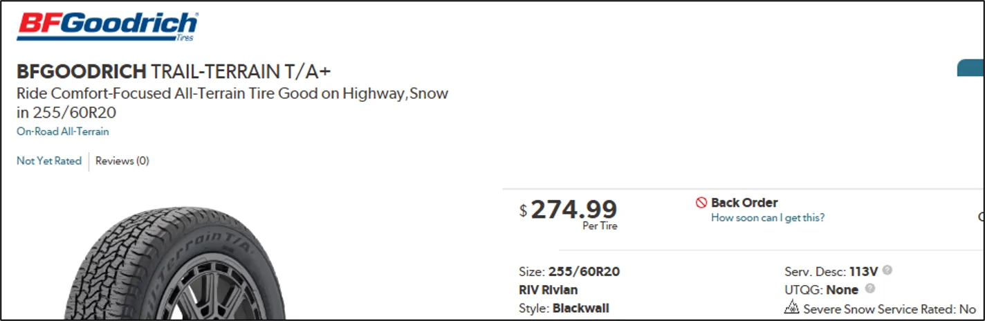

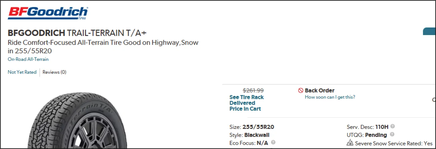

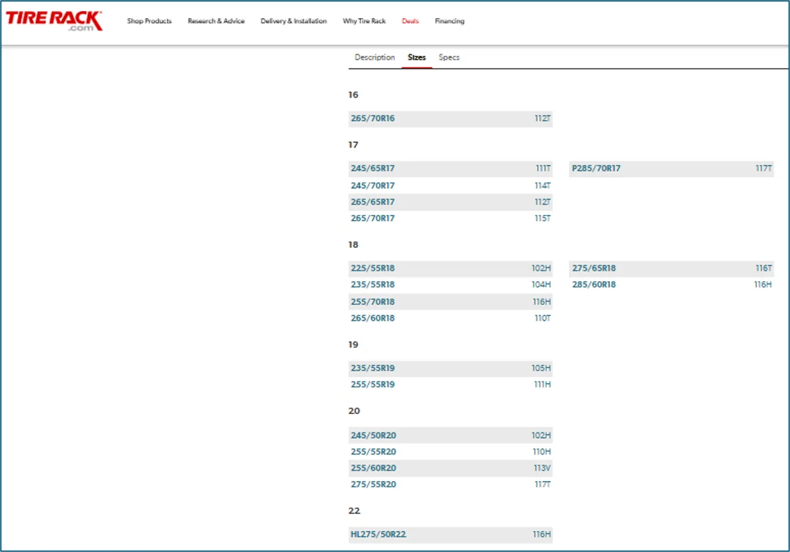

This strangeness w/ BFG Trail-Terrain T/A+ continues - I just clicked on EVERY size currently listed on Tire Rack - ALL are 3PMSF except R2's 255/60/20. Perhaps production startup weirdness?
I'm aiming for ~summer 2027 for MY28, so perhaps this or other 3PMSF will materialize - Pirelli WeatherActive, please (we have them on 3 cars - all good). But I'd get Michelin AS before a replacement set of BFG ATs w/out 3PMSF. At some point this will transition from weird to stupid - clutters up brand identity for new T/A+ before it even launches. Well done.

For example -
Ride Comfort-Focused All-Terrain Tire Good on Highway, Snow
in 255/55R20 -
Rivian R1T R1S R2 Wheels Options, Tire Sizes, Width, Offset - Hub Bore Size - 19" and 20" 1779715007507-6
Severe Snow Service Rated: Yes"
in
255/60R20 -

Severe Snow Service Rated: No"
So, no snow? (combo-rhyme on purpose, sorry)

Here's a link to a short article from Expedition Portal on the Trail-Terrain+ tires, the same in name at least as those fitted to the R2 20" rims. Note as I had previously observed a month or so back the OEM variant on the R2 is not the same tire as the retail version and as such does not come with a 3PMSF rating per following quote. So we're likely going to have to wait a while to have feedback on how the OEM tire will stack up vs the retail spec and vs other tires
"You’ll also see the 2026 Rivian R2 roll out of the factory with the BFG Trail-Terrain+ tires, although it will be a modified OE-spec version. This means a different tread depth, different compound, etc., which comes with no 3PMSR and a lower mileage warranty. So basically a different tire, but with the same name stamped on the sidewall. The same is true of OE versions of the Trail-Terrain that are currently fitted to vehicles like the Defender Octa, Sorento X Pro, and Tacoma TRD Off-Road. "
