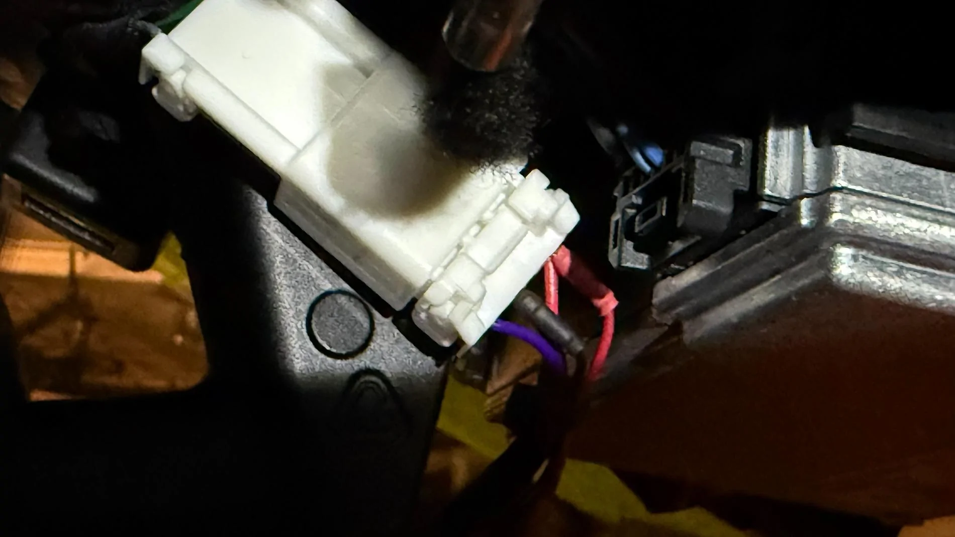

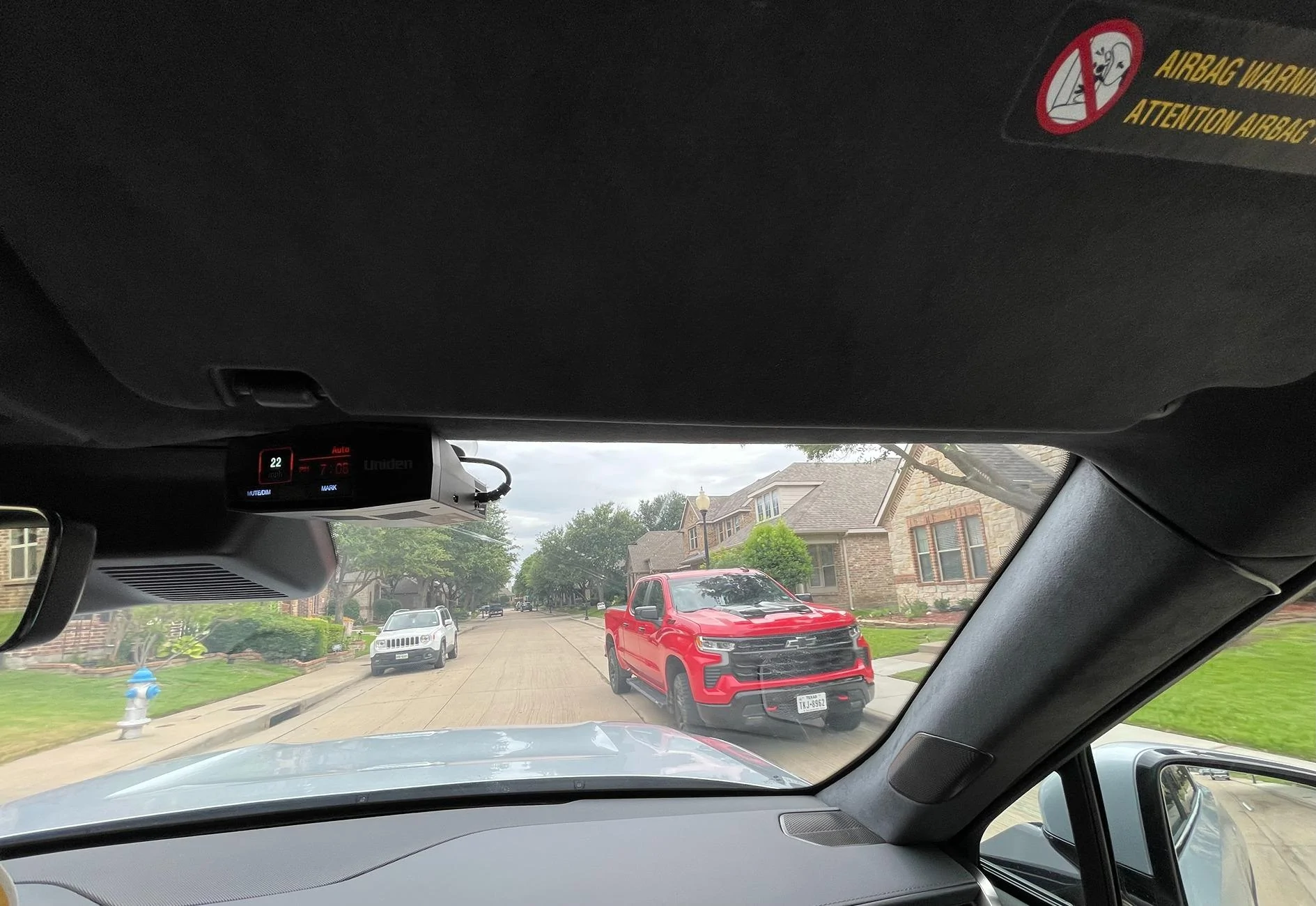

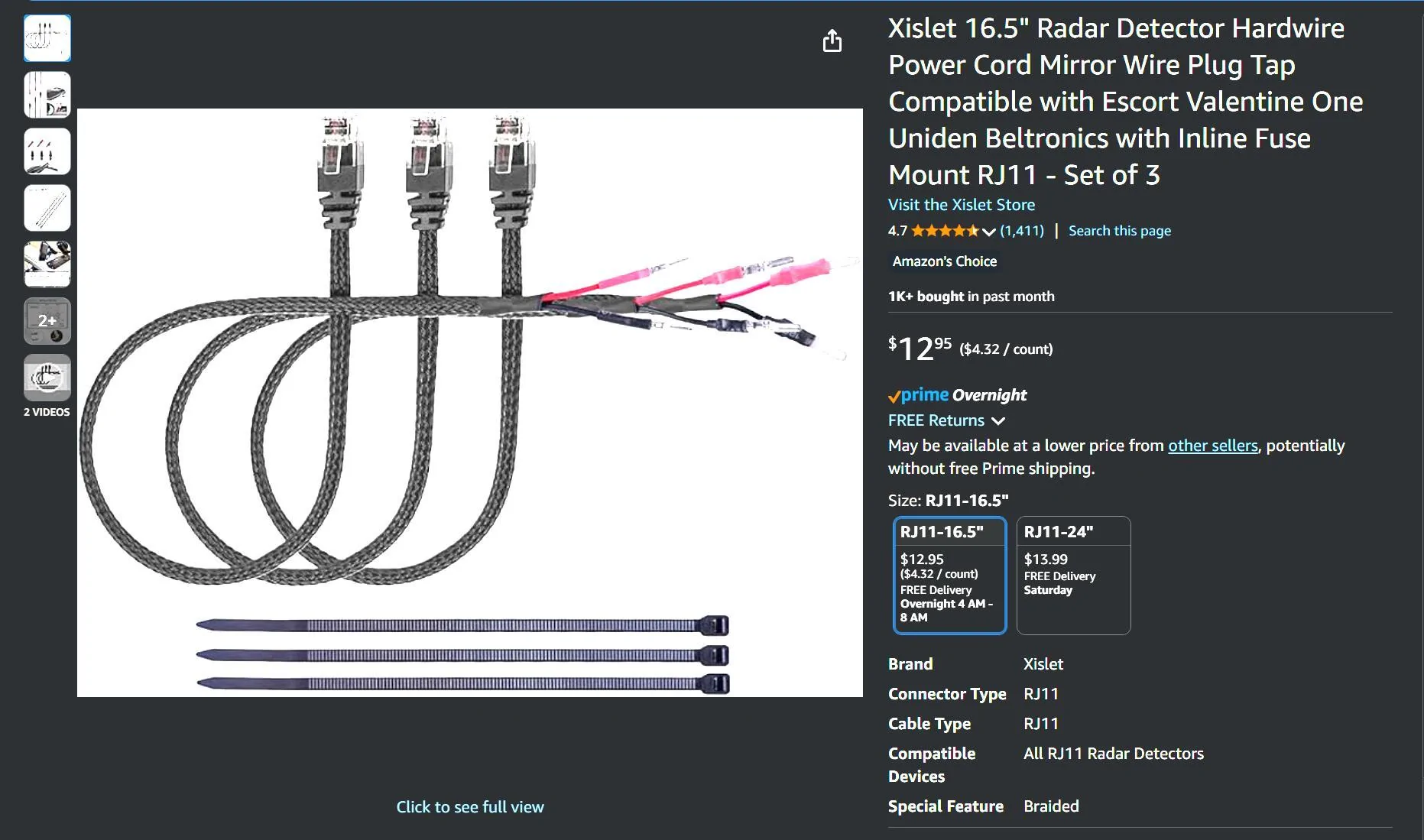

I picked up the hard wire pigtails to tap into the rear view mirror for my car. For now on the loaner I have it installed using USB - C to RJ11 for power and running it around the headliner / rubber seals
On my vehicle I will be using mirror taps listed below for a cleaner install.

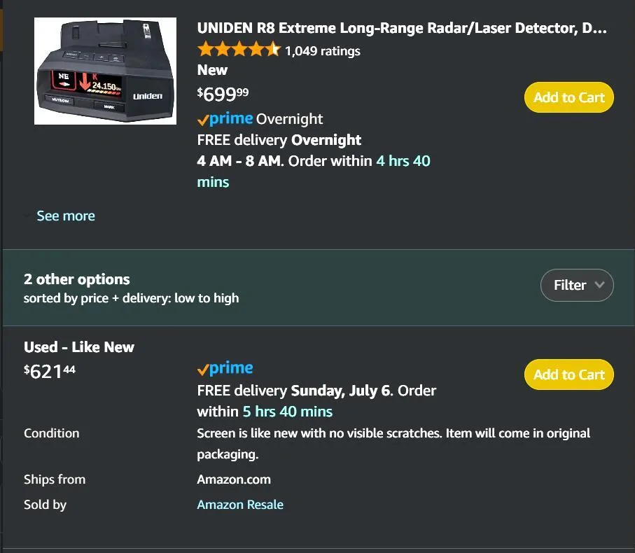

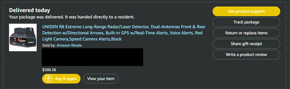

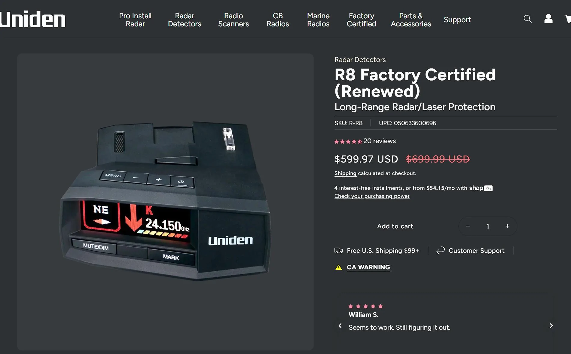

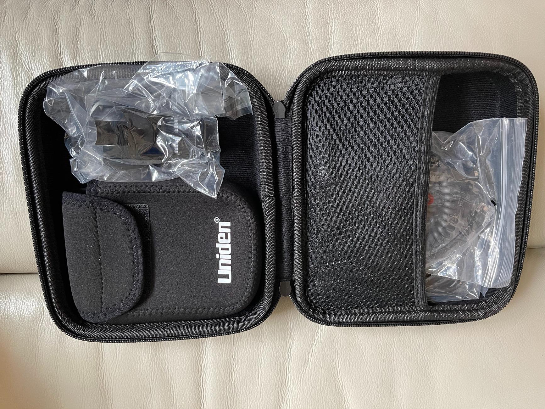

I also picked up the Uniden R8 from Amazon in Like New with all accessories still sealed for $590. It's gone up slightly to $621 (300+ quantity in stock) but still available as certified refurbished direct from Uniden for $599. Couple options for you if you're interested in getting a similar setup.

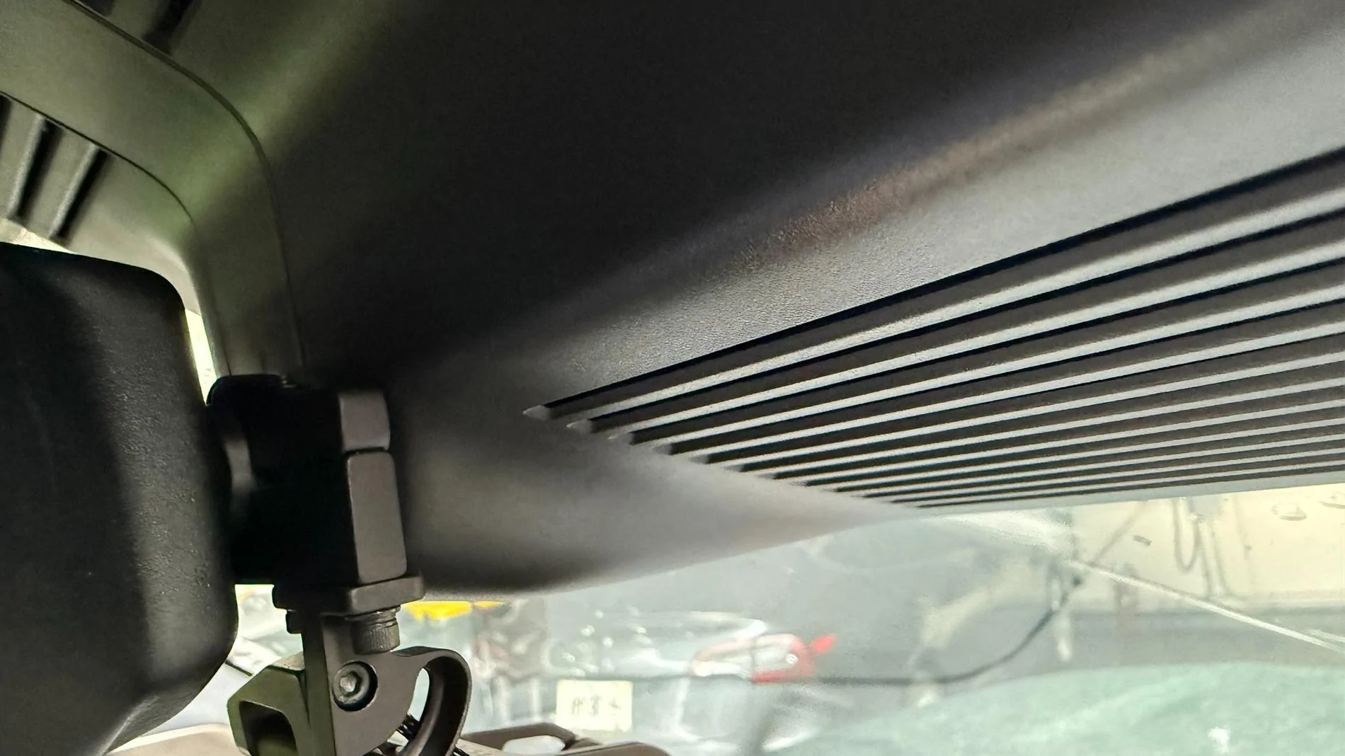

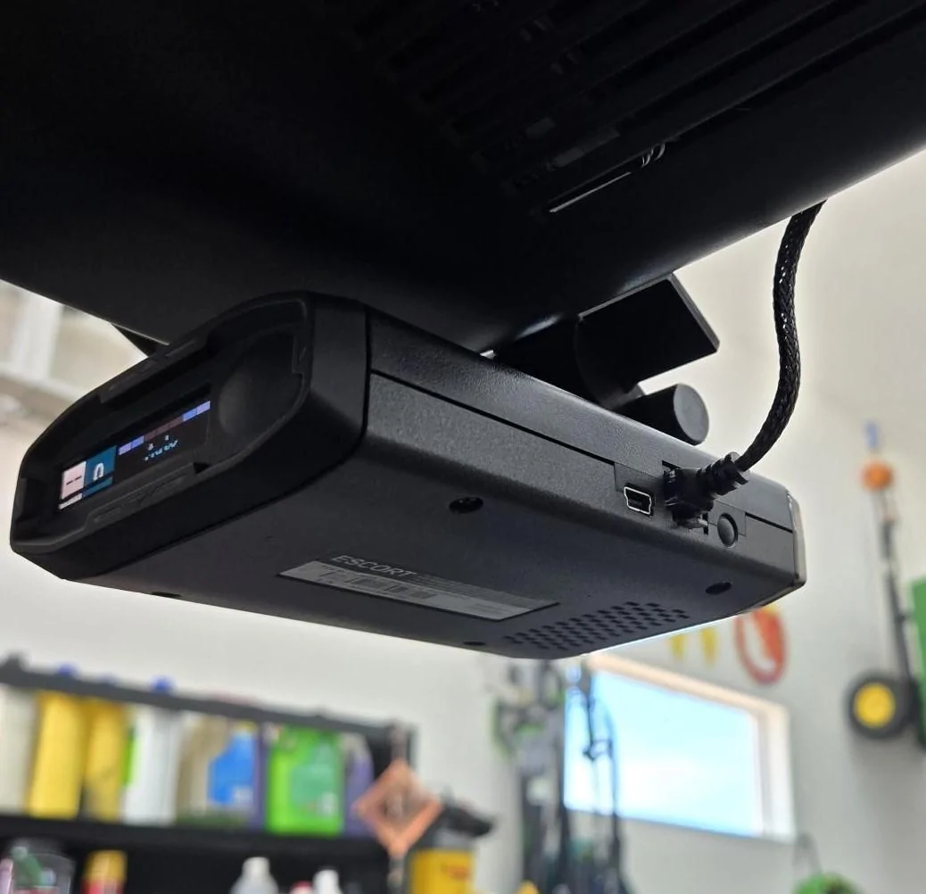

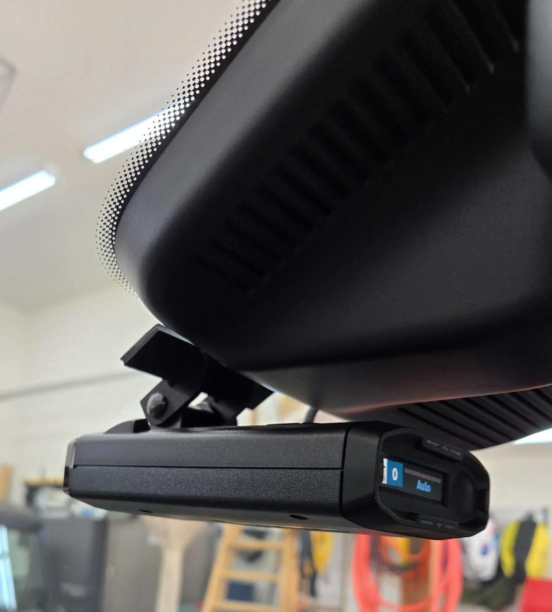

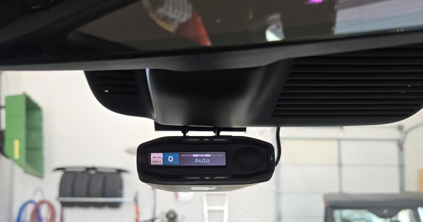

I can confirm, like a few others, that I had success with the BlendMount BMG-3032 and a mirror tap on my 2025 R1S. Here are some pictures of the completed install. Thanks to everyone for sharing the information!

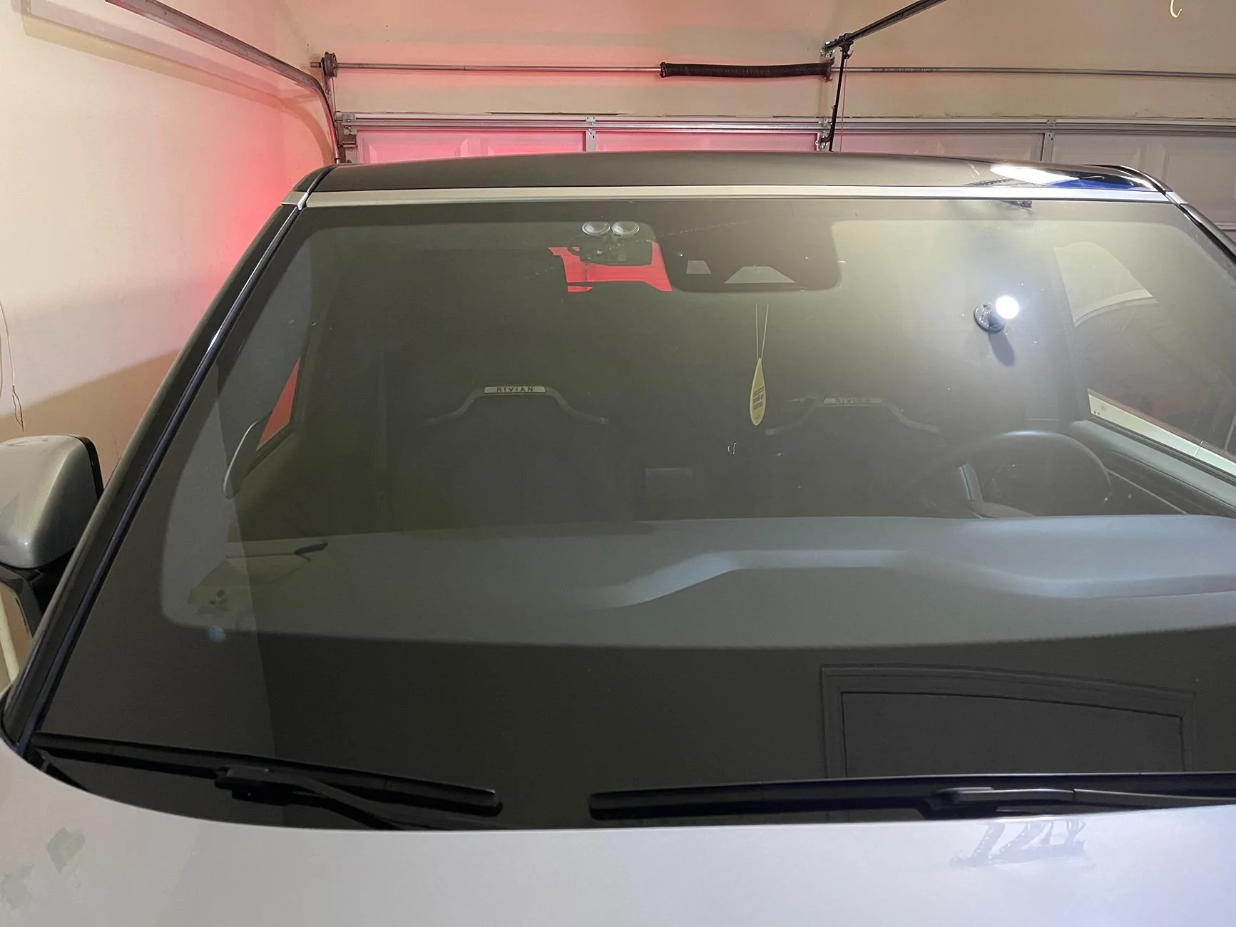

I installed the radar detector but noticing that it’s always on when in garage and Rivian is locked.
Anyone noticed the same or any idea when it turns off? I have a uniden r4

If I'm not mistaken, the Rivian still provides power (a very small amount) to power devices for a couple of minutes after you exit the vehicle. Try this.....exit the vehicle and check again in about 5 minutes. The unit should be shut down. Note: If it is still on, check again after 10 minutes. I think you'll find that the unit has shut down.
But you need to check without having your phone or key fob on you. Otherwise it'll wake up on approach and turn back on.
Thanks for your post, I was able to install mine.

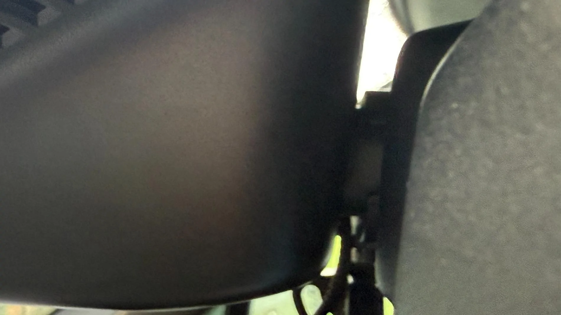

Happy to report that I was able to successfully install a Blendmount 3032 in a ‘26 R1S Quad
I retain full functionality of the rear view mirror

Interesting. Pic of the mounting location to the mirror?
