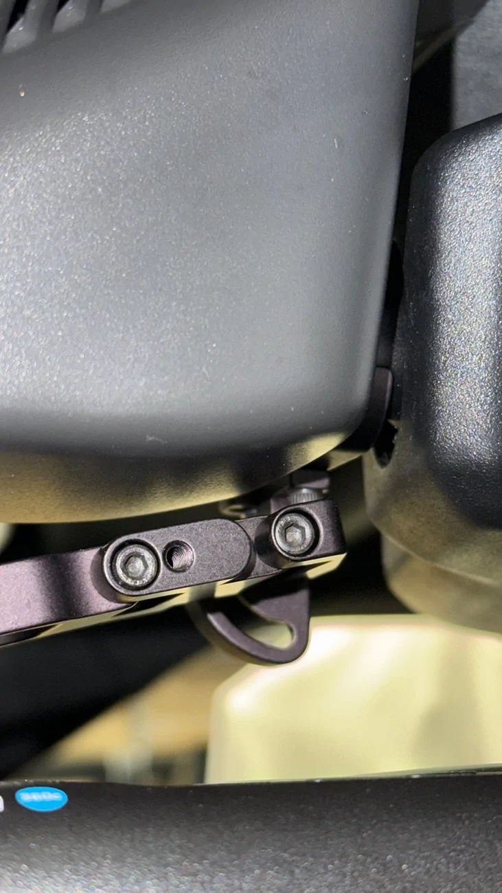

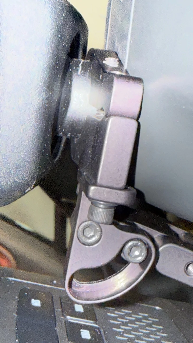

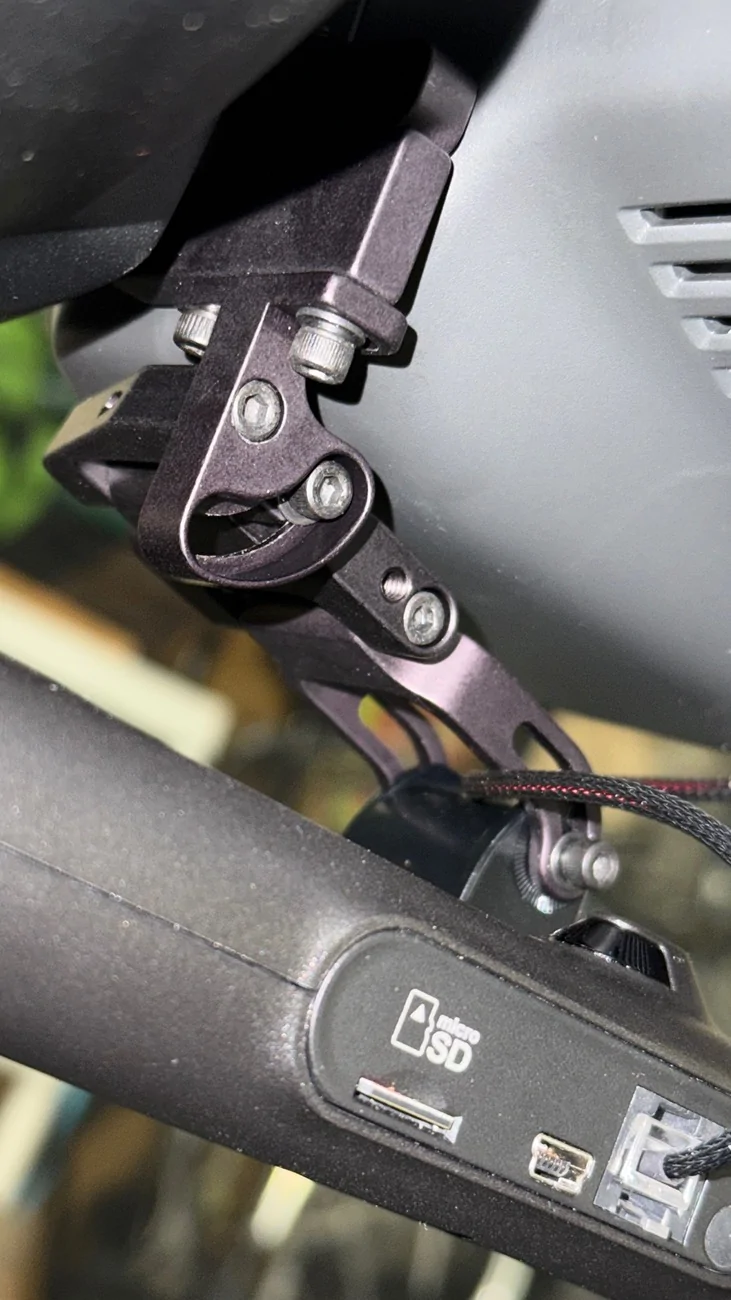

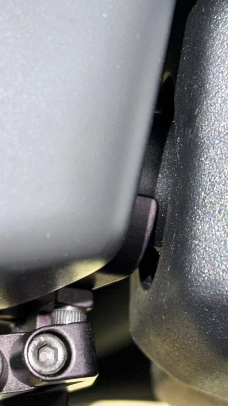

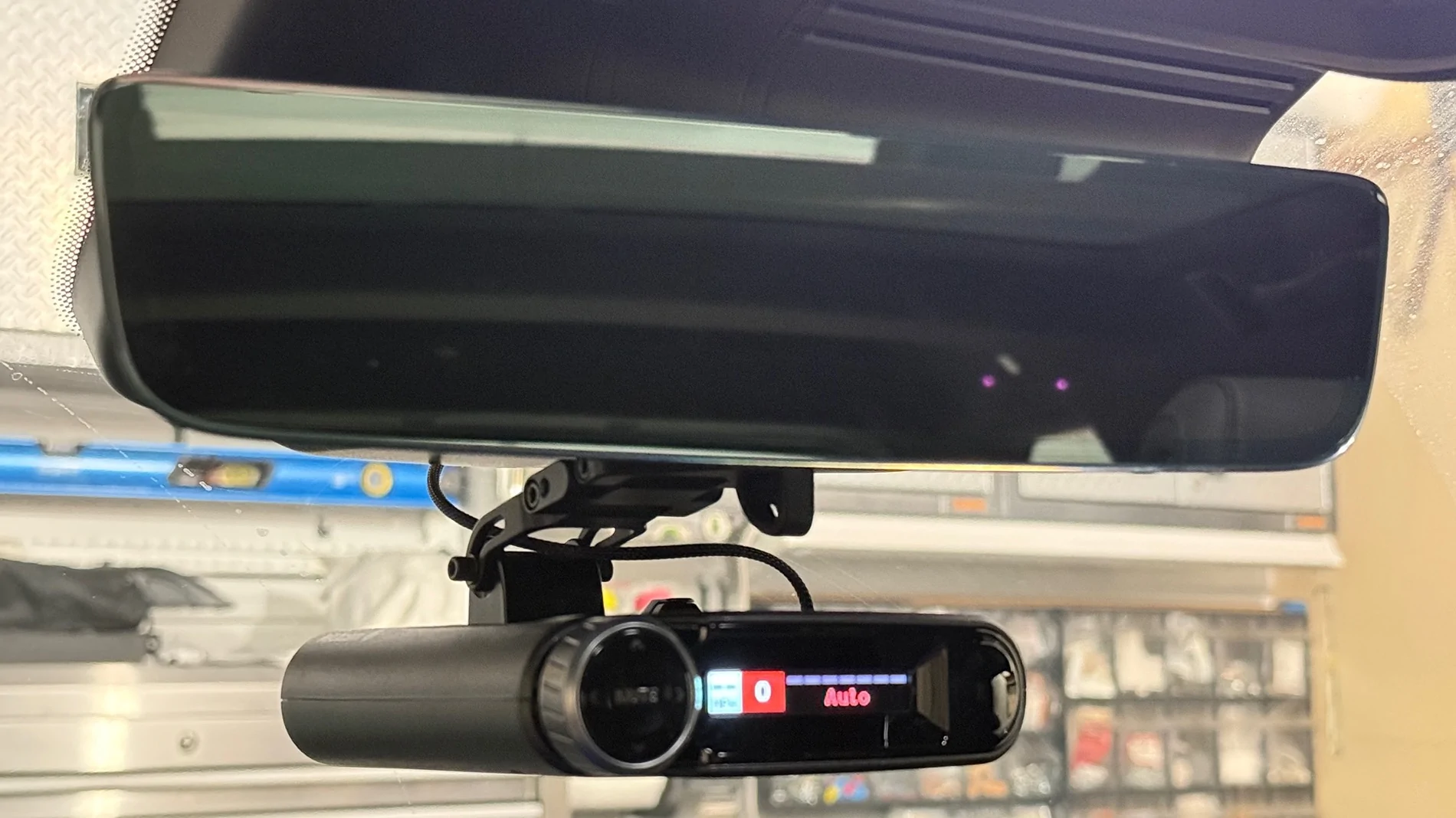

Interesting. Pic of the mounting location to the mirror?
I too have successfully installed the Blendmount 3032 in my 2026 R1S Quad. There is a larger opening behind the mirror where the stem enters the mirror. The 3032's clamp fits somewhat within that opening to allow the mirror to swivel without restriction.

For anyone following along, I measured my MirrorTap and can say, conclusively, it is the 15" variant.
I used it on the Gen1 and now the Gen2 with no problem.
Here are links to the exact one:
(manufacturer) https://blendmount.com/power-cord-m...amp-inline-fuse-with-military-grade-taps-kit/
(Amazon) https://www.amazon.com/MirrorTap-MTX-1015-Patented-Detector-Military/dp/B00L2SVV2U?th=1
This 14" mirror tap seems a little cleaner and I can confirm that it works great on a '26 R1S.
https://a.co/d/eMD16jm
The smallest one of the 3 included was what I used.
I used the Blendtech 3032 mount along with it. Overall, I'm happy with the setup. The detector could sit a little further back towards the windshield, especially as the R8 is a bit large. The removal of the mirror housing was easier than I was expecting. I did not use any tools to assist with removal and replacing it was also fairly easy. I did follow this video that was posted previously in this thread: .
Basically, after pulling down the front using the opening abutting the windshield, I moved my fingers back towards the mirror, and did a combination of pulling down, while levering against my fingers. Took about 2 minutes to get it off successfully.
