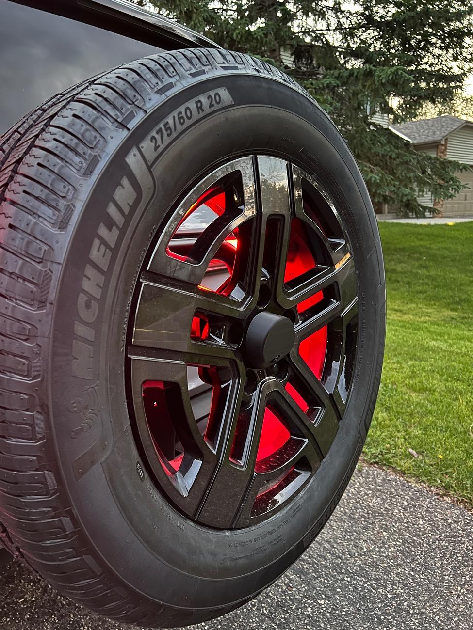

Looks like I just needed to press harder. The tolerance is quite tight which is likely a good thing.
Had a momentary scare initially when the software said there was a camera issue, but it quickly resolved itself.
My partner and I are very excited. Just in time for some camping and a long road trip. Thanks for getting the kits out so fast.

That looks awesome! I love the red glow from the tail light, very cool!
Yeah, I purposely designed it to have very tight tolerances because I wanted to avoid it from easily rotating (and ruining the view) and also to prevent people easily pulling it out.
Hope you like it!
(To remove it again, just pry from the bottom first using the right angle part of a panel removal tool, or a screwdriver, or similar)

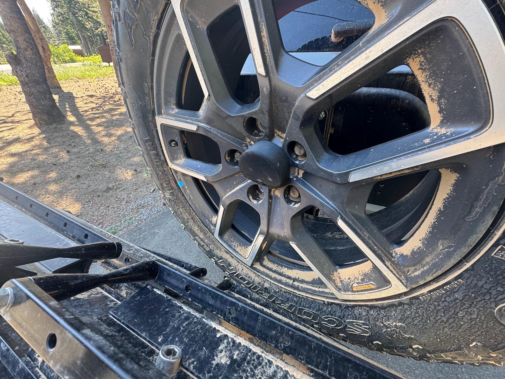

Here's a shot of the installed camera!
Rivian R1T R1S Rear Camera View Swingaway Relocation IMG_2161
s
Note that for clearance reasons my tire is at an angle (side to side). Which is why the rack isn't aligned with the tire
