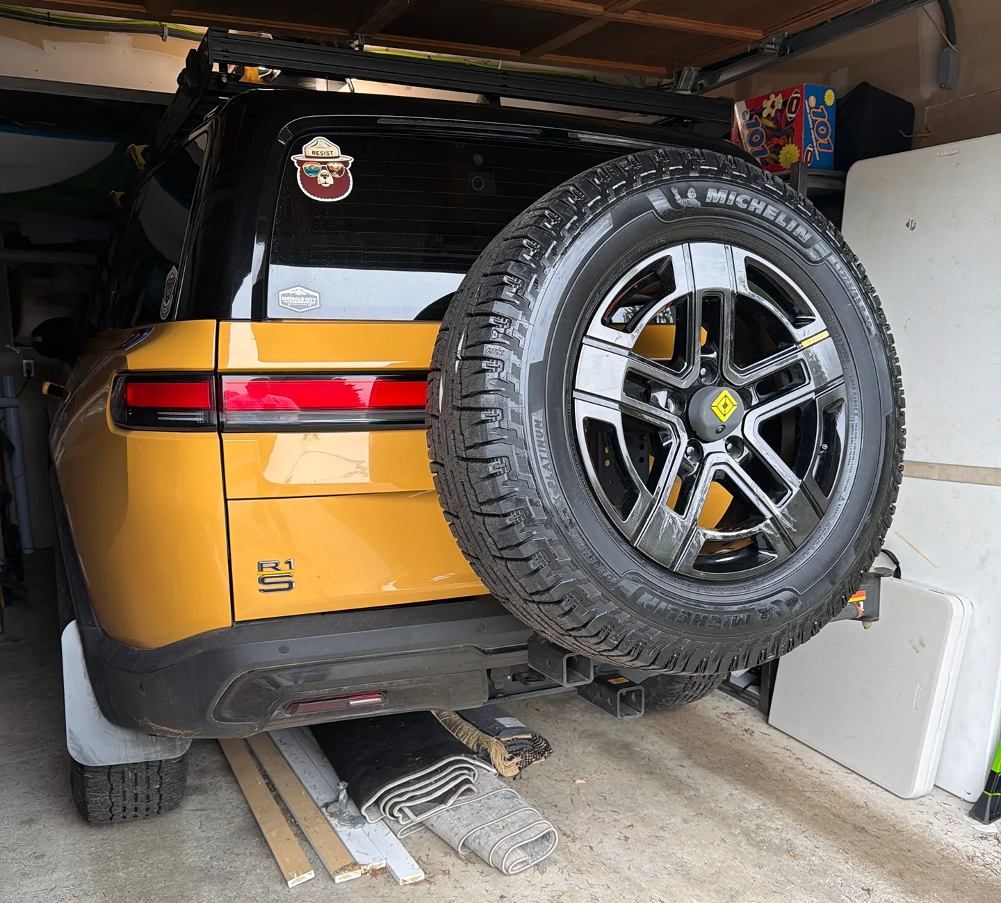

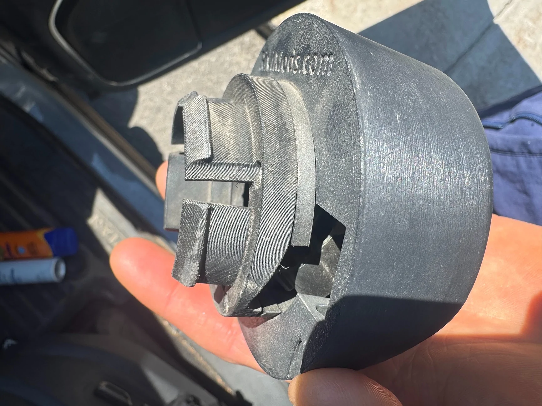

What material is the rear camera mount printed with? Mine seems to have warped over time (or maybe just over one really hot day?), and now falls out very easily. While originally a friction fit, the mount now slides in and out with little to no effort, and fell out while off roading yesterday. You can see in the photo that the prongs are now misaligned.
Rivian R1T R1S Rear Camera View Swingaway Relocation IMG_4047

Hi Sidney,
that’s no good! I believe a batch of Beta clips went out that were printed in PLA instead of the more temperature resistant ASA. The PLA is fine in moderate and cool temperatures but warps in the hot weather. I will DM you and send you a replacement clip ASAP.
Another thing to note is that some of the Rivian rims require a larger spacer on the back of the camera mount to clear the rim itself. If the mount doesn’t clear the rim then the clip doesn’t fit on all the way and the clip arms will see a stronger force on them which might exacerbate the warping issue.

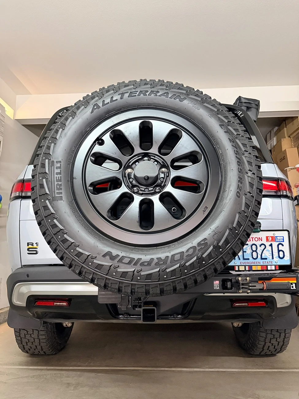

I am waffling between the Hitch-mounted (RiG’D) or the Spare wheel-mounted version onto an R1S.
Rivian R1T R1S Rear Camera View Swingaway Relocation IMG_5648
Is there an advantage for either one - maybe better camera view/angle because of location?

The center cap version matches the vertical height of the camera on the R1S better and the hitch mounted version is a closer match vertically to the R1T camera position. This does depend a little bit on how high the spare is mounted and the difference is relatively minor in the end result where the 360-view image stitching is better aligned. The only other benefit of the hitch mount is that it doesn’t need to be removed if changing the wheel for the spare.
Either of them work great for adding the rear view camera back which, for most people, is more than 90% of the actual practical issue. :)

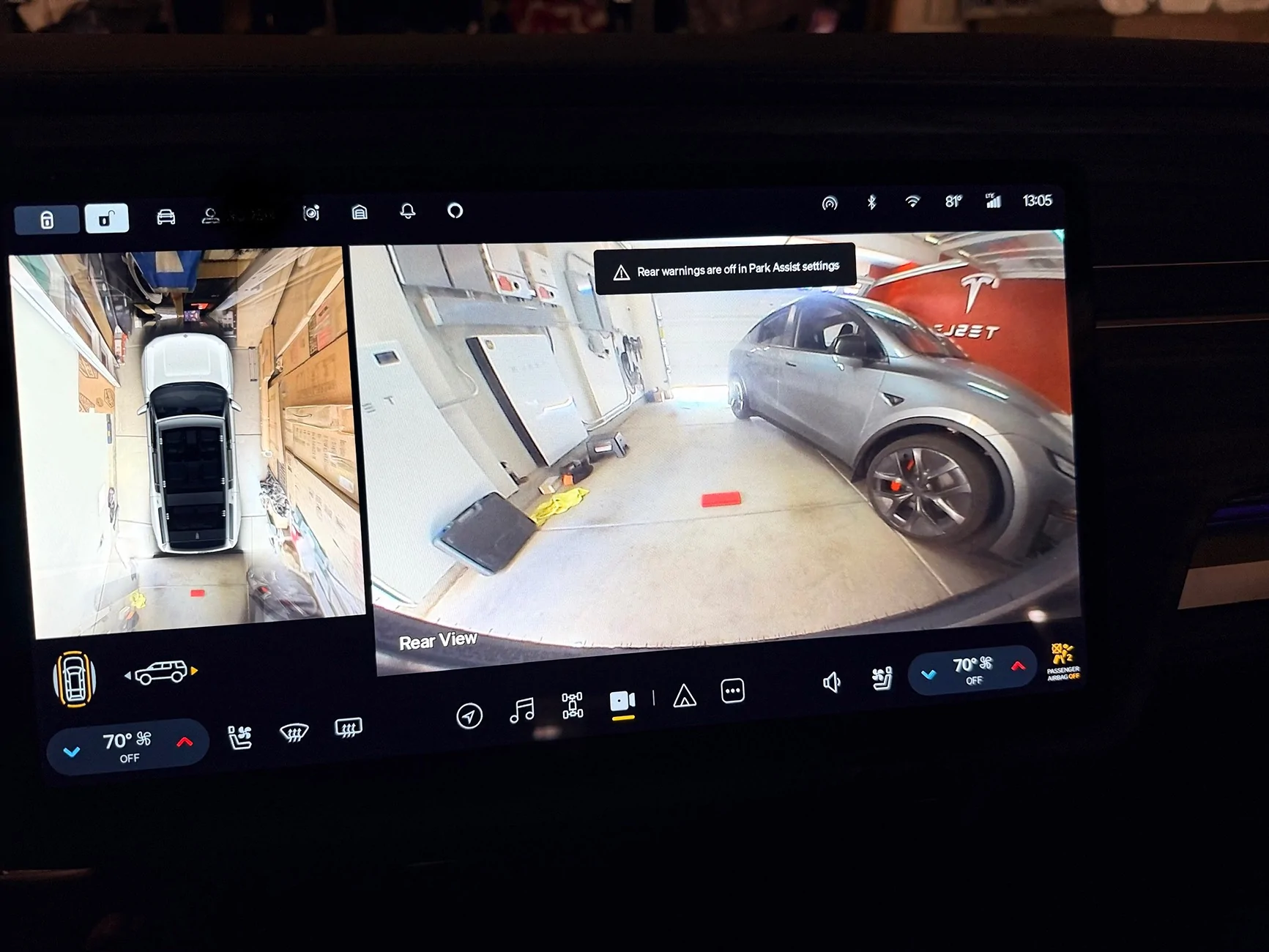

I’ve had mine installed for almost a year now - still going strong.
Rivian R1T R1S Rear Camera View Swingaway Relocation IMG_5353

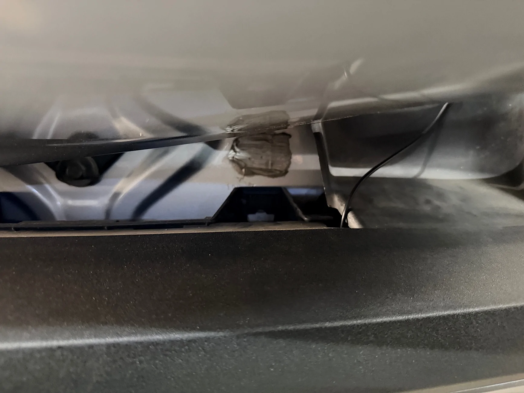

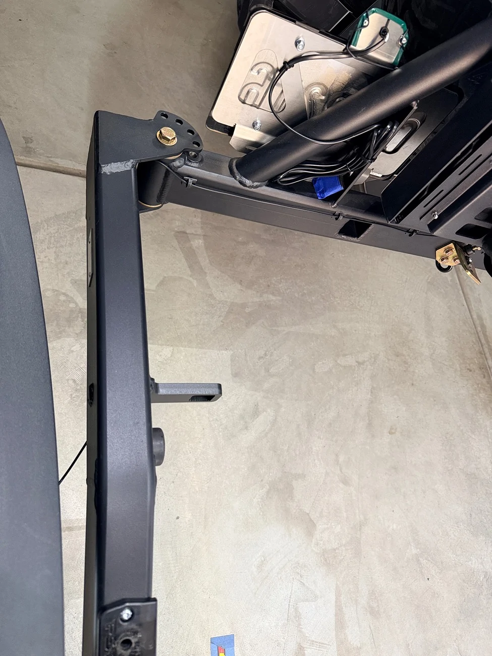

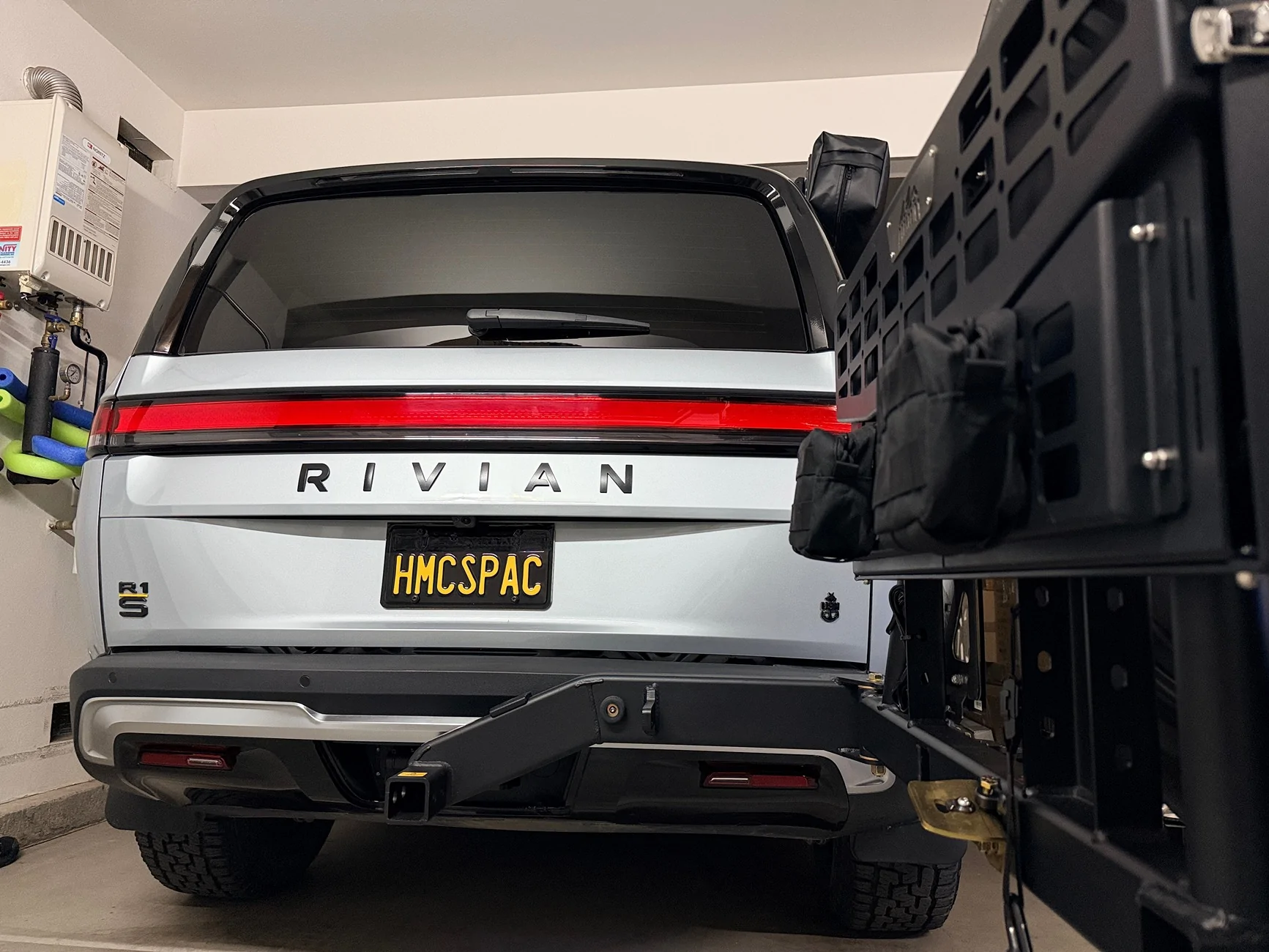

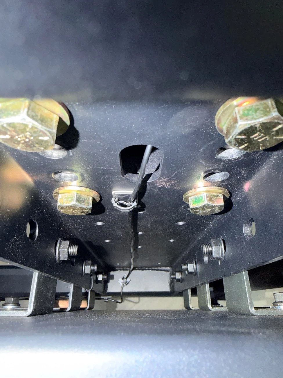

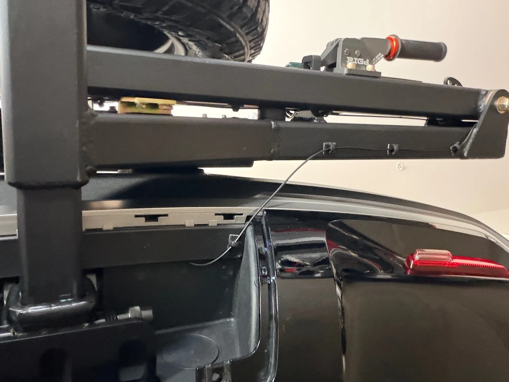

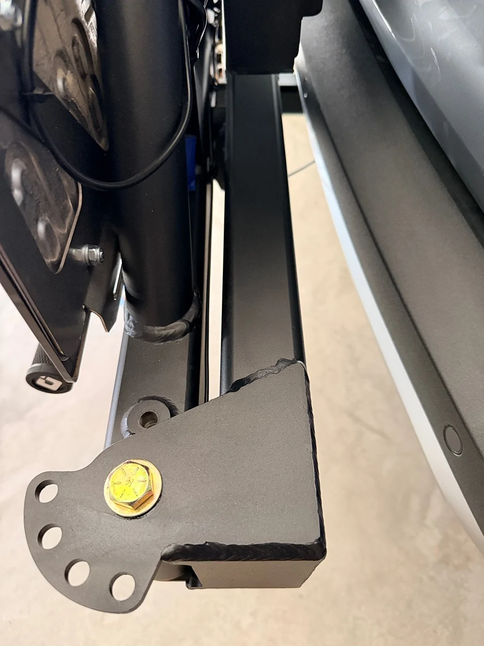

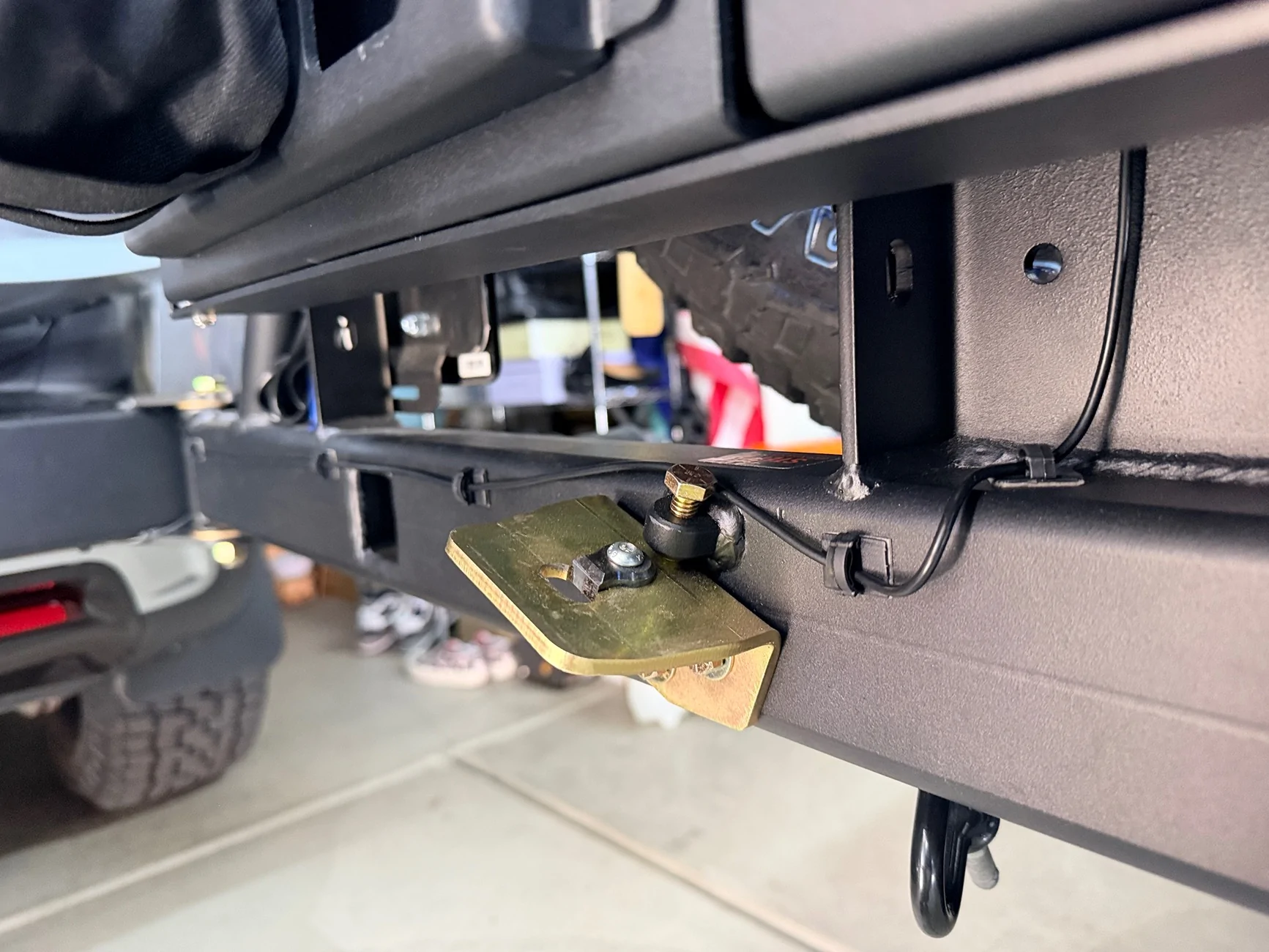

This kit is good to go 👍🏼.
I wish there’s an option to get longer (video) cable because I wanted to run from under the bumper and follow the hitch for cleaner install. An extra 2 feet of the video cable would have covered the whole run.
Rivian R1T R1S Rear Camera View Swingaway Relocation IMG_5772
Rivian R1T R1S Rear Camera View Swingaway Relocation IMG_5777
Rivian R1T R1S Rear Camera View Swingaway Relocation IMG_5773
Rivian R1T R1S Rear Camera View Swingaway Relocation IMG_5784
Rivian R1T R1S Rear Camera View Swingaway Relocation IMG_5782
Rivian R1T R1S Rear Camera View Swingaway Relocation IMG_5781
Rivian R1T R1S Rear Camera View Swingaway Relocation IMG_5776
Rivian R1T R1S Rear Camera View Swingaway Relocation IMG_5783
Looks awesome! Thanks for the photos of the install and for the feedback! I originally had just jumped the bumper instead of going down through the inside of the tailgate and out underneath like you did here. I moved mine in the end but I happen to have a slightly longer cable so didn’t notice the slightly shorter cable doesn’t make it all the way. I’ll consider packing some a couple feet longer in the future. I think your install still looks pretty clean even with the small jump. :)
Feel free to email me and I can see if I can get you a short 2foot extension if you want.
