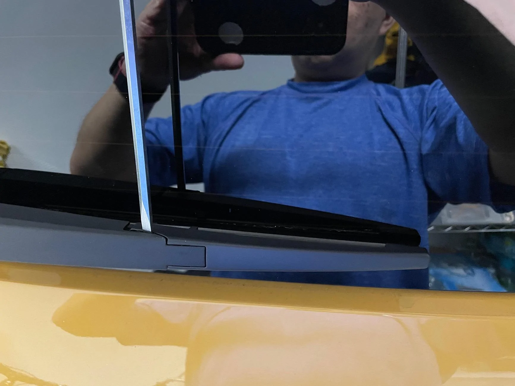

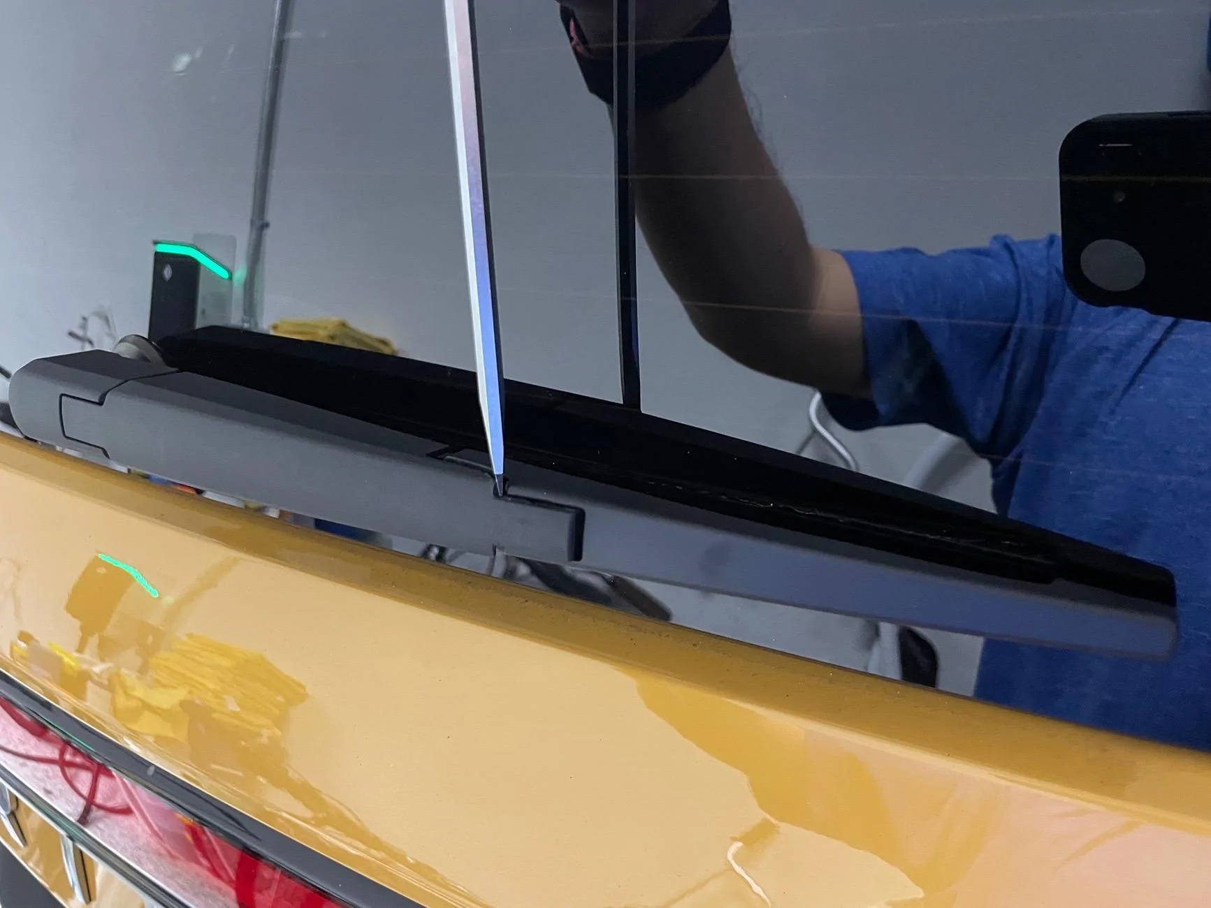

So I stumbled on this and hope it’s helps others. I left the arm on and placed a flathead screwdriver on the upper gap and turned 90 degrees. It popped off the bracket and then was able to remove easily. I attached photo of where I put the screwdriver
Rivian R1T R1S Rear Wiper Blade Service IMG_0387
Rivian R1T R1S Rear Wiper Blade Service IMG_0388

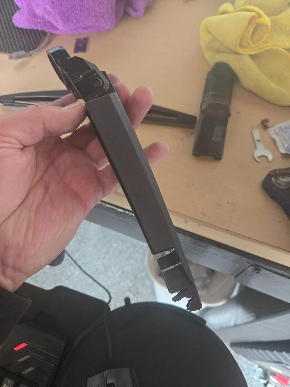

Tried this .method and I still managed to break it. Luckily I have a source that was able to get me a replacement arm.

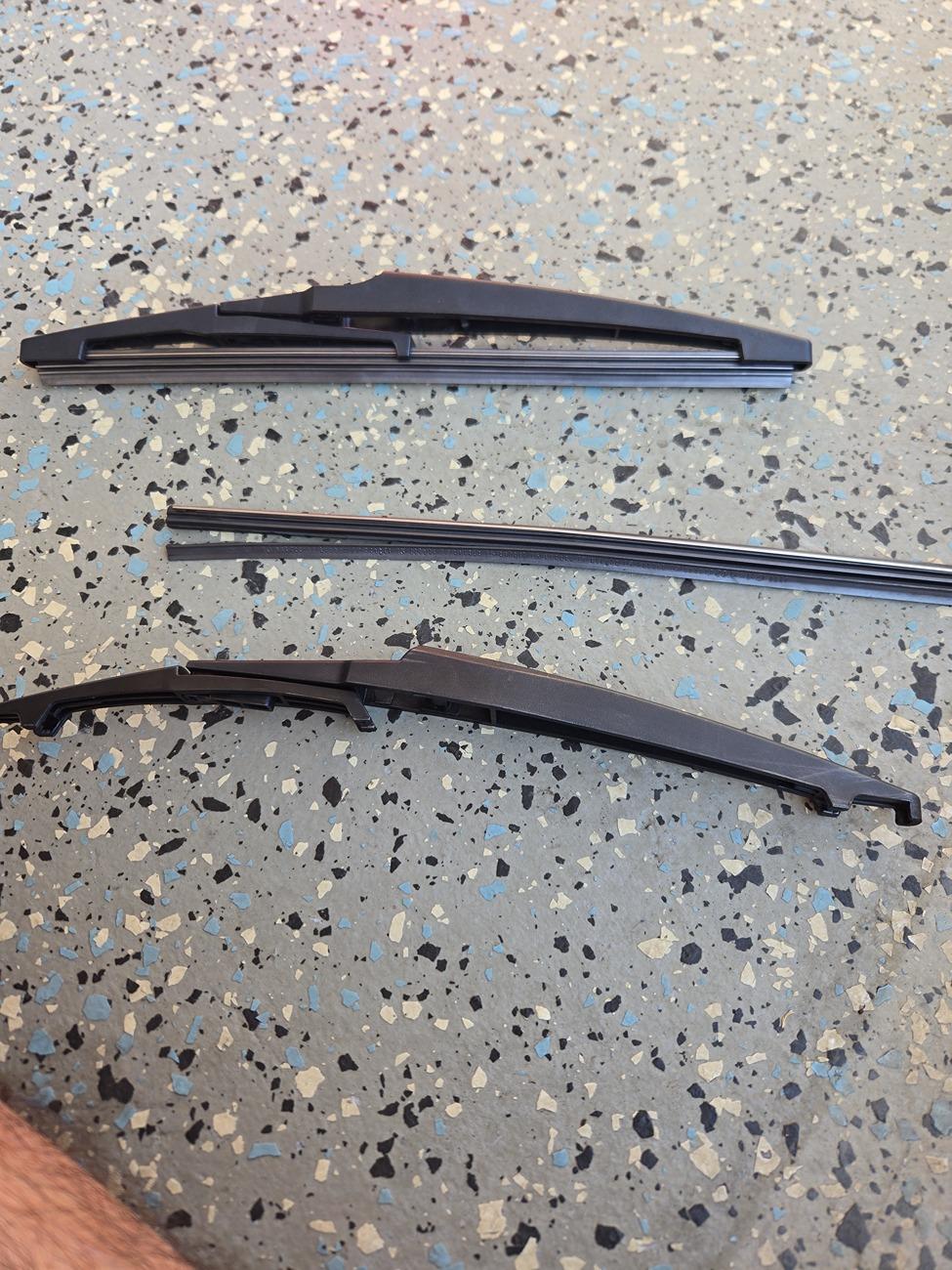

Also, the Trico 10A rear arm definitely doesn't fit, but you can pull the rubber blade out of the Trico 10A and swap it for worn rubber blade on your OEM wiper blade. Did this and it worked fine.
