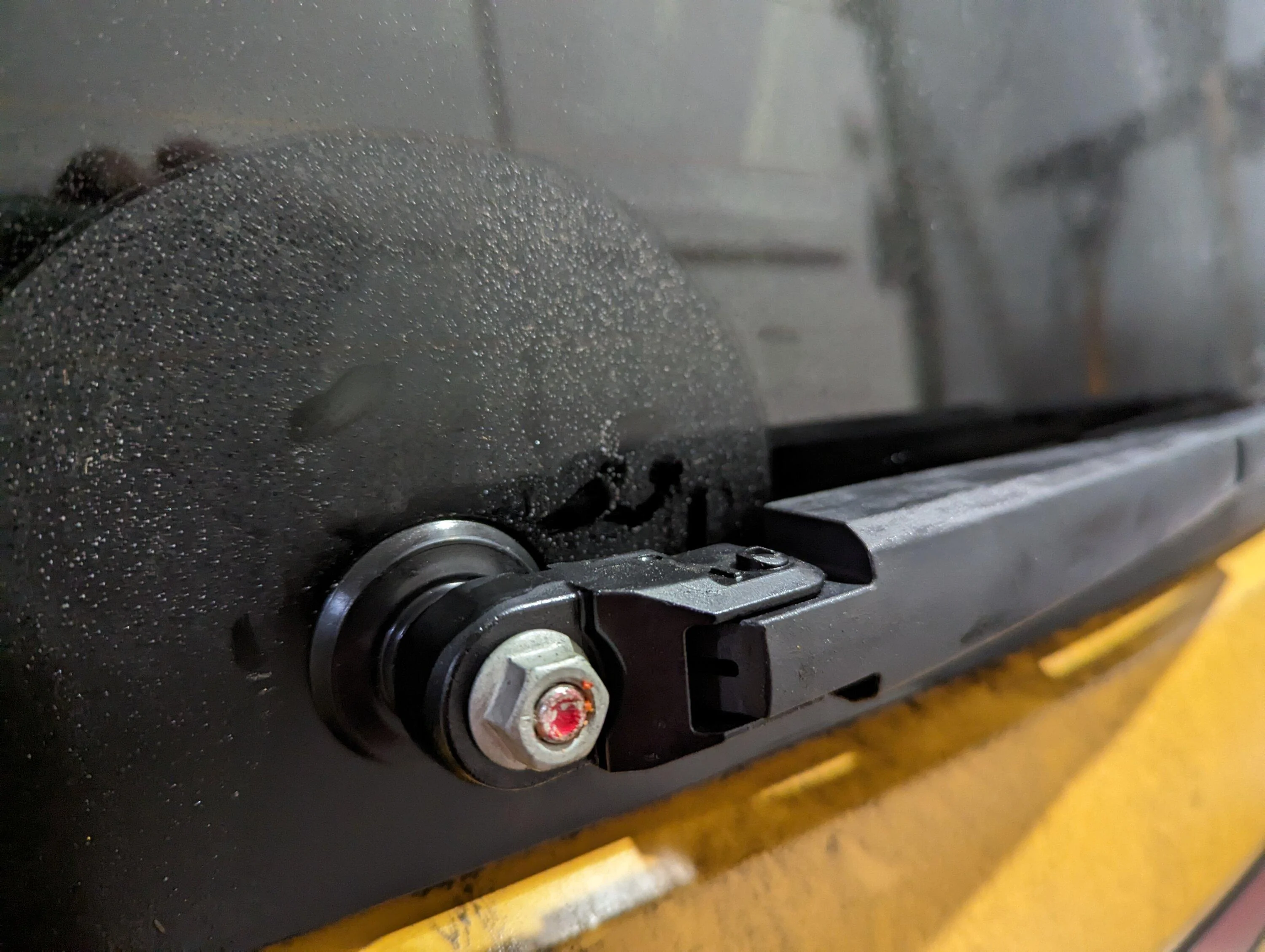

Perhaps you have to remove the bolt?
Rivian R1T R1S Rear Wiper Blade Service PXL_20240109_052018736

Thanks for the suggestion! I took the bolt off before posting this originally and should have share that and that’s where I stopped because it didn’t allow for any movement “off” the windshield for the arm but it does allow you to reposition the wiper (if for example it starts “drooping”). What is interesting (well I mean interesting in an very narrow way) is there seems to be a notch in the base of the arm right at the bolt that should be able to slide into space and allow the arm to lift. But it just stops after allowing the arm to rise just slightly instead of how we all think of it lifting up to allow you to easily slide on and off a new blade. What a strange thing! It’s basically the only odd thing I’ve encountered with this phenomenal rig :)

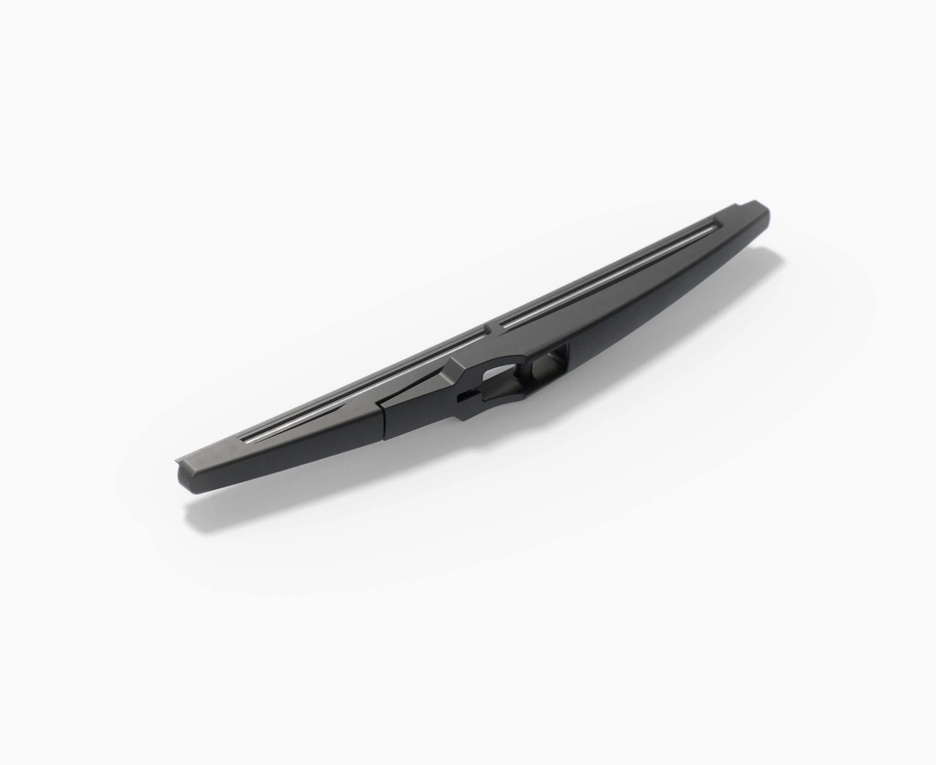

Now that Rivian sells replacement wiper blades, you would think they would be able to explain how to install it. Still just a link to the manual that says nothing about how to install the rear blade.
At least we know what it looks like now.
https://rivian.com/gear-shop/p/wiper-blades?sku=PROCHEA127
Ooo this is big! Yay! My appointment is in a couple of week so I will report back on installation process and whether this was a defect just in case people need to be on the lookout for an issue!

Looks like this design and it's possible the arm has to come off the spline shaft to rotate the blade. Would seem stupid but possible.

HOW TO CHANGE YOUR REAR WIPER BLADE FROM MY RIVIAN SERVICE VISIT ON FEB 9:
1. Remove the cap at the base of the wiper arm. This is a plastic fastener so just squueze and pull it off but be gentle not to break it. This will expose the locking nut.
2. Remove the locking not and unscrew it from the wiper - place aside.
3. Pull the entire arm off the glass.
4. With the whole arm in one hand quickly jerk the blade to separate it from the arm. This requires some blunt force to do. So don't be shy.
5. Replace with Rivian Rear Wiper Blade. I do not recommend using an OTC/Online substitute because of the strange shape of the interface with the arm. You can buy these rear blades from the Rivian online shop for $30.
6. Place the arm back on and ensure it aligned level, replace the locking nut to tighten (as you all know do not overtighten it), replace the base cap covering the locking nut.
If you have any trouble just reply and I can give more feedback. The Rivian service advisor agreed this is a very strange and overly complicated design. In theory you could do this without taking the whole arm off but he agreed there is a reasonable chance of damaging the glass or the arm itself when you make the hard pull. So remove the whole arm to be safe.

Seems like a design oversight that they didn't think about how to replace the blade while it's mounted on the vehicle. That being said, I don't think there is any reason to "jerk" it, I was able to unlatch the blade pretty easily by turning it like the above video, but there just isn't enough clearance to turn it enough and free it from the arm.
