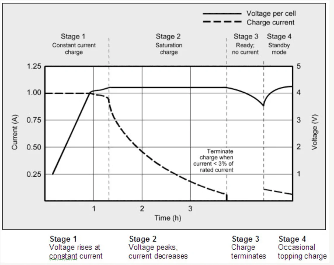

There's more to it than that. Rechargeable batteries have something called the C Rate (Charge Rate) that should not be exceeded or it will damage the battery. As the battery charges, the rate must be reduced. Those 4 Rivian motors acting as generators can pump a heck of a lot of power into the battery pack, easily exceeding the C Rate, so Rivian has to limit regen. The graph below illustrates a typical charge curve (dashed line). If the temperature is higher and the SOC is low, the battery can take a higher level of charge. If the battery is cold, or it has a higher level of charge, the rate must be limited so as not to dmage the battery.
