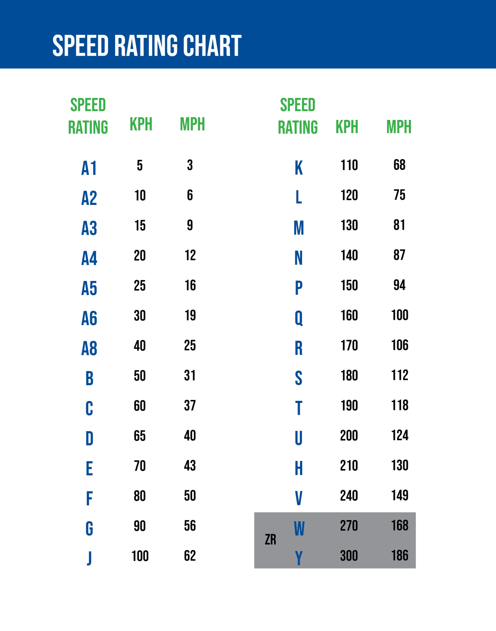

1: your ridge grapplers have a lower speed rating than the pirellis or others. Keep an eye out.
2: as others have mentioned, there’s a big segment for these tires - also stuff from BFG, General, Firestone, Bridgestone, etc. I’m planning to swap the pirellis for the Dueler A/T Revo 3 in this size, but I have other reasons for staying brand loyal.
How did you find the speed rating on the RIdge Grapplers? I'm looking on their website but do not see any specs related to speed rating.

In your table, the “Q” at the end of the size designation indicates a Q rating - 99mph.

You aren't gonna find any LT tires (that I know of) that will match the speed rating of the OEM tires. So if you're a speed demon who drives over 100mph...don't get em.

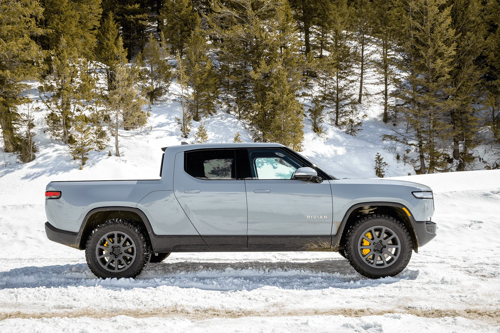

I have 6,500 miles on my Cooper AT3 XLT Discoverer tires. They are load range E and I have run them at 60psi cold (63-65psi hot) and they have worn perfect, ride great and look fantastic. At 60psi range loss is negligible and they are as quiet as the Scorpions.
Ran Toyo Open Country on my Tundra for 130,000 out of the 160,000 miles, but the Coopers are proven for me and I hope to get 35,000 miles out of them.
Those tires do look good. What kind of efficiency have you been achieving? I notice different wheels too, so that could impact it as well, but still curious.

The speed rating issue is something I'm trying to understand. It looks like the OEM Pirelli's have a speed rating of 126S. The Nitto Ridge Grapplers are listed as LT275/65R20 E 126/123Q on their website. Does this mean the speed rating is 126 for both?

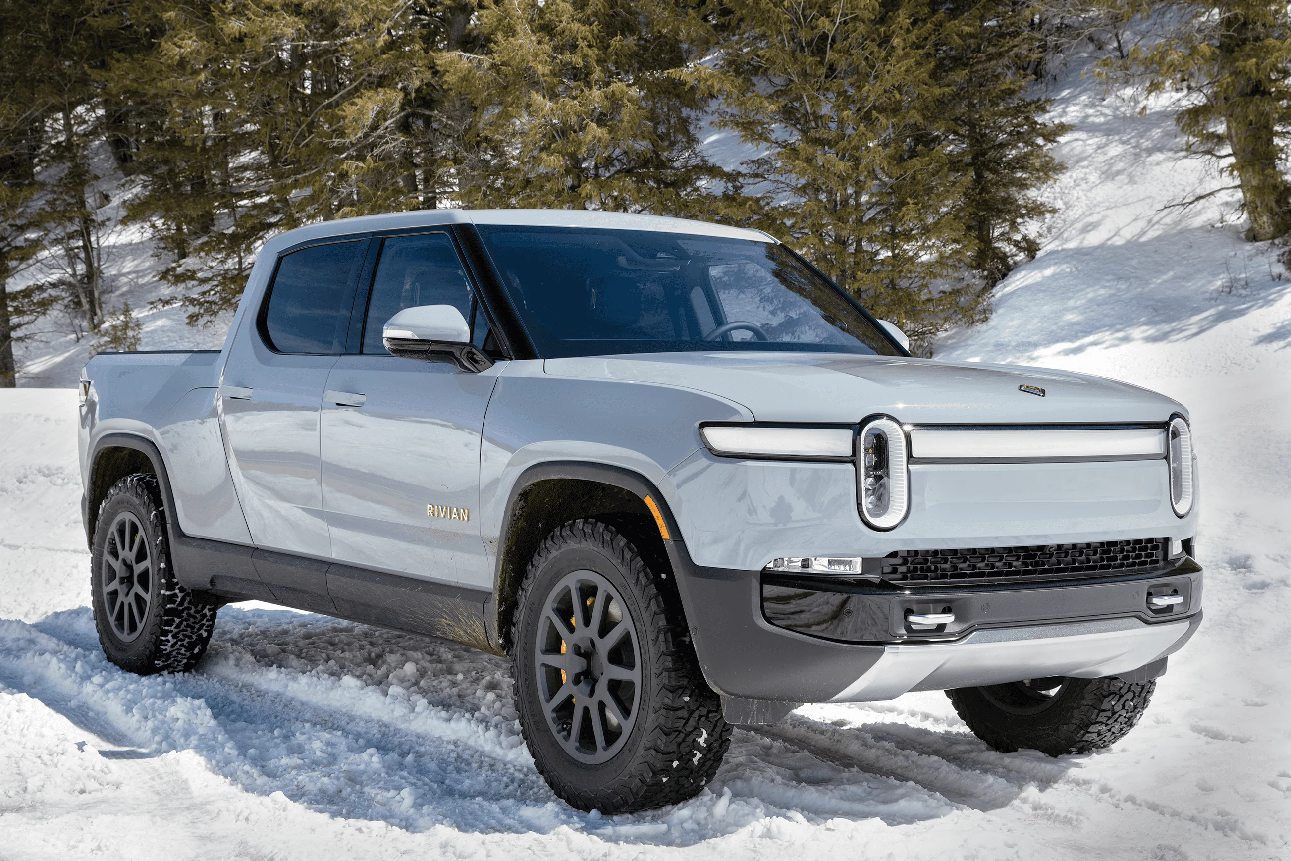

That looks good - how's ride, noise, and efficiency compared to the stocks?
The ride is awesome, and I don't hear anything on the noise end ( definitely nothing like a mud tire or Nittos), but I also am always listening to music loud. I purchased with the 22s and only had them on for about a week. My needs don't really call for tons of range, so I haven't paid much attention. All I can tell you is at 70% charge, it states I have 215 miles range.

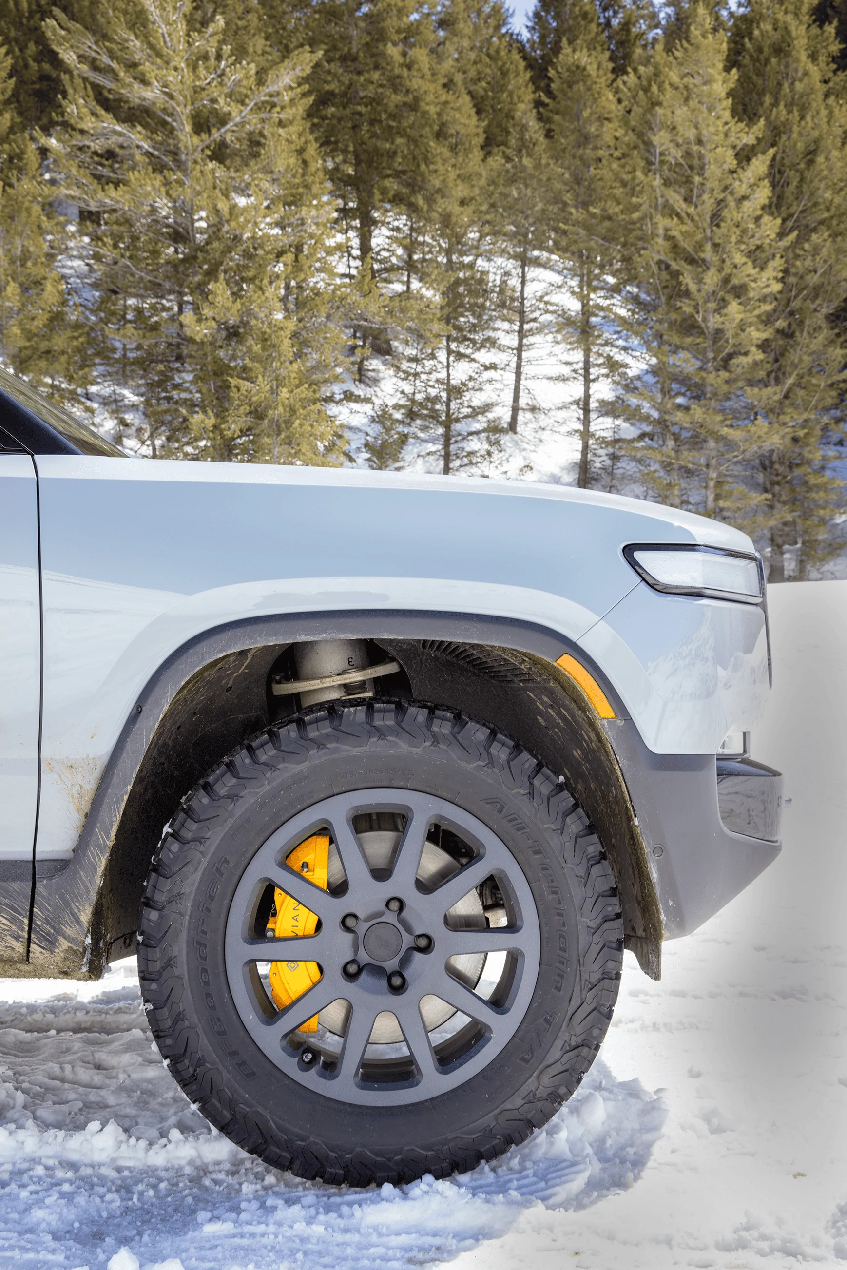

I just replaced my stock Scorpion 20" with the Toyo Open Country AT3. (With my daily commute on steep, curving mountain roads, and with my proclivity for accelerating hard and using High brake regen, the Scorpions were just about completely spent at under 12,500 miles.)
I definitely feel a sloppier difference in the driving characteristics, above ~35 MPH. Changing lanes at highway speeds I feel like I'm driving a boat; there's some "slosh" as I steer into the new lane, and more "slosh" after I steer back.
I haven't noticed a problem with the noise, I like the way these look, and I hope they'll work better during the snow this Colorado winter. But the AT3's definitely don't feel great. The Scorpions made me feel solid even at max speed (which I should never have been driving); with these new ones I'd be hesitant to change lanes above 80 MPH.
Update: I had the tires inflated to 45-48 PSI. I have since pumped them up to about 65psi (tires are rated to 80psi) and much of the sloppiness and slosh is gone. Launching I still feel them pulling me left and right on the road, but for general driving I'm much happier now.
