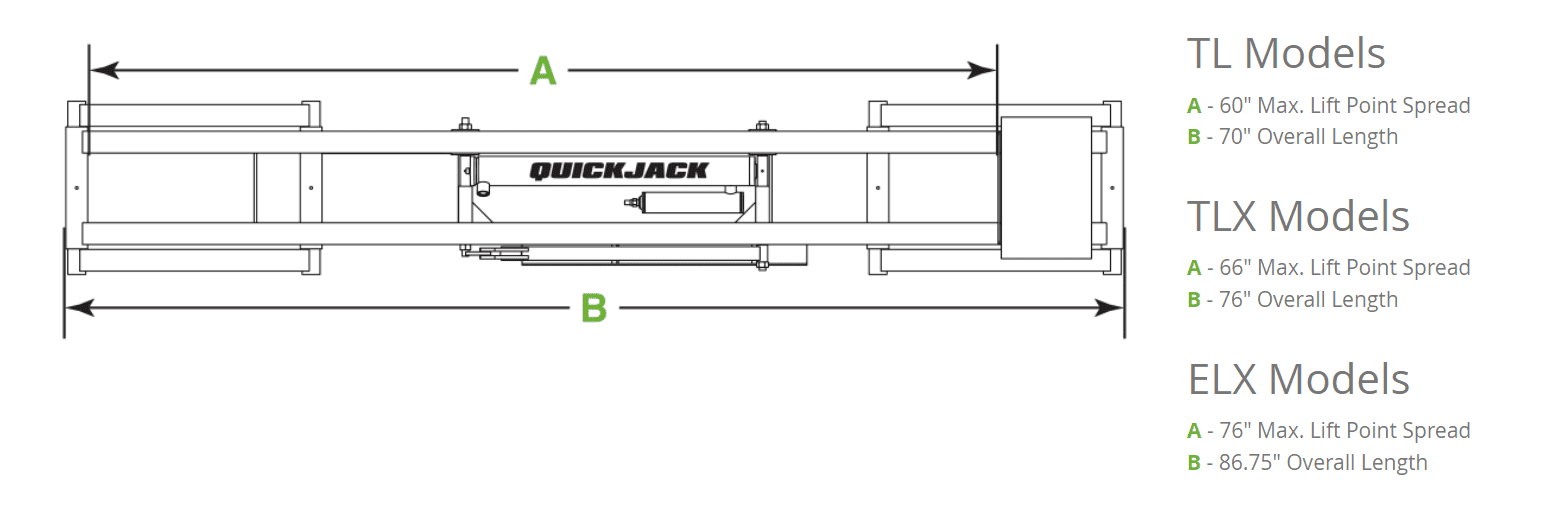

Also have the quickjacks 7000SLX that I use for all of my ICE cars, but still not sure how I will lift Rivian R1S when I get it. When my neighbor brings another tester, or he gets his R1, I'll take a better look underneath.
The TLX won't work on the R1 vehicles. The distance between the jack points is too great for any QuickJack. The jack lift points pads have a front to rear spacing of 86" on the Rivian.
The ELX Quickjack may work if you take off the plastic panels because it has a 76" max lift point width.
Rivian R1T R1S Rivian and jackstands quickjack lift points
I have a Quickjack TLX and it's lift point spread is only 66".

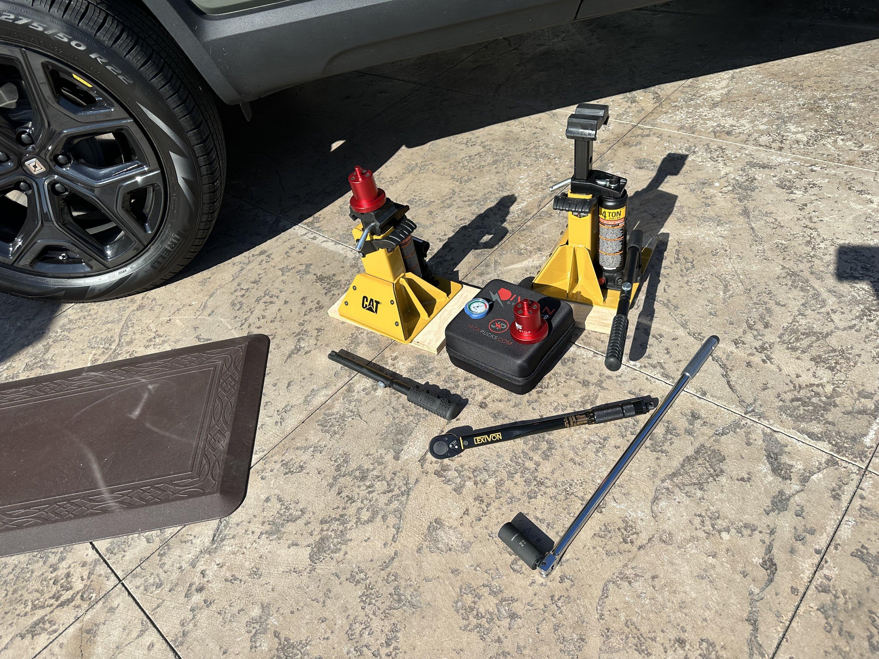

Does anyone know if the R1 have front/rear center jack points? wondering how you can use jack stands without having those to use to lift the vehicle using a jack.
7,445
12,750
I use these combo Jack/jackstands, they seem to be out of stock currently but there are other brands.
