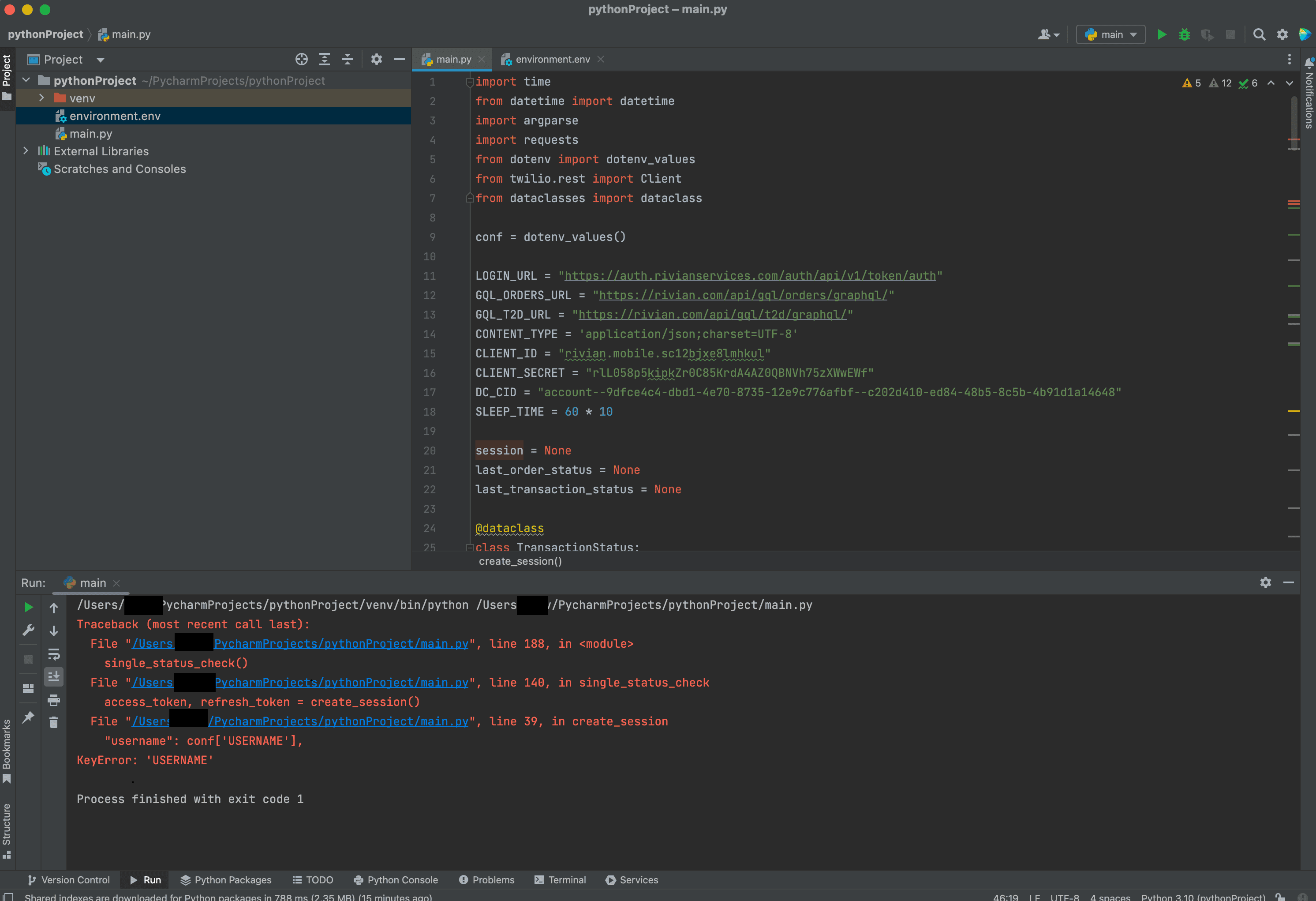

Python experts - running into this error after loading into pycharm. I've enabled the .env with my credentials. Any thoughts or guidance?
thanks!
thanks!
EDIT: Last post was before I found the source code..
Have you run through in debug mode to see if the dotenv_values are loaded into conf? Make sure that you place your username and password in quotes?

Looks like it is not loading your `.env` file. Check that it is on the same directory as your script. But it might be that pycharm is running the script from another location, possibly your home directory and the `.env` needs to be there instead.

The .env is in the same directory and the credentials are in quotes. Not sure where/why it's failing.
As a temp workaround I just wrote my credentials into the script. See any harm in doing so?
I recognize that code (disclaimer it's mine ;) ).
Try renaming `environment.env` to just `.env`.
No dice. Might be a Mac thing, but it doesn't see the file as just .env. In Finder it moves it to a hidden file. When mapping to it PyCharm Config it showing up to connect it.

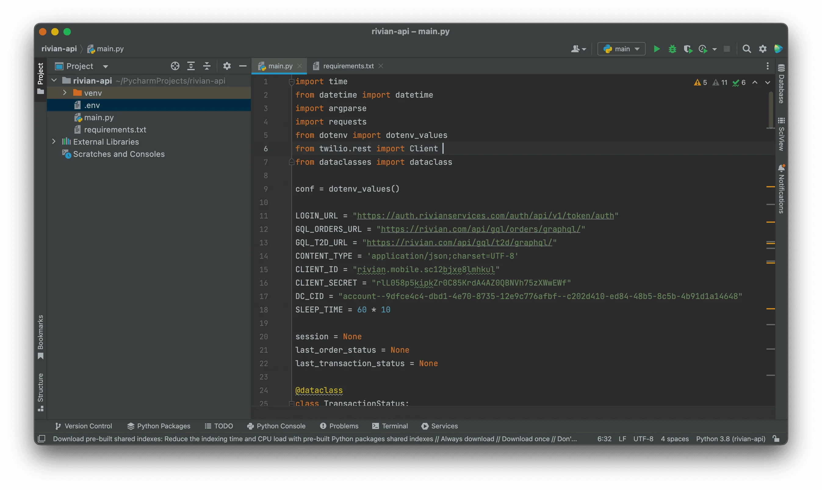

Here's a screenshot of mine (Pycharm on Mac):

`.env` is the default filename that the dotenv library will load. If you rename it to anything else then you need to change L9 to something like `conf = dotenv_values("environment.env")`.
That fixed it! Gracias sir!

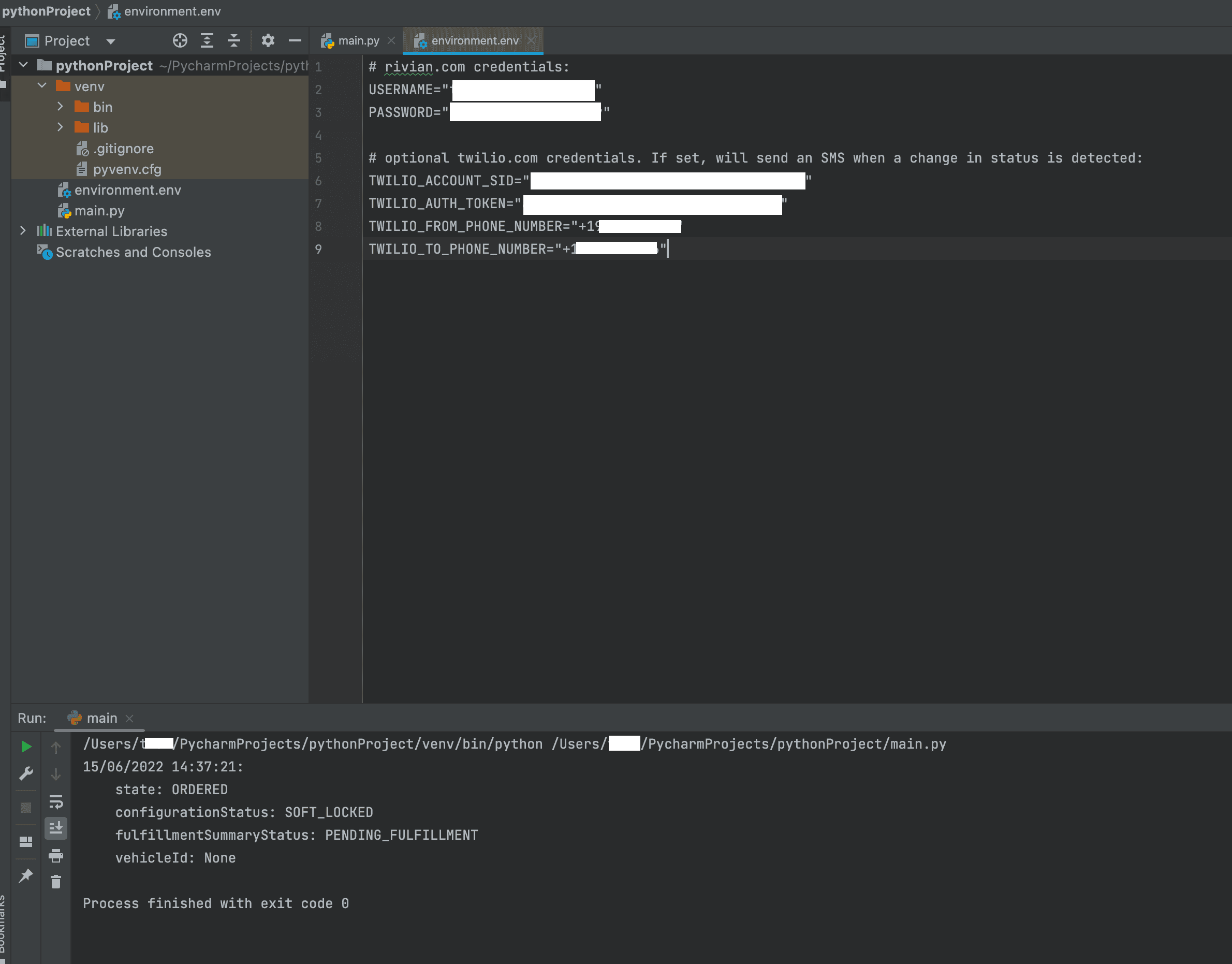

Rivian R1T R1S Rivian API Screen Shot 2022-06-15 at 2.39.10 PM
If my questions are annoying due to lack of knowledge feel free to tell me to F off.
Got the Twilio info added. Will it only text if something changes? And is it watching for all the fields?
I used to have a vehicleID but it got null'd out last week. Eager to see something show up there again.
yes and yes. It simply compares the full json response to its last known one, and if Theres a difference it will text the full latest response.
