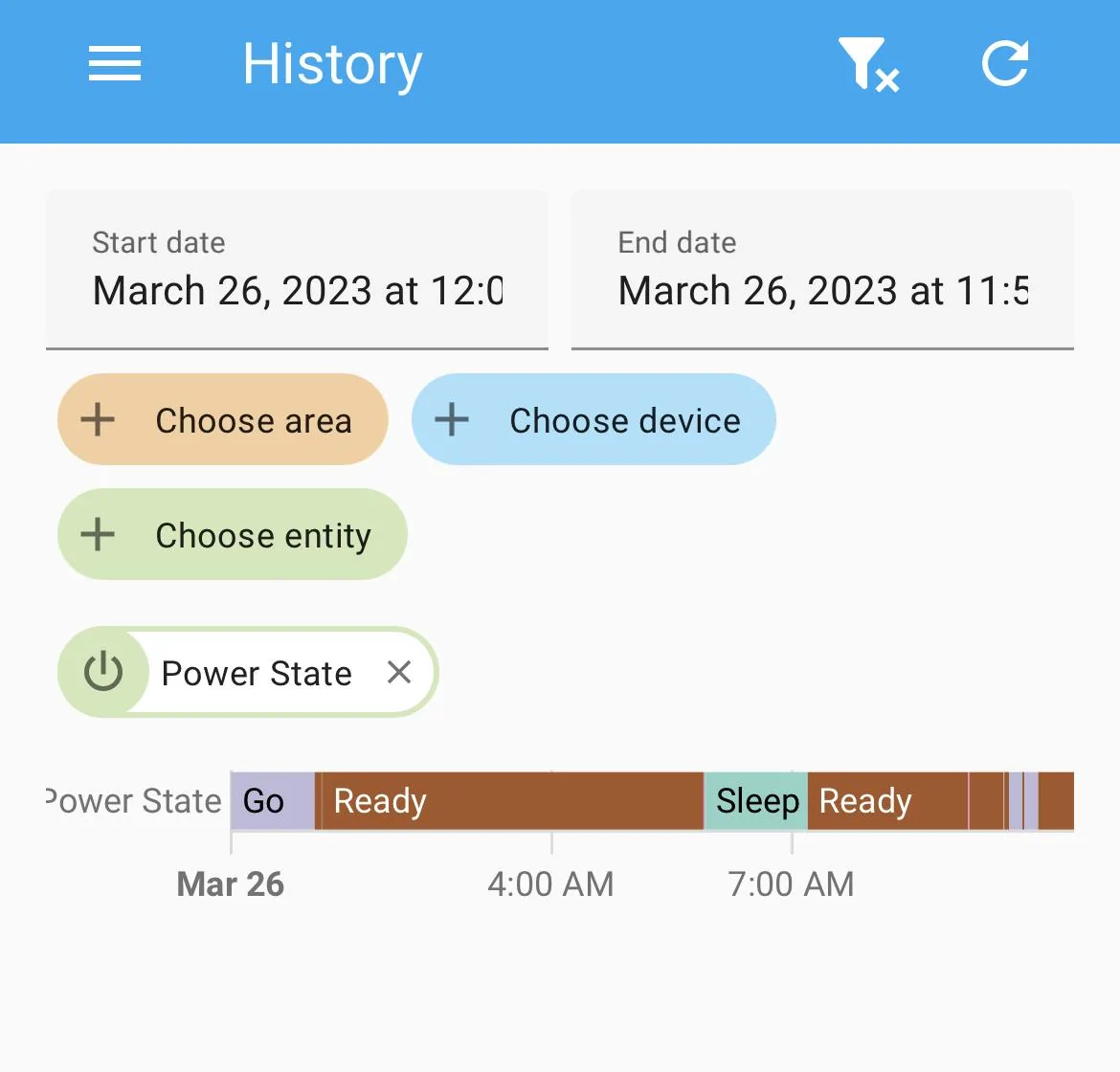

Currently playing with polling to see if it keeps the vehicle awake etc. If anyone has studied this please let me know.

It doesn’t. Vehicle uploading to the cloud is independent of you querying.
There are definite sleep times. Sometimes you open the Rivian app and it indicates the car is sleeping and other times it doesn’t. The api also returns a sleep state when it’s sleeping. So there is a time (like Tesla) when the car is sleeping to reduce phantom drain. The algorithm on the Tesla is pretty well known now. Im trying to figure what Rivian is doing. So far it looks immature.

After a few days of poking at it it seems the API has no impact on sleep. It does what it does regardless of passive API pokes. Active API pokes (wake, open frunk) are a different story but require you to take up one of 2 precious phone slots for API use for active commands due to the way they cryptographically sign those. They should allow more than 2 phones anyway.
