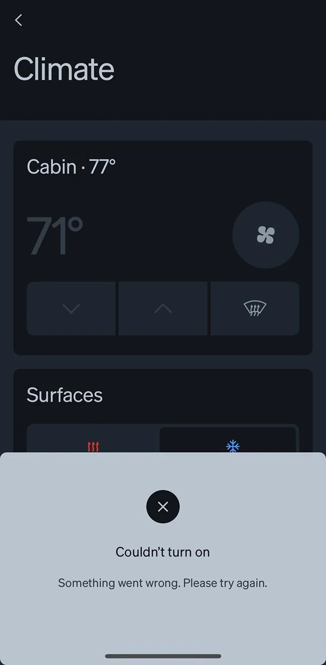

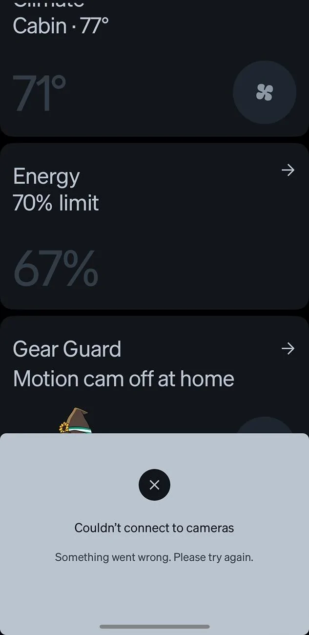

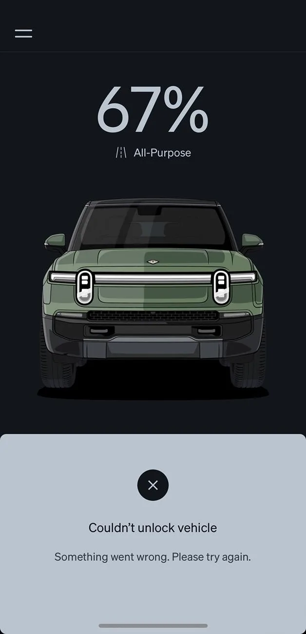

So ever since I updated the software to 2024.39 before the Halloween mode was turned on, my Rivian phone app has not been able to connect to the vehicle. I have not been able to lock/unlock or turn on climate remotely. Gear guard live cam doesn’t work either. It does update the batt % left and location of the vehicle so it’s not completely disconnected. It appears that maybe the app cannot wake the vehicle up. I tried uninstalling the app and reinstalling. Deleting my phone key and reinstall it, software and hard resetting the vehicle, resetting my phone and still having this issue. Even with my wife’s phone which is a different model than mine, I still get the same errors. This makes me think it’s not a phone or app issue but the vehicle or the cloud. Even updated to 2024.39.31. Problem persists.
When the car is awake ie by proximity unlocking, I can control climate, gear guard, etc on the app again. Cell signal on my phone and vehicle are both good.

Rivian R1T R1S Rivian App cannot wake up Gen 2 R1S after 2024.39 update IMG_6897
Rivian R1T R1S Rivian App cannot wake up Gen 2 R1S after 2024.39 update IMG_6896
Rivian R1T R1S Rivian App cannot wake up Gen 2 R1S after 2024.39 update IMG_6898
