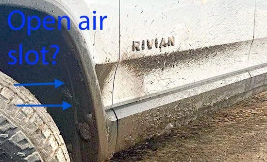

Look at the mud collecting on the ridge of the door and the flare of the rear wheel. Is this going to be a problem long-term? Will the mud act like sandpaper over time, wearing down the paint in these areas?
EDIT: According to AdamsFan1983, below, "There is factory applied ppf in most of not all of the areas your mention."
Yes, it's absolutely intentional as that hole relieves air pressure within the front wheel well and allows the air to stick if you will to the side of the R1T improving aerodynamics. Lots of wind tunnel time was put into this truck.

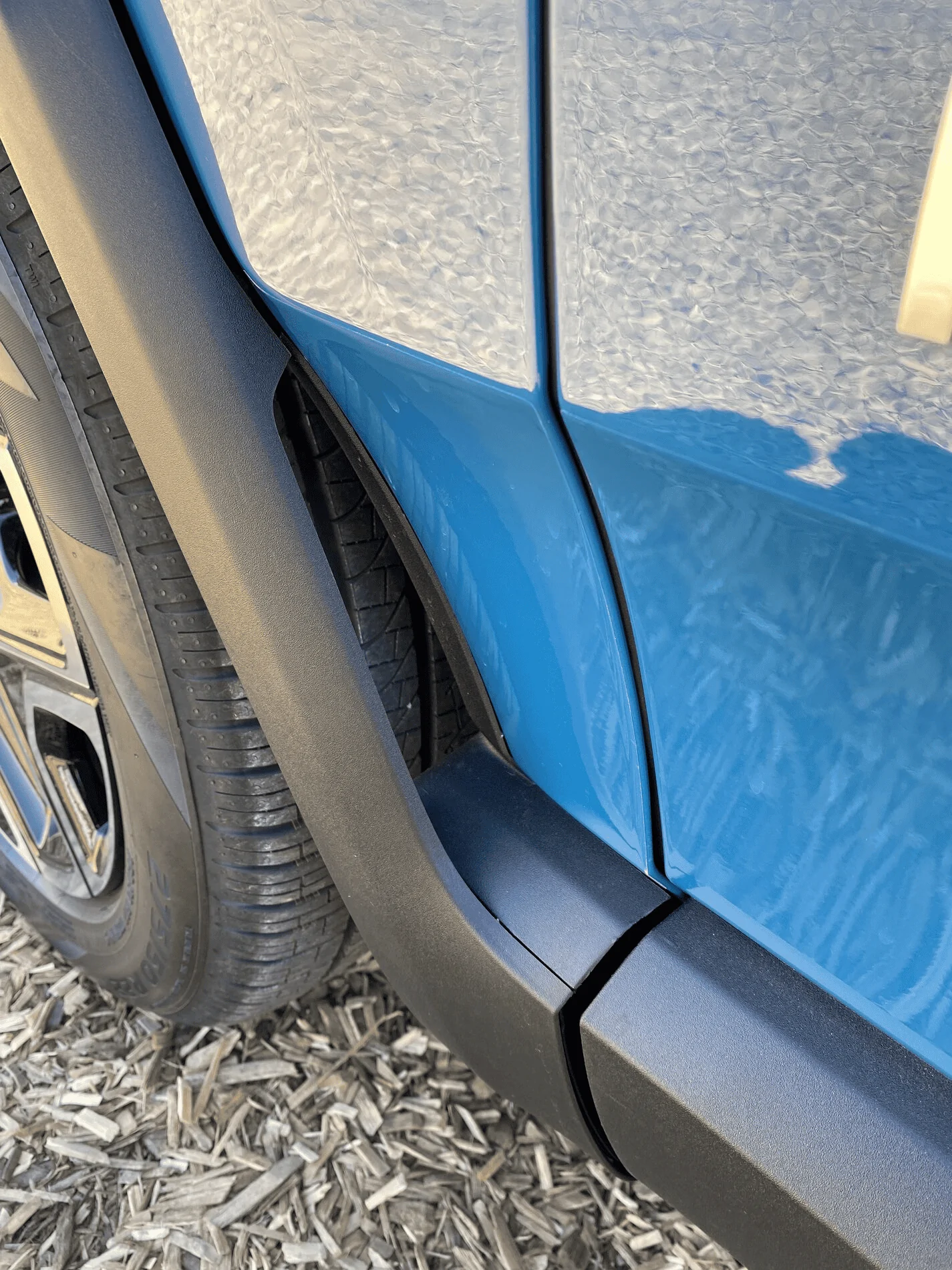

Wait a minute... Are you telling me there's an open-air slot in the front wheel well? I started this thread thinking the mud was just coming up from the tires outside the body. But it sounds like a few of you are saying there's a large gap in the wheel well right in that spot.
I haven't seen an R1T in person and only joined the forum last September. So perhaps I missed some earlier discussions of this.
I've blown up the photo. Is the hole accurate to how it seems here? Perhaps 6-9 inches and pretty open?
Rivian R1T R1S Rivian Body Design Flaw? 733703D8-02FD-4F72-930D-751EA97C2A6A
slawwach
Nov 17, 2020
150
226
TN
Jaguar I-Pace, Hyundai Santa Cruz
Correct. You can see it on the photo bellow. People say there used to be a screen there in preproduction models, but Rivian dropped it for some reason.
Rivian R1T R1S Rivian Body Design Flaw? 1642446895358
Rivian_Hugh_III
Rivian_Hugh_III
Oct 4, 2021
893
1,429
Midwest
2008 Infiniti EX35
? So there's a massive gap in the wheel well! What in tarnation were they thinking?
Look, if Rivian has installed factory PPF in that area that will hold up for the *lifetime* of the vehicle I guess I'm okay with it. Obviously it'll make a difference for range and it may make the truck look more awesome, as I presume there will *always* be a dirt blast along that part of the body, if only from a mud puddle somewhere.
I suppose we must put our faith in Rivian Central. They've been driving these bad boys for years now in all kinds of conditions. Putting a hole there wouldn't be my first choice, but I'm going to take a deep breath and figure they're on top of it.
But seriously? a hole in the wheel well of an off-road wonder that leads directly to fresh paint across the entire body of the vehicle? ?
