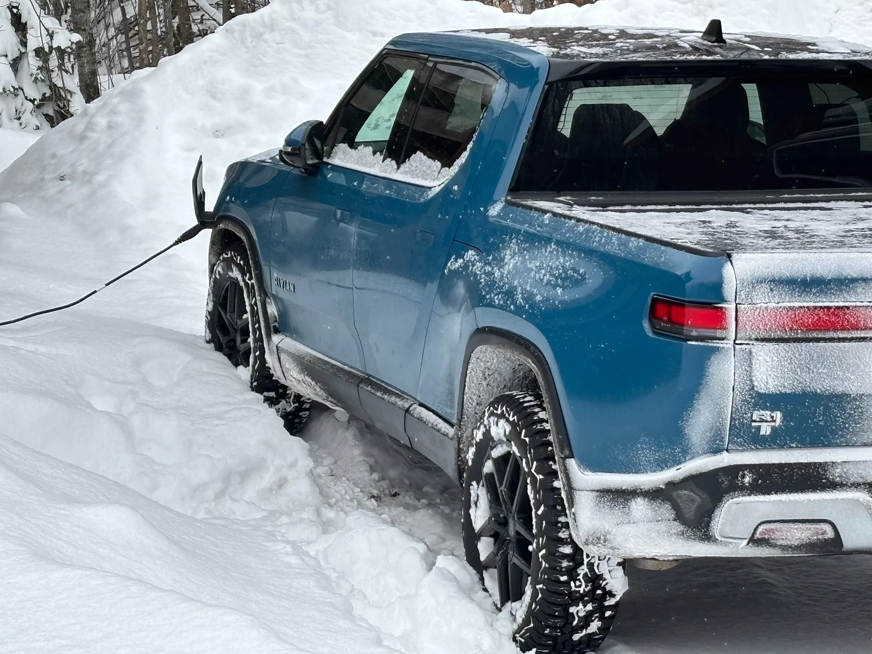

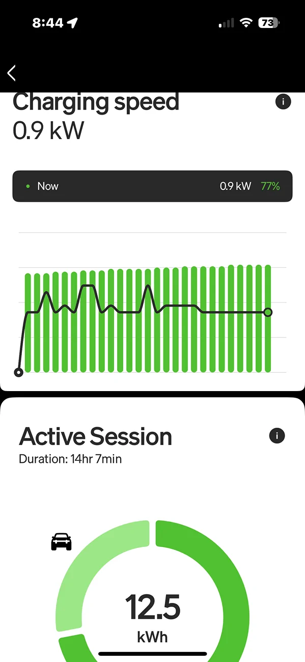

Don’t write off the usefulness of Level 1 120v charging. We are currently in the upper peninsula of Michigan on a ski trip. Using a 120v outdoor outlet at our VRBO. Added 7% to the battery overnight. Over the three day stay it will add up. And, it keeps the battery warm for better efficiency when driving.
Rivian R1T R1S Rivian in cold weather IMG_5245
Rivian R1T R1S Rivian in cold weather IMG_5246
Yes, always keep it plugged in to something. I forgot to mention that.
