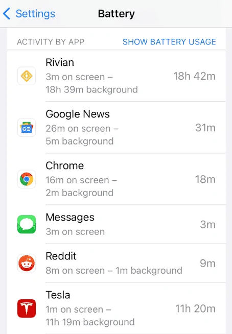

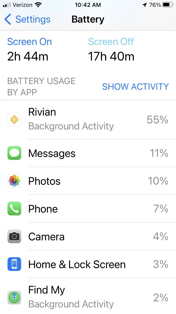

Has anyone who's had a delivery noticed high battery usage by the Rivian iOS App? Disabled access to location when not open which seemed to help slightly, but I'm still running close to 40% over 24 hours.
Included a snap of the Tesla app for background usage comparison.

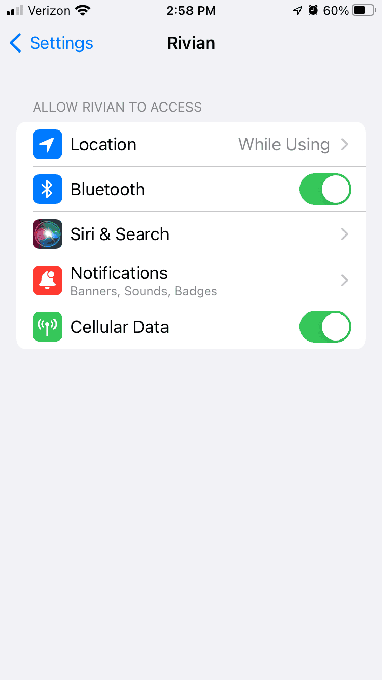

Mine is identical except I changed location to "While Using" to see if that would help the issue.
Fascinating. I'm pretty surprised they implemented this without Bluetooth or Background App Refresh permissions.

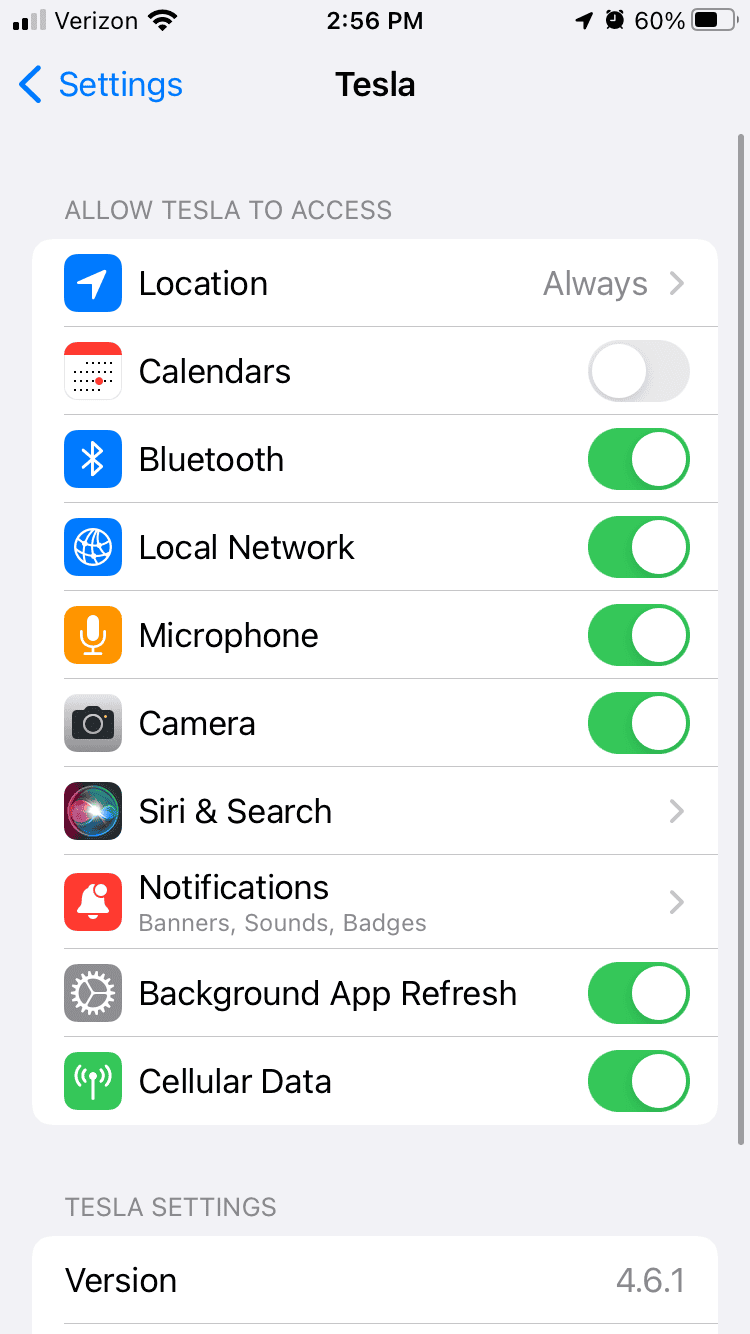

That's very fascinating, here are a few pics. You're right, the background app refresh is missing... Sorry I missed the bluetooth one being different from yours. So that means they're using the app to actively hit the car in the background vs using background app APIs? See Tesla screen for reference.
Yeah, I have a Tesla so that was my point of comparison as well (I’ve also owned chunks of popular mobile apps in the past so I know a bit about the domain). It does seem like paring the car added Bluetooth permissions to yours at least. I was really confused how it would work without that.

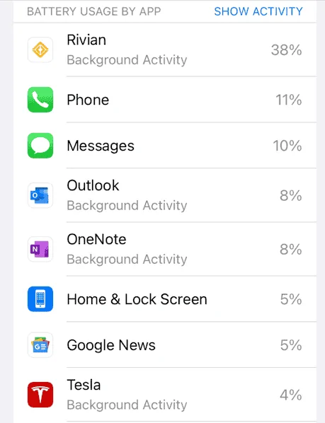

Out of curiousity… are you close to your truck where you work all day? I have a theory on the battery life.
Yes, very close to it throughout the day. Far enough for it to stay locked but definitely only a room or so away. I'm also that same distance from the Tesla.

With the truck at the shop, the Rivian app doesn't even register 1% battery usage on the iPhone.
It's definitely the bluetooth attachment using the most battery. Seems like they need to dial back the communication between the phone and the car.
I'd say for anyone far away from the truck most of the day, this will not be an issue. For me, 4 rooms in my house (which happen to be the rooms I spend the most time in) are too close to the garage to disconnect bluetooth from the vehicle and it's radios (I'm told there are many).
I was going to try and confirm... but this was my suspicion. I'd guess they are using the Bluetooth connection to keep the app running in the background for vehicle status sync or something.
I am having a similar situation.
