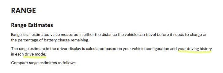

The little mileage number on the driver display is the "guess-o-meter" and as others have said, it it a general prediction of how far you can drive on a charge. It takes nothing into account other than state of charge.
No - it takes into account the drive mode. Switch between All purpose, Sport, Eco, Offroad, etc and the driver display range number will change significantly.
The manual also says that the driver display number takes into account recent driving history. But I have seen no evidence that it actually does this.
I believe it will if you are typically exceeding the base rating. Not for coming in under it though.
