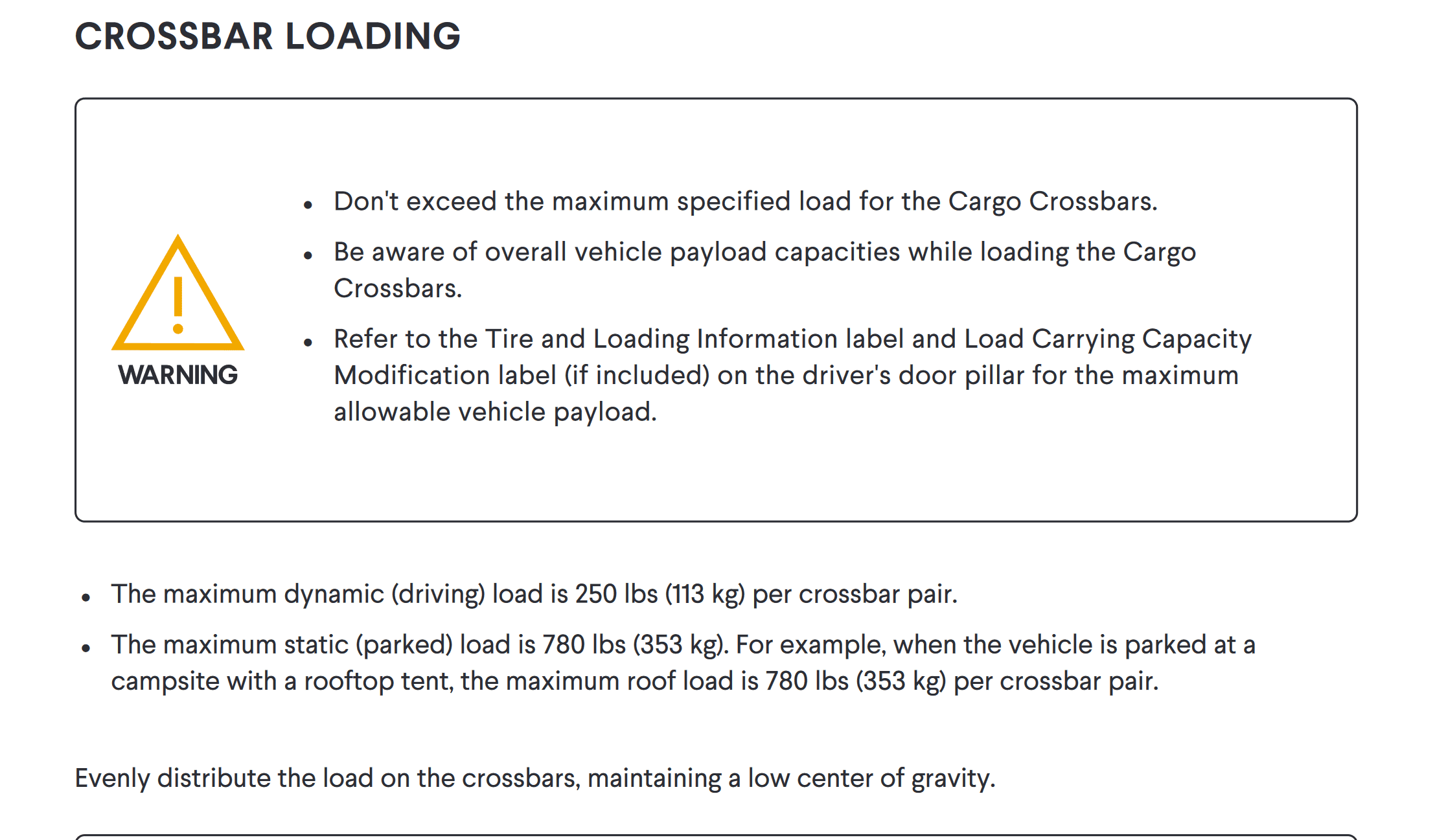

Anyone know the static load bearing rating for the Rivian cross-bars? I believe dynamic is rated at 250lb.
Tent is going to be about 175lbs, I’m another 190, wife is <redacted>, and son is around 80 (at the moment). I have to assume they designed the racks with that type of weight capacity in mind.
It’s got to be sufficient to carry three of us in a RTT, but I’d really like to see hard #s before committing.

I couldn’t find that doc, so thank you!

Interesting that they rate it per pair. I would assume that if you supported a roof top tent on an R1S with all three cross members that it'd be 50% greater. 375# dynamic and 1170# static. That seems really high to me.
