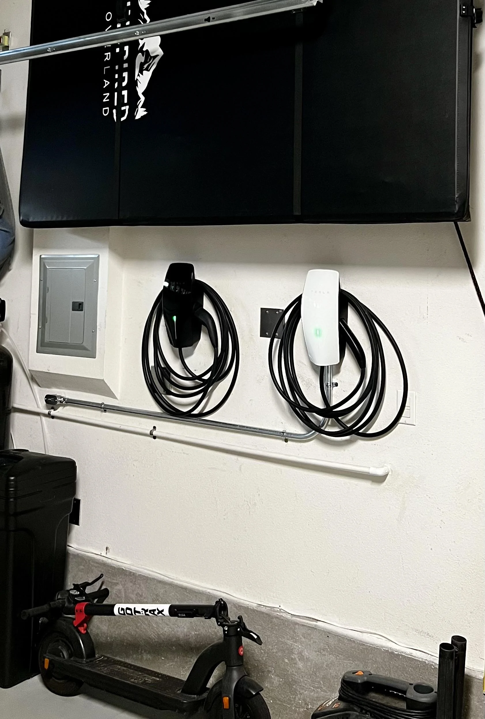

I went with Tesla J1772 unit to match wife’s Tesla NACS charger. Better price than Rivian unit.
Rivian R1T R1S Rivian or another vendor wall charger? IMG_3847
