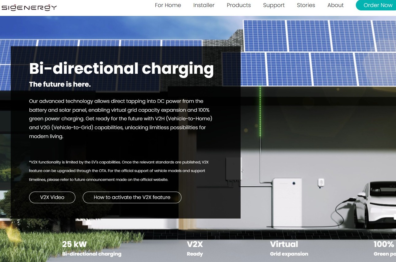

Sigenergy does bi-directional too. Videos on YT working with a Rivian.
[PointGuard Energy (usa) is Now Sigenergy (intl)]
Yes, I saw another thread in this section where someone detailed their use of Signergy with a Rivian R1 as an expansion to their existing solar plus battery system. The Signergy solution works but the standards based solution, formally endorsed by the EV manufacturer, using a meter collar seems to be a better approach to me. The latter seems more flexible as using a meter collar doesn't require either a solar system or a home battery system if all people want is an emergency backup system. But it can be extended to add either or both at a later stage. More companies are getting their meter collar solutions approved by the utilities, as you indicated in your earlier post, probably for this reason amongst others such as a lower cost to implement.
