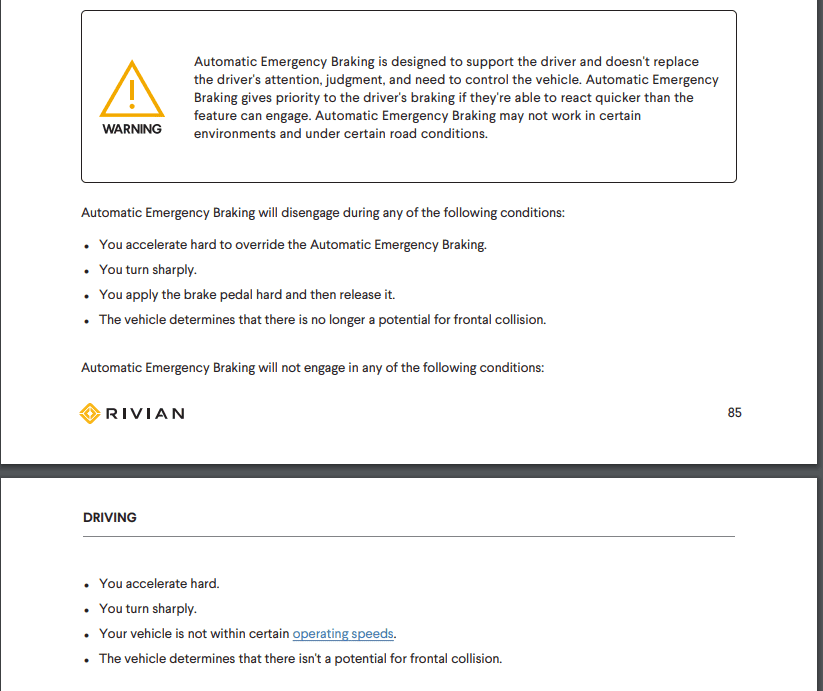

Most emergency braking systems also will be overrided when the driver presses the accelerator. If the driver takes active action the car lets the driver have control.
Yup yup... the driver has to be able to override the support system at a moments notice. Anyone that has had AutoPilot or FSD active on a freeway doing 60-75MPH and then have your Tesla "phantom break" knows this well.
Just because your vehicle has advanced safety and assistance capabilities, does not mean you get to be an inattentive driver (when AP/FSD is active in my Tesla, I always keep one hand on the wheel and a foot near the peddles).
Rivian R1T R1S Rivian R1T first crash ? 1632761895746

This still reads like a Sport Launch or similar with the corner coming up much quicker that the driver anticipated and all attempts to whoa the vehicle were futile at that point. Doesn't matter if was AEB or mashing the brake pedal.
Going too fast into a corner is not something AEB is designed to prevent. By the time the vehicle "saw" the hedge and other obstacles, it was too late.
Driver at that point was likely hard on the brakes and cranking the wheel. Hitting the curb with the wheels at an angle broke the tie rod. Vehicle continued over the grass and thru the hedge striking the parked vehicles. Ooops.
Excessive speed (driver error) is by far the simplest answer to "What happened?"
