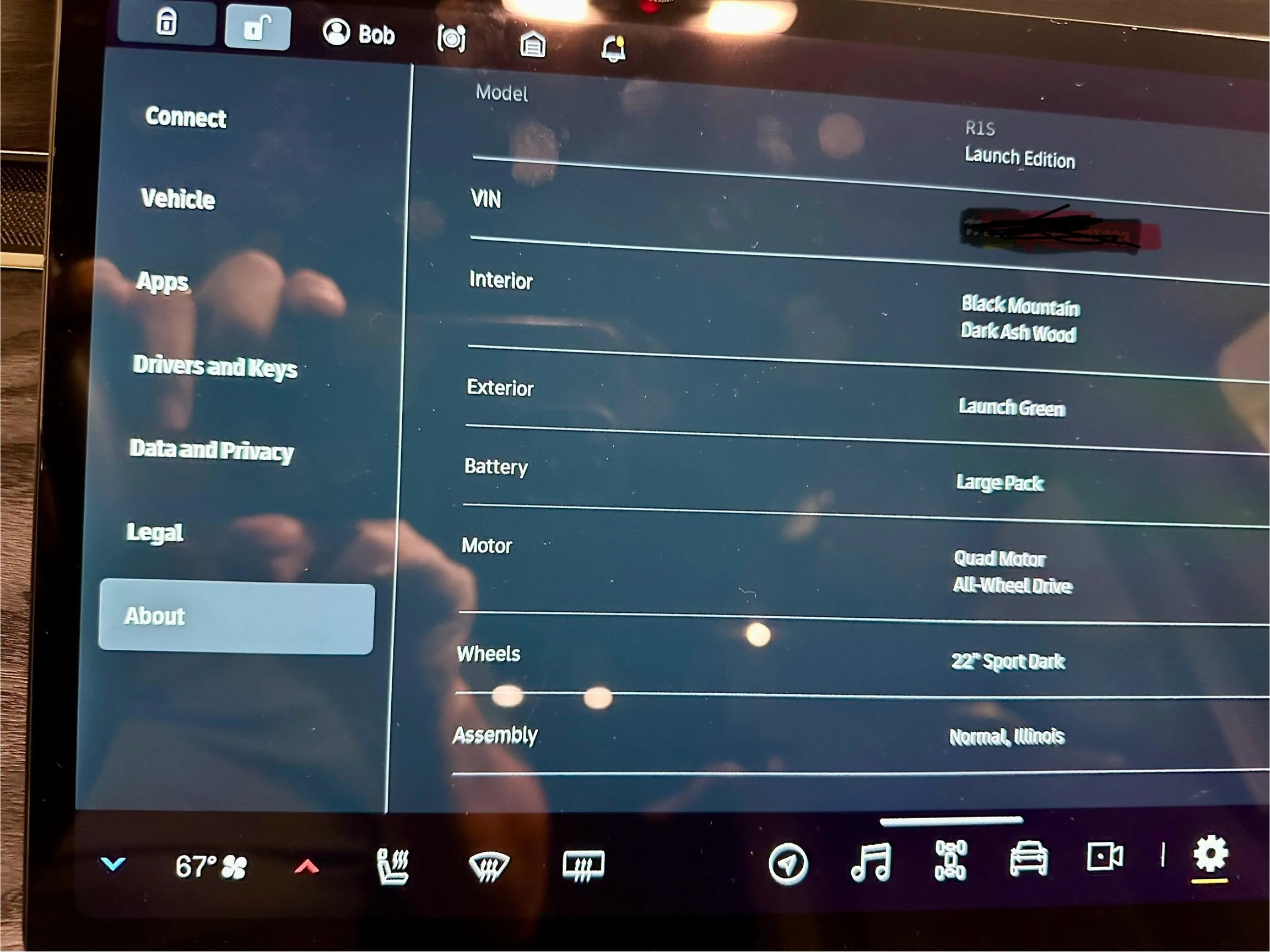

Is there a digit to indicate battery pack size?

Thanks for your reply. I saw that and noted it was posted almost 2 years ago, was wondering if there’s an update yet that includes pack size. Sounds like no update. Appreciate it.

It is in the about screen under settings for reference.

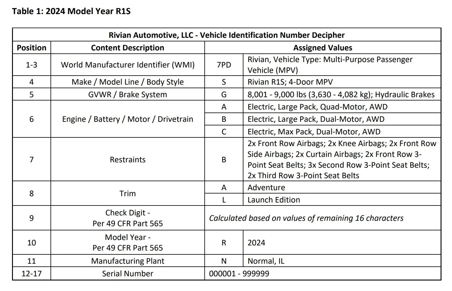

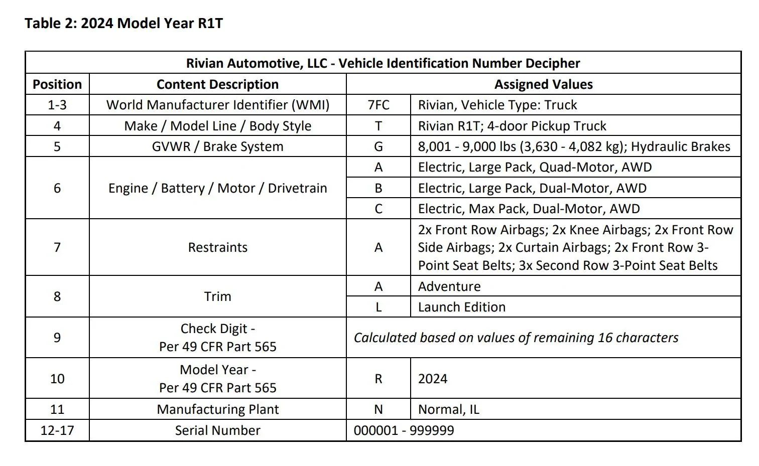

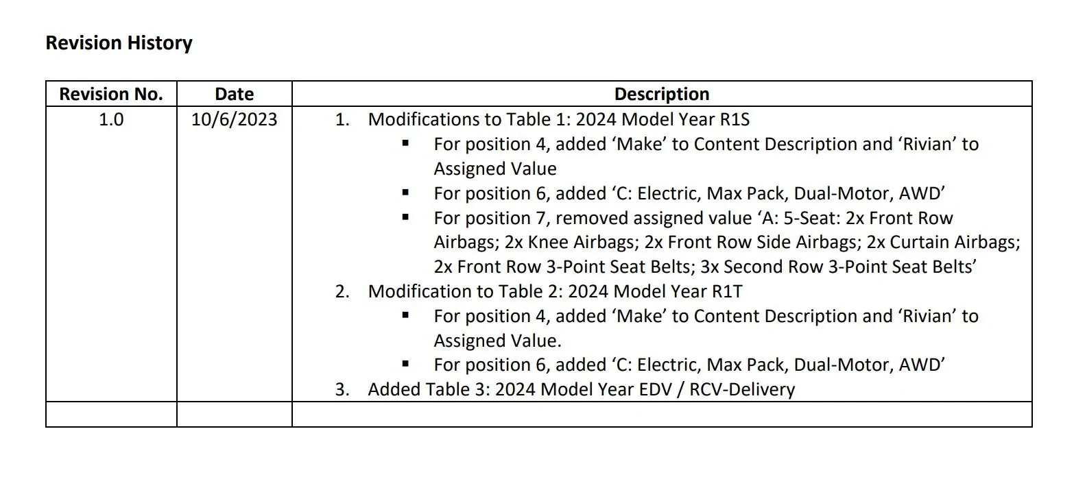

I can help. Alas, your guide is misinformed. On October 6, Rivian sent a letter to NHTSA with details for decoding 2024 model year Rivian vehicles. See link and screenshots below. (And at the very end of this post is a link to the complete 77-page NHTSA document for VIN rules and regulations.)
An R in the 10th VIN position indicates 2024 model year. That's per NHTSA regulations and true for all large-scale auto manufacturers. (By the way, you'll never find any of the letters I, O, or Q in any VIN to avoid possible confusion with the numbers 1 and 0.)
So, the 10th position gives you the definitive answer for model year. Now let's talk about the final 6 digits (known as the VIN serial number). Most manufacturers reset the counter for the last 6 digits when they start a new model year. But that's not a NHTSA requirement, and Rivian obviously chose not to reset the serial number counter to 000001 when they changed the 10th position from P to R.
NHTSA requires that the VIN serial number be assigned "sequentially" for "groups of similar vehicles" within a model year at the point in the manufacturing process where a VIN is assigned to a vehicle. I just took the Rivian factory tour this week, so I know that Rivian assigns (and stamps) the VIN while the floor of the vehicle body is being welded together. I learned from my engineer friends who stayed in the auto industry that "sequential" means that as VINs are assigned in the manufacturing process (for a given model year), each VIN serial number must be higher than the previous one. You can skip forward, but you can't skip back (which rules out assigning VIN serial numbers randomly). By the time finished vehicles pass all quality checks and leave the factory, ready for shipping, the "sequential" order of VIN serial numbers can get shuffled around a bit.
Final note: As you can see below, there is no code for the "standard" battery pack. If production of the standard pack gets started during the 2024 model year, Rivian will need to issue a letter to NHTSA showing the code (6th position in the VIN) for standard pack. Easy-peasy.
