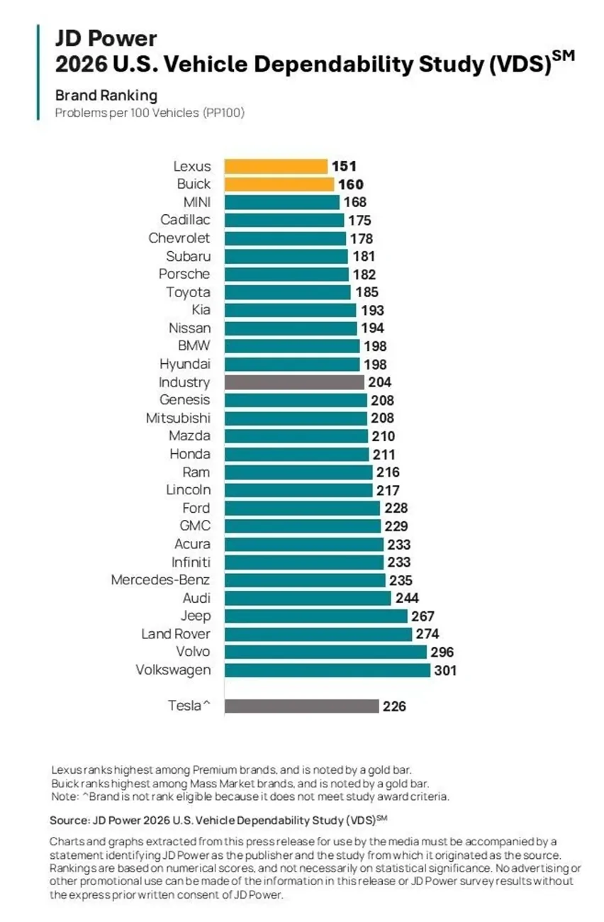

Look at the actual data here from JD Powers.
  • If you have the very best, MOST RELIABLE vehicle brand you can expect an average of 1.51 problems during you first three years of ownership.
  • If you have the very worst, LEAST RELIABLE vehicle brand you can expect an average of 3.01 problems during you first three years of ownership.
A "problem" can be a software glitch or a blown engine. So realistically, the difference between a "low reliability" Land Rover and a "high reliability" Toyota is that you will have ONE extra problem covered by warranty during the first three years you own the vehicle. That is all these surveys tell you. How big a deal that is to you is a matter of personal preference.
Rivian R1T R1S Rivians have poor quality? Screenshot 2026-06-25 at 10.33.54
Side note: Consumer Reports data is misleading garbage manipulated in a secretive non-transparent way to amplify apparent differences. The real data and the weightings are not published except on a pay-to-see basis to OEMS as part of the CR scam. Embarrassing shadow of its former self.

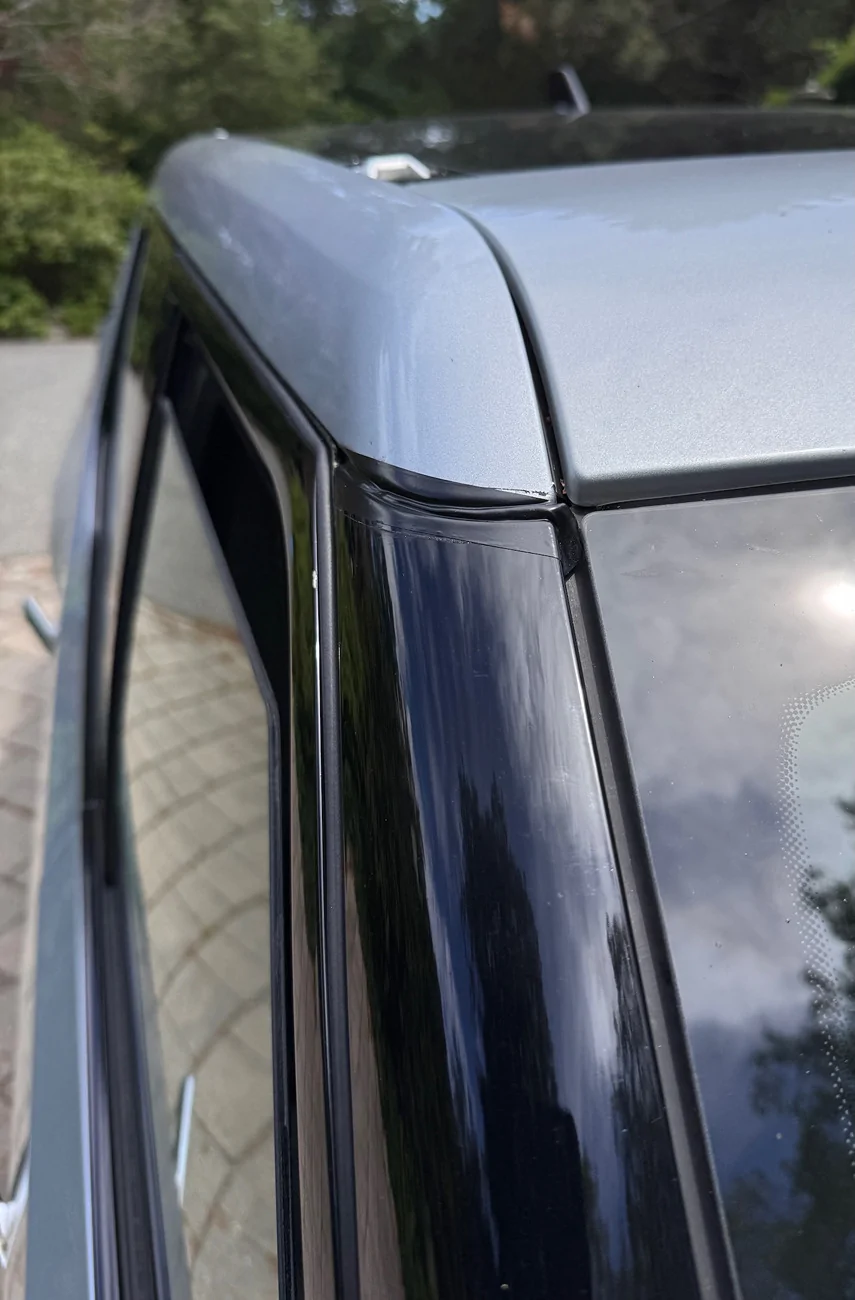

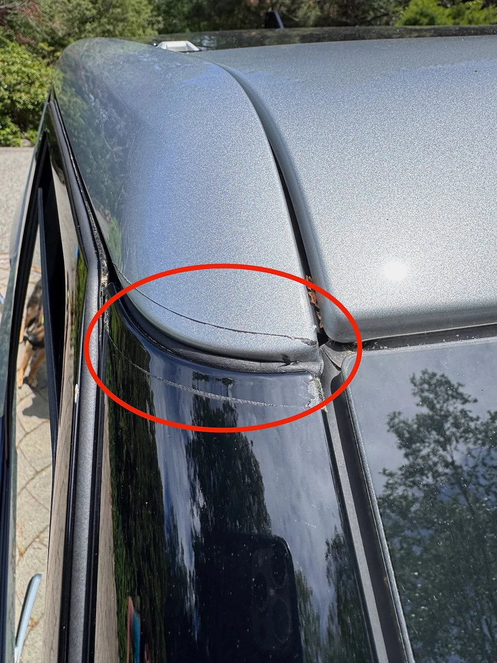

Any pointers on what you did to fix the A-pillar wind noise would be greatly appreciated.
I think it varies by vehicle build. I tried unsuccessfully by adding weather stripping around door frame. I finally saw a post that mentioned the gap at the top of the A-piller and roof. For now, I simply added a bit of filler weather stripping in the gap and a flush piece of electrical tape. The prior sound like a window is cracked open is gone. I should get the SC to fix it more permanently before my warranty goes out.
First photo with weather strip before taping. Second after taping. I don't notice it since it is above eye level.

Appreciate the pointer!
I took a look at mine and this seems like it will help. Do you know what diameter you used?
