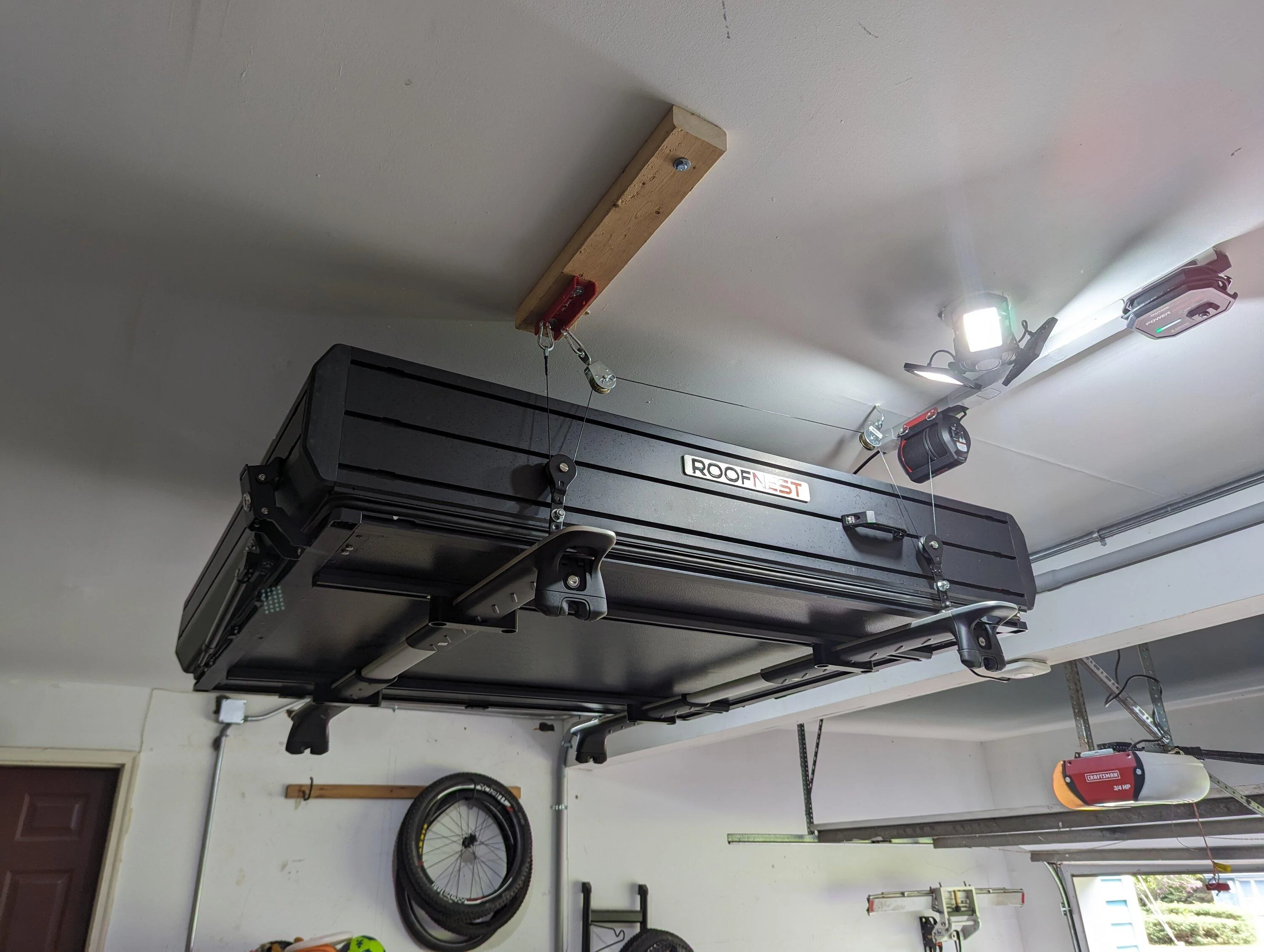

The truck top lifter was really slick but I didn't want to spend that much to store my Condor Overland. I also don't have anything else mounted to the RTT so I was confident that a 200 lb limit would be enough.
My solution was to buy the two lifter Build Your Own kit, two MyLifter Pulley Blocks (the kit already comes with two), and the Truck Top Frame Hardware from Smarterhome. The total cost was around $800 after shipping, so roughly half the cost of the 4 lifter truck top kit. I had to call since their website didn't have the extra pulley blocks or truck top frame hardware for sale.
After buying four more pulleys from the hardware store it works! The only downside is that I have to use my hand to level the RTT as it moves or else it will start to get out of balance. This is because it only raises or lowers on the side directly under the lifter motor. So I have to help the other side stay level as it goes up or down. I'll take it to save $700.
Thanks to @kylealden and others in the thread for sharing their setups.

SmarterHomes packaging/shipping, etc. must have improved. I went with Kyle’s exact same setup to support my RTT. All parts and hardware arrived in one large and one small box with nothing missing. Lots of measuring (and over thinking) on my part before the install, but works like a charm - exactly as Kyle described for his. My 23Zero Armadillo A2 RTT weighs in at about 170 lbs and if I store the ‘annex’ screen room on top I’m pushing 200 lbs, so the 400 lb limit feels comfortable. The phone app shows a on-screen load ‘strain’ gage during lifting that also provides a warm feeling. When the crossbars accidentally re-latched on one side as I started to raise the RTT, I got an overload error message in the app and it halted the lift (just as I noticed my truck bed starting to go up too!). Pricey, yeah, but really nice set up for a guy who has no easy options for help loading/unloading. A 2 min. process now for on/off. Thanks Kyle.

Glad it worked for you! I am definitely extra appreciative of this system right now since I broke my shoulder motorcycling, being able to mount and dismount the tent with one hand is pretty nice :)
