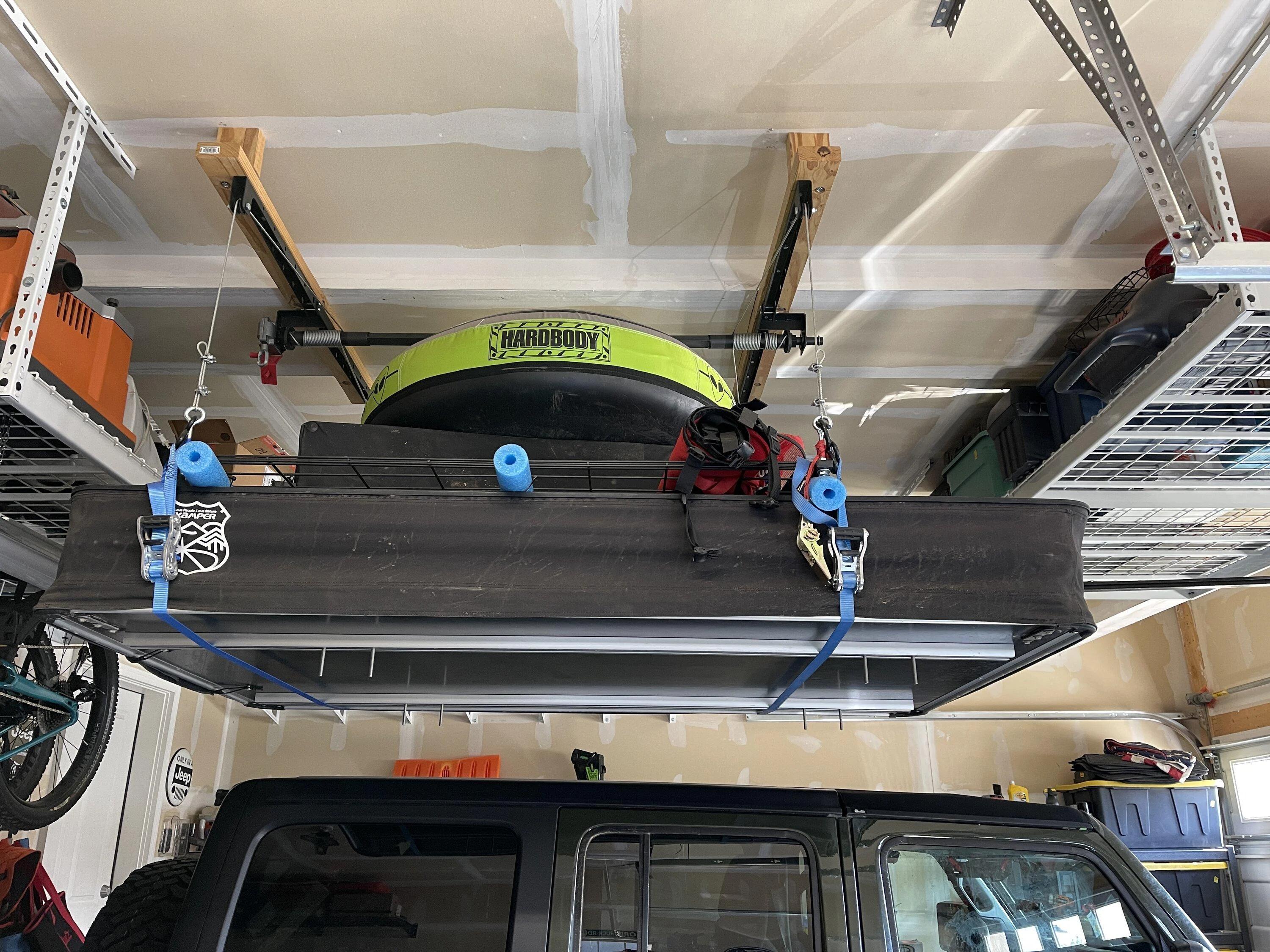

I didn't go DIY but I did buy a manual version
Haven't installed it yet, but will post thoughts when I finally do. If it doesn't work out then, I'll be going this route (although these folks should work on their SEO as I tried multiple searches trying to find a motorized solution that looked good, and this never came up).
Installed this today ave it was a bit of a hassle to get the four ropes at the right length. But i eventually did. The other weirdness is that when the tent is lowered to its final spot there is still a decent amount of tension. this makes disconnecting a bit cumbersome.
All in all the kit is high quality and should handle the tent as well as my other crossbars with my awning and road shower. not as convenient as Kyle's set up but also about $1k cheaper :)

Update: F this piece of S :)
I added my other rack that has an awning and roadshower (7 Gallon). As I was hoisting I heard a couple of ominous "twangs" and the load shifted. There is no way I trust it to not drop my tent through my windshield. Not to mention the 8:1 pull ratio makes it easier to hoist, but it's not easy and takes quite a bit of time.
I'm uninstalling it tomorrow and have ordered the same system as Kyle.

Thanks for the suggestion, but the joists are normal wood joists. I think the twang was the straps adjusting under the tent and maybe one of the pulleys adjusting itself on the eye bolt. The system would probably be fine in the long run, but the goal was to make it super simple to get the tent off and on the truck, and it's not that - it's easier than moving it by hand, but short of what I'm looking for.

With the crossbars attached and the tent raised as far as it will go, how far down from the ceiling is the lowest point? I have a high ceiling in my garage and I’m curious if this will fit above my raised garage door or if I have to mount it further back behind where the door rolls up. I plan of copying your awesome setup either way. Thanks!
Almost exactly 24”, but I have room for crossbars on top of the tent. You should be able to shave another 4-6 inches off, give or take.
